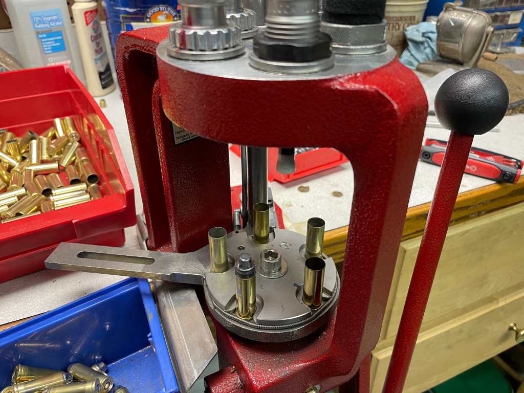

Went to the range yesterday and brought out my Marlin 1894 Cowboy and Ruger NM Blackhawk in 45 Colt. The Ruger is the convertible model so I drought along the 45 ACP cylinder to compare some 200 gr semi wadcutters to my new 45 Colt load.
The new 45 Colt load is a 185 gr. semi wadcutter (soft lead) with 8.8 gr. of Universal loaded to 1.540". I started out shooting this load in the Marlin at 50 yard and boy was it smack on. Very light recoil and with just an elbow on the bench I was getting 4" or less groups. Then I switched over to the Ruger and fired 10 rounds of the 45 ACP 200 gr. load. Nice shooting at 15 yds. and medium felt recoil. I switched to the 45 Colt 185 gr. load and was even more impressed. Recoil was much lighter and really a pleasure to shoot.
I had to factory grips on the Ruger which don't fit my big hands very well. With my usual 45 Colt load (250 gr RNFP with 7.2 gr. Universal at 1.260" COL) the trigger guard will smack me in my middle finger knuckle. After a few cylinders of those, that knuckle gets sore. The 185 gr load was perfect. No smack on the knuckle, so I'm a vert happy camper. I now a a 45 Colt load that shoots we in the Marlin and doesn't beat me up in the Ruger.
So today at the loading bench I put together another 200 rounds of the 45 Colt 185 gr. loads.
Here is the load coming off my press:
This is a side-by-side of the two loads. On the left is the new 185 gr. load compared to the 250 gr. MB RNFP, on the right.
When I finish up the 250 gr. MB RNFP I have in stock, I will be ordering some 185 gr. MB bullets.

Nice ! I like your Hornady Progressive.
I have the same BH 45 convertible and also have cave man hands with the same issue. I swapped out the factory grips for Hogue Monogrip Grips. They work well for me.
I have the same Hogue grips. I just don't like the look They are very comfortable and stop the bruised knuckle, The traditional small grips are cosmetically just better. I switch them out depending on my mood.
