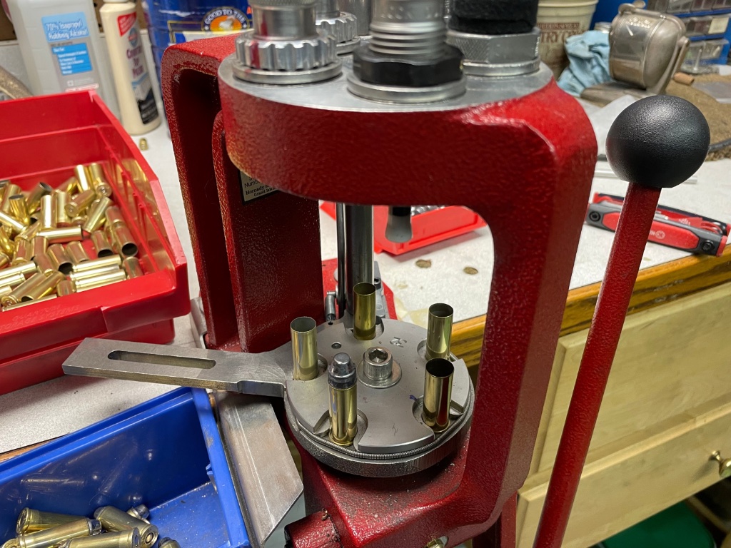

Here is the load coming off my press:

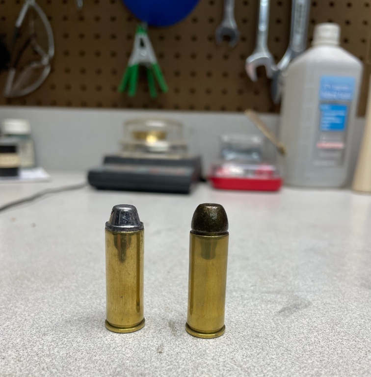

This is a side-by-side of the two loads. On the left is the new 185 gr. load compared to the 250 gr. MB RNFP, on the right.
When I finish up the 250 gr. MB RNFP I have in stock, I will be ordering some 185 gr. MB bullets.
