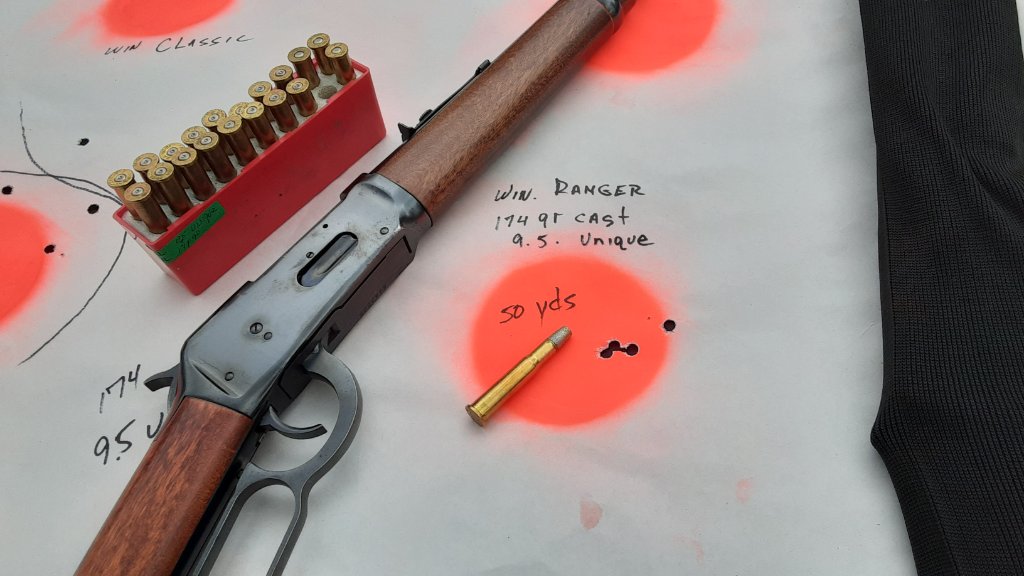

Never tried the cfe pistol in any rifle calibers before.
Now 9.5 grs of unique over a 174 gr cast works really well in one of the Winchesters.

Nice group at 50 Swearengen . . . ah, Vaquero !
Yeah, I noticed that too! :lol:
