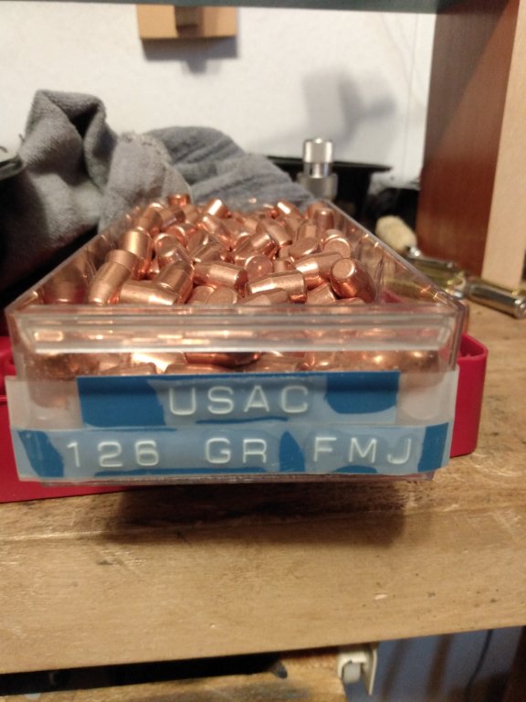

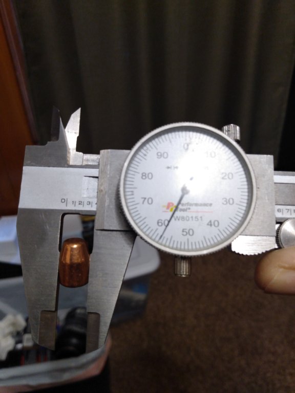

Our pest control guy gave me about 200 of these, they were his late fathers and doesn't know what caliber. They scaled at 126gr with a diameter of .357 and flat nose profile .. I've never loaded a 38/357 bullet without a cannelure.

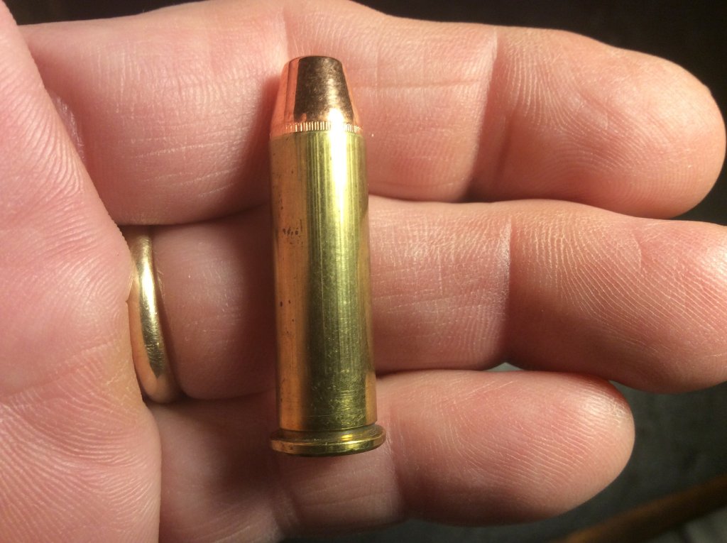

Just load them like you would a .45 ACP round by using very light crimp to about .376 dia. at case mouth if case measures .377 O.D.
If you can find a similar style weight bullet in a reloading manual you could seat bullet to that COL.
This is one of my .38 Special loads using a plated Xtreme 125 gr. bullet . That is just a knurled area that gives you a idea of where to seat bullet and not a groove.

They're plated but I'm a bit Leary of bullet retention without a cannelure...does this mean I need a Henry 357 single shot ? 😯

No problem loading them for 38 Spl loads. Just follow the standard load data for the powder you're using. Instead of trying to crimp the round, you want to just remove the flair put in the case by the expander die. If you try to roll crimp, like you do with a cannelure, you will bulge the case and the round won't chamber. Go with what Forty said and .377 OD at the case mouth.

Just like the others have said load them and crimp them just like you would if they had the crimp groove. They will work fine.

RCBS does make taper crimp dies for revolver cartridges which would work great for that bullet but at $30 probably not a great investment unless you have more than in shown in the pic.
