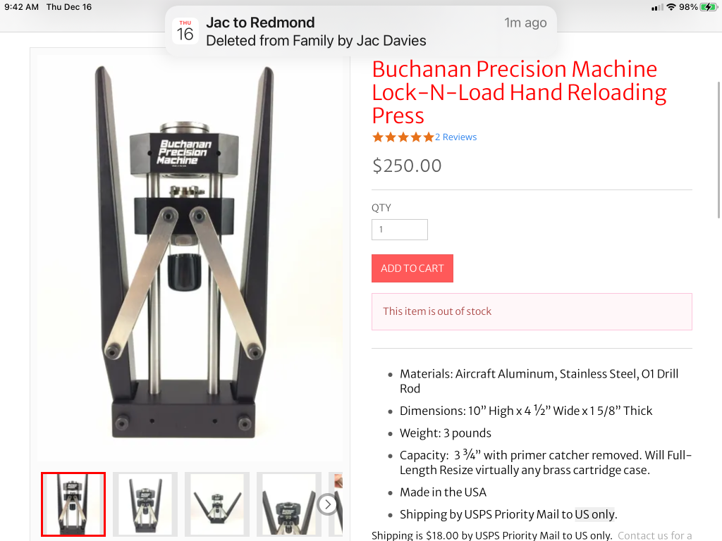

I have used both, the Lee Loader was my first ever tool and I quickly found that it was so very limited. But if all you need is for a few rounds to go Bang, it will work.
I bought the Buchanon press last year, it is truly a thing of great beauty, and very satisfying to own and use. I love the Lock N Load bushings, they allow quick changes of the various dies without having to thread them in and out twenty turns. I carry this press, a digital scale, a hand priming tool and a small assortment of bullets, primers and powders when traveling, it works great for small quantities. Not so much for hundreds of 9 mm rounds for range blasting. I only use it to load .327 Federal Mag and ..44 Mag. All other calibers get loaded at home on a RCBS Rock Chucker single stage press.
The Buchanon press operates completely differently from any other press, you hold it in front of your chest and press your hands toward each other, like praying very hard. If you have weak muscles like me, that will tire them out quickly and your chest can get sore.
