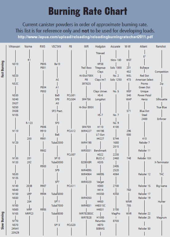

Re: Hand Gun Data Used for Rifle
Here’s a good chart to help identify the slower burning powders
