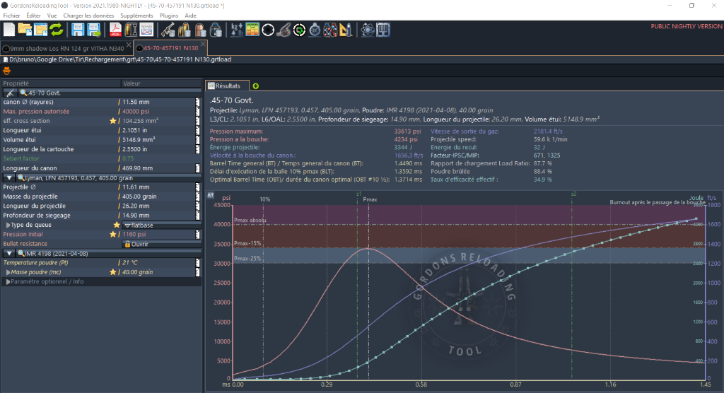

previously , i use imr 4198 and lyman cast bullet 405 grain.
36.5 to 40.5 grain indicated by Lyman book, i have tested 40 without any problem in my marlin SBL 45-70
with GRT (gordon reloading tool) 40 seems perfect
- imr 4198 405 grain bullet.png (277.06 KiB) Viewed 1621 times
Now, IMR 4198 is impossible to find in France, so i use VITHA N130 ....
bruno

GRT software looks nice, I have QuickLoad and I've been playing with different powder charges
I was able to find four pounds of IMR 4198 recently but it's hard to find powder in the US
Like I said b4 I'm gonna start low and work up the optimal load
