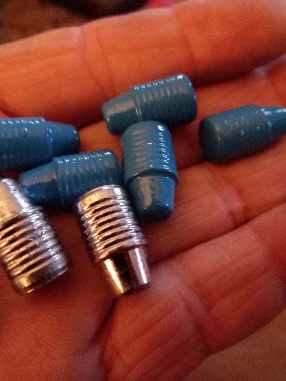

Post by Johnnyjr » Thu Nov 11, 2021 4:21 pm
Tried powder coating today with Lee 240 grain tumble bullets. Only did 25 to start with. Eastwood Ford blue..

Post by Johnnyjr » Thu Nov 11, 2021 4:23 pm

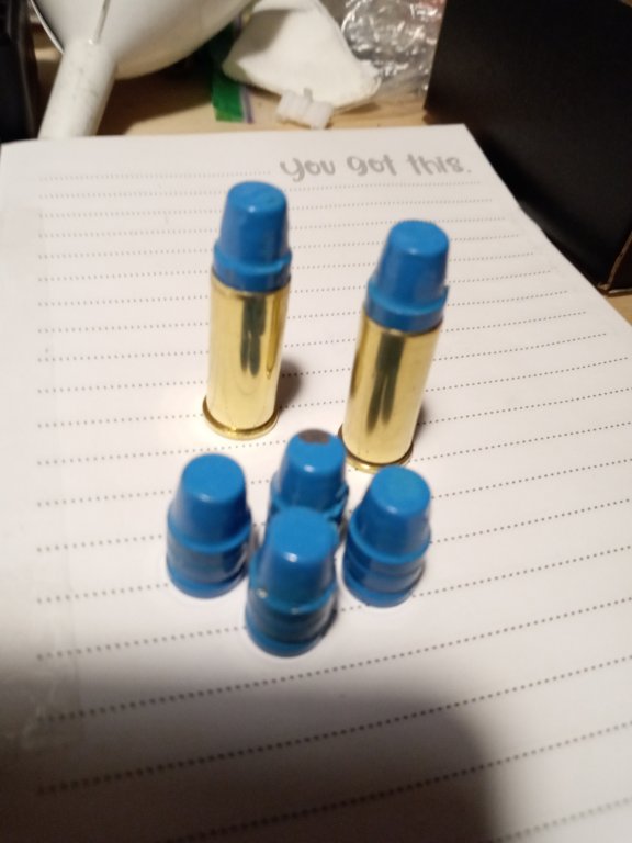

Post by Johnnyjr » Sun Nov 14, 2021 4:57 pm
ImageDone a few 245 gr today.

Nice looking loads. I hope they perform as well as they look.

Looks good Johnny, lets us know hownthey work.
I'm guessing no problems.
What's your OAL with those pictured? Really can't tell from the angle, but, they look like they're seated long. Could just be the picture.
