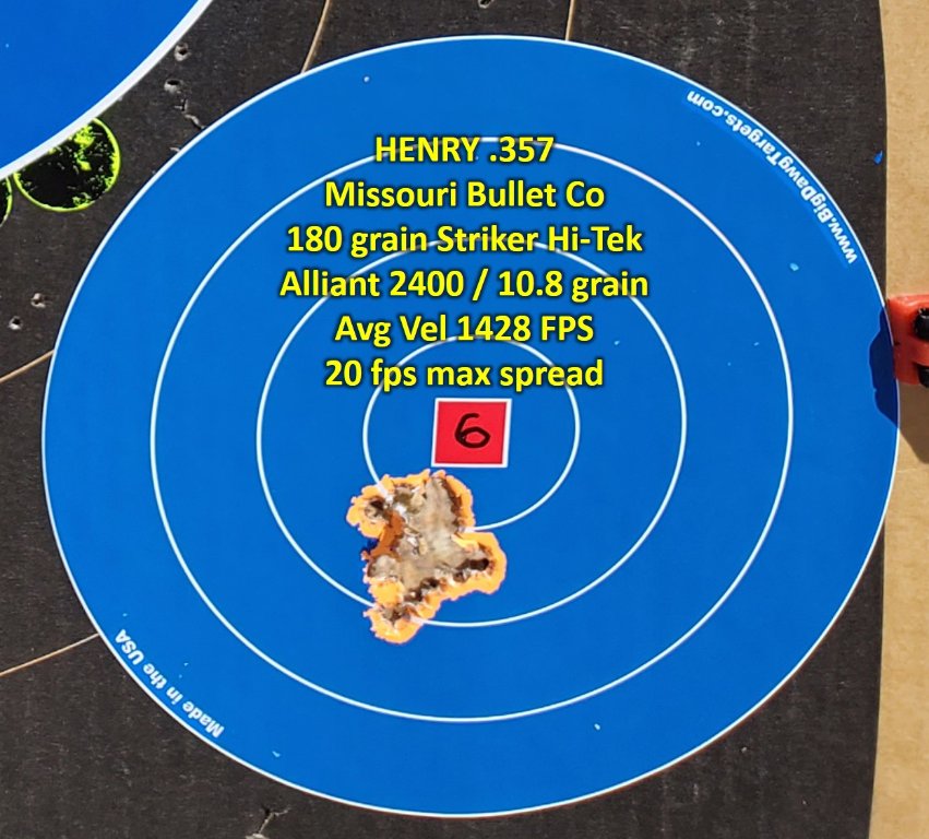

I have had great luck with 2400 for the Henry and Bullseye for the .357.
For the Henry with 180 grn MB, I drop 10.8 grains. It prints well and averages 1428 fps. This has been my best formula for the Henry.
String #6.jpg (117.08 KiB) Viewed 1473 times
12 round string at 100 yards, bench rest, iron sights.

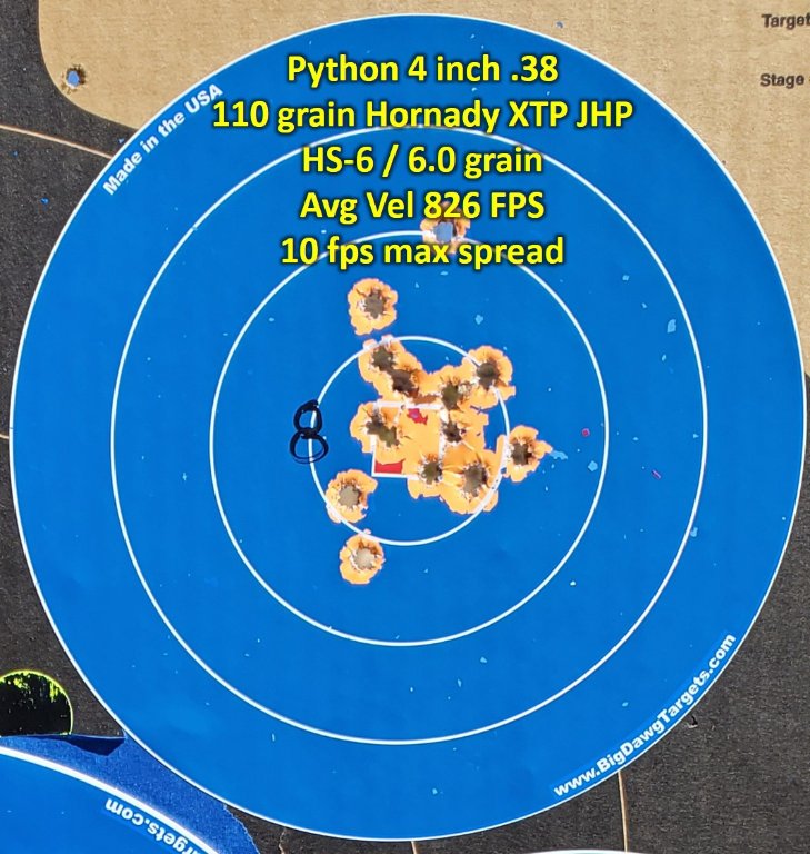

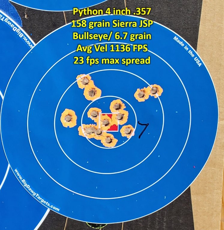

For the Python and Blackhawk I am shooting Hornady XTP at 158 grains, my favorite weight, or 110 grains for plinking. In both cases I have the best printing with Bullseye.
String 07.jpg (111.95 KiB) Viewed 1473 times
158 grain out of the 4 inch python, off hand position at 40 yards.
String 08.jpg (116.19 KiB) Viewed 1473 times
110 grain out of the snake, same distance and position

RNG...looks like you have that caliber nailed down!

Well, after looking at my old targets and looking at r-n-g's and getting opinions here, I'll stick with the 2400/180 load. And save my Universal for the 158's and my 1911-A1.
