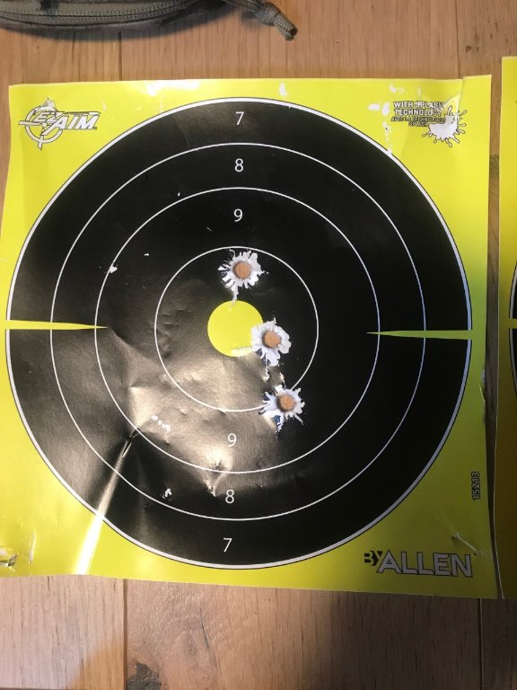

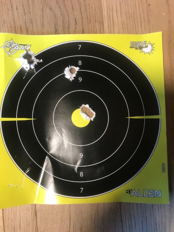

I was just out at the range today shooting off of a sandbag. These are targets that I shot with my Marlin 1895 with 300 grain hollow points in front of 48 grains of 3031.
The first target was at 50 yards, the first two shots were in the upper left corner to see where my scope was at. The third shot was after my first scope adjustment. And the three shots with the ragged hole was after my scope was squared away. The second target was three shots at 100 yards. I think that the spread has more to do with my 53 year old wobble than the rifle or the load, :lol: still pretty good though. It is a good deer load and pleasant to shoot. I get similar results with 44 grains of H4198. Both loads shoot about the same out of my Henry too.

Greyhawk, that's some pretty shooting. Have you tried the 3031 load at 100 yards yet? It looks good.
Yep... The target in the second picture is the 100 yard target with 48 grains of 3031
