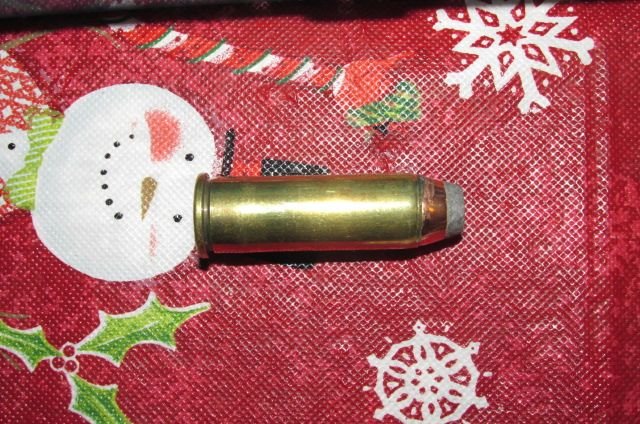

all I can say is ours has literally fired well over 10,000 rounds like the one below .... never have trimmed a case and crimp in the ring on Nosler's 240 gr JHP's

Johnnyjr
Posts: 181
Joined: Sat May 29, 2021 2:13 pm
Location: Towanda,pa
Re: 44 mag/44 special loads
Post by Johnnyjr » Fri Jun 11, 2021 7:49 pm
But that's a jacket bullet. I'm talking about cast bullets.

Post by JEBar » Fri Jun 11, 2021 9:35 pm
correct ... its my understanding that the length of the bullet sticking out of the casing is supposed to be the same
Johnnyjr
Posts: 181
Post by Johnnyjr » Sat Jun 12, 2021 8:23 am
What is the oal of that bullet combination.. thanks
