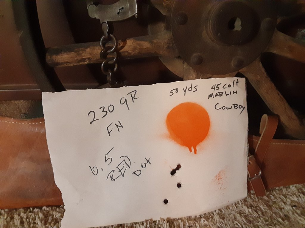

If you come across Alliant Red Dot it is very accurate with 45 Colt revolver use and cast bullets. 6 grs is all you need for 200-255 gr. bullet and within standard pressures

Post by BigAl52 » Sat Jan 09, 2021 4:28 pm
Ditto what Forty said I have used Red Dot with success in 45 Colt and other pistola calibers

Yes I'll agree on the Unique and Red dot as good 45 colt powders.

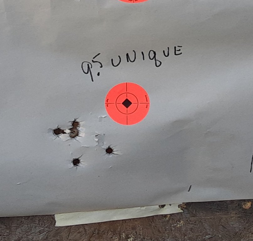

Off the back porch not long ago. ;) Al...
They hit about like the Unique load.
From a previous outing.

Re: Thoughts on powder
Post by Vaquero » Sat Jan 09, 2021 6:25 pm
I have since then adjusted the sights. :lol:
I need to try those in my Rossi.
Good luck on the powder RR.

Post by fortyshooter » Sat Jan 09, 2021 6:49 pm
Wow that is about the same group but in different location!

Post by Vaquero » Sat Jan 09, 2021 7:18 pm
Right but, the Unique load is with a 250 grainer.
