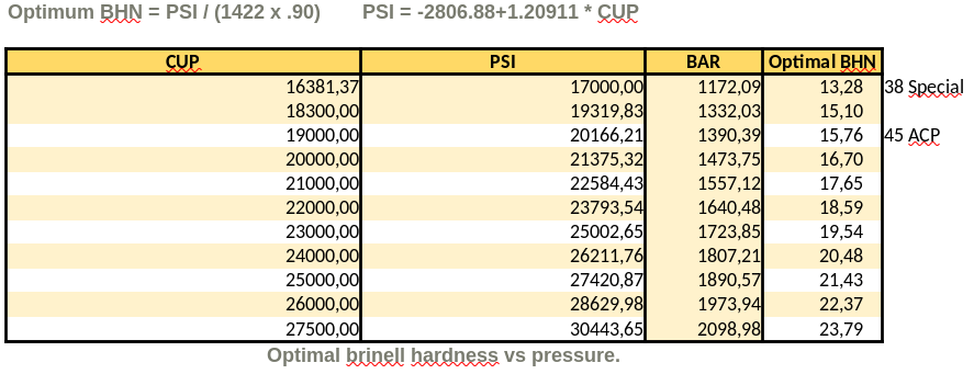

i dont cast 44 magnum bullet, but 38, 357 , 45-70 gvt.
Last year i have found an interesting formula to calculate bhn hardness , from pressure :
Capture d’écran de 2020-11-17 18-13-49.png (61.45 KiB) Viewed 2233 times
But for 45-70, (28 000 PSI Max) bhn 19 -20 is more than enough.
therefore this diagram is perfect for low pressure , but cannot be followed exactly for high pressure.
Pressure of a 44 magnum is near 36 000 Psi, so alloy must be very hard to resist.
as fortyshooter say, 20+ BHN seems to be enough.

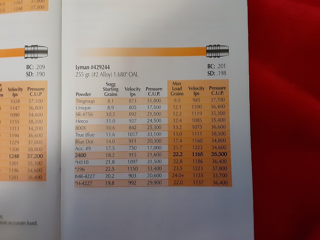

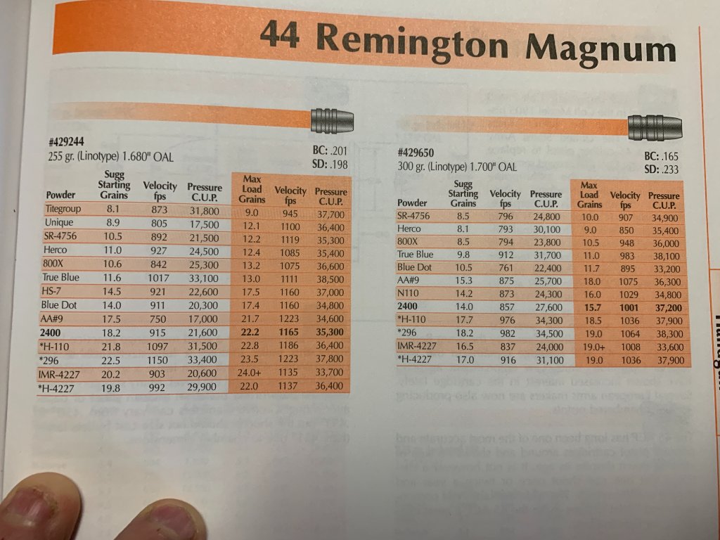

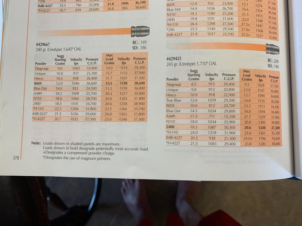

9 to 10 grains of unique should be in the ball park. I went and got my Lyman 49th manual. Here is some pics from that manual. Maybe that will help.

9 to 10 gr. is a nice mid level shooting load for .44 Magnum. Alliant 2400 is another well recommended load that works well with .44 Mag and use standard type primers to get to the higher levels of Magnum performance.
Do you have a load manual like Lyman or Speer?

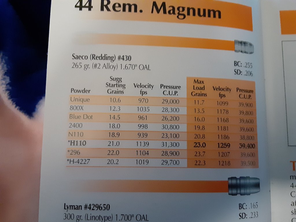

PJM, I found data for 255, and 265.
Maybe this will help a little.

Post by BigAl52 » Fri Dec 04, 2020 11:46 am
Sent some similar to that Randy but those look good. But Im bettin 10.0 grains of unique will do great
