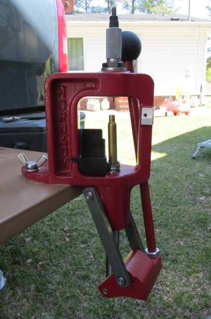

per Hannibal, "I love it when a plan comes together !" .... as can be seen, it can accommodate both the press and RCBS Chargemaster ===> https://www.amazon.com/RCBS-98923-Charg ... 157&sr=8-3 .... time will tell if I keep it on the stand or on a TV tray beside where we are setup .... only remaining issue is there is plenty of wobble from the loose fit of the hitch in the receiver .... my hope is the Hitch Tightener ===> https://www.amazon.com/gp/product/B07B9 ... UTF8&psc=1 we have on order will take care of the wobble .... if not, I'll go with a heavier duty one

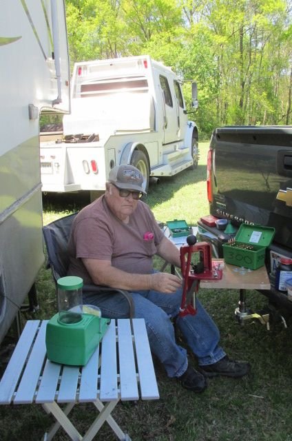

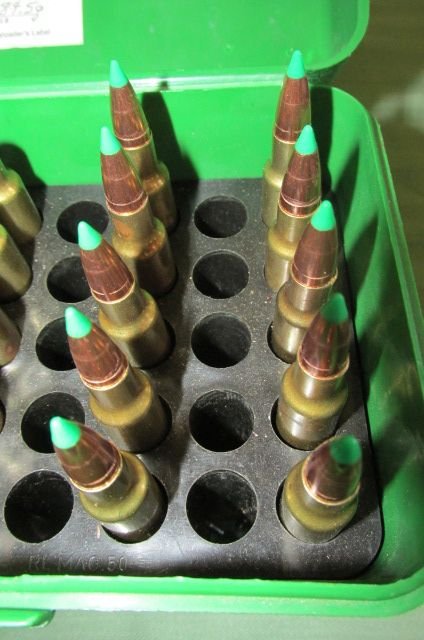

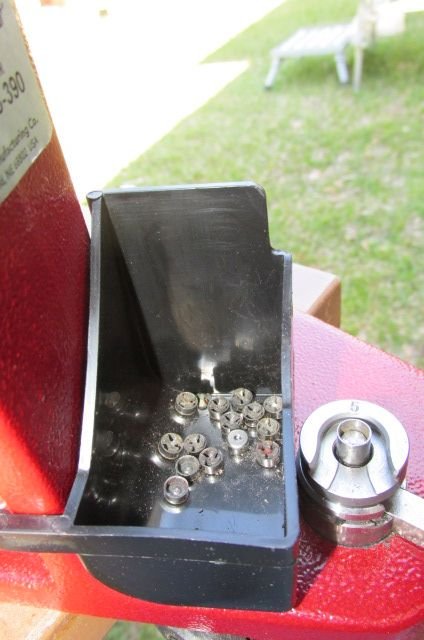

first loads with our portable setup .... fitting the 300 WBY RCBS dies to Hornady's Lock-n-Load wasn't difficult but did take a bit of time .... 300 WBY brass is tough and requires a good bit of effort to resize .... I used some wooden wedges to take up the space between the hitch and the receiver's walls .... doing so helped but didn't fully stabilize stand .... as mentioned above, the Hitch Tightener is clearly a necessity .... all that being said, resizing the brass with the Hornady press was pretty much the same as doing so with our Rock Cruncher .... primer seating with the Hornady is different and took a bit of getting used to .... the spent primer catcher of the Classic works better than the one on our RCBS .... that's neither good nor bad, just the way it is .... when it comes to seating the bullet, no difference between the presses .... I decided to put together 10 rounds .... the 5 with the red primer were loaded with 84.5 grains of IMR7828 that was saved when I pulled the bullets to get rid of the nickle coated brass .... the other 5 are loaded with the same amount of new 7828 .... all bullets are Nosler 30 cal 180 gr Ballistic Tips that were first loaded in the nickle brass .... a ring where the bullet puller grabbed onto them can be seen .... my plan is to run these ten through our Chrony to see if the older powder has lost any of its Zip .... if it hasn't, I'll simply mix it in with the new powder .... I also want to make sure they cycle smoothly through our rifle .... once the testing is over, I plan to load 25 to 50 to have on hand
