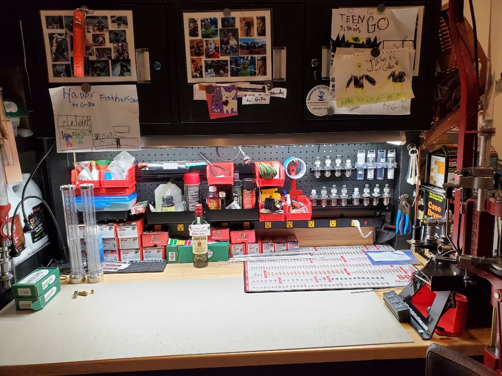

So first thing I did is clean my bench and get everything back in place.

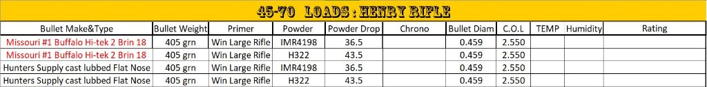

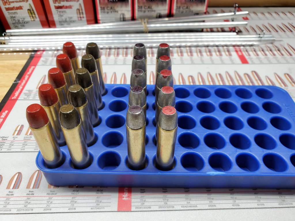

Finally, I was able to load up four versions of 45-70 I want to test/ chrono
The below load data is for the rounds in the block from left to right
45-7- loads.JPG (52.87 KiB) Viewed 1794 times

looking forward to seeing the results of your chrony test .... what muzzle velocity are you looking for ... :?:

Good looking setup there.

Looks well stocked the RG. Those 70's look like they might produce some shoulder massaging to.

I will let you know JEBar. Probably be a week or so before I can break lose, but I will post the results.
RR - You are very kind, however I will be happy to trade my set up for your back porch and view ALL DAY LONG ! ! !. I love the desert, but I have to say, you are smack dab in some beautiful gods country !
Now back to business. Readers Digest version around 1500 to 1550 FPS. The Chief bought me my Henry 45-70 side gate for Xmas. I have put factory rounds down range but it took this long to get all of the components - dies, brass and bullet research to get to my first loads.
This is the first of many variations and I am anxious to see how they preform. The Missouri Hi Tek rounds were recommend to me on the forum, and I have to say I am looking forward to see how they preform.
Right now I am at around 99-100 degrees, 15% humidity, weather is clear and beautiful.
