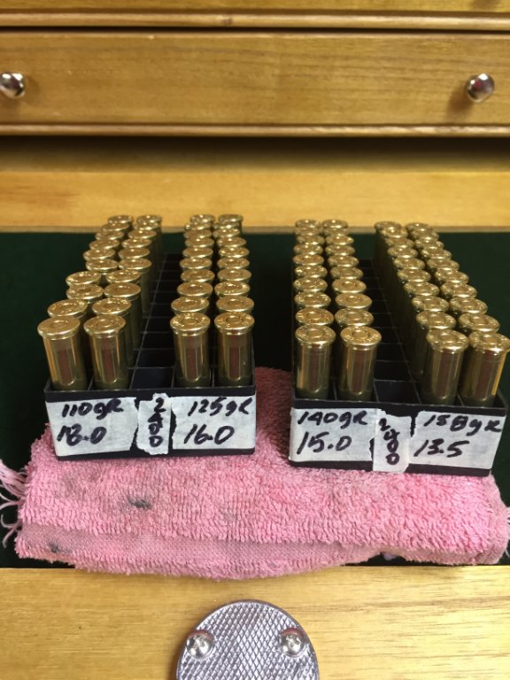

Here's what I'm working with. Couldn't remember the exact powder loads, but I'd labeled them, so here's a pic.
110 gr XTP/18.0 gr 2400
125 gr XTP/16.0 gr 2400
140 gr XTP/15.0 gr 2400
158 gr XTP/13.5 gr 2400
There's no algorithm that got me to those powder loads, just combined lots of inputs and adjusted to put each one in the middle range of what the Lyman Manual (Rifle Section) had for 2400 at each of those projectile weights (with some rounding to x.0 or x.5).
Since I have 20 rds of each, I'll set up two targets, both with 10 rounds of each of those, plus 10 rounds of Fiocchi 142 gr factory as a "control" group, since each target displays basically 5 different targets on the same sheet.
