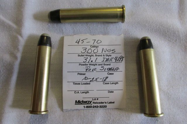

after a great deal of research and pondering what has been read, I've decided to deviate from my firmly ingrained practice of loading our practice ammo to the same specs/standards of our hunting ammo .... the fact of the matter is, even after some highly effective mods designed to reduce felt recoil, our Henry 45-70 isn't fun to fire when using full power hunting loads .... consequently, it stays in the safe most of the time .... early on we found we did enjoy firing HSM Cowboy Action loads .... in reading various sources, it is reported to be acceptable to fire "trapdoor" level loads in our Henry .... we have decided to use 300 gr Nosler Ballistic Silvertips for both our hunting and practice ammo a search for a practice .... as a contrast :
our Hunting Load uses 51.5 gr of IMR 4198 which yields a muzzle velocity +/- 2,225 fps
fps
the corresponding minimum 45-70 Government load (per Nosler) is 47.5 gr of IMR 4198 yielding a muzzle velocity of +/- 2,022
our first attempt to find a trapdoor level practice load (shown below) loaded with 31.1 gr of IMR 4195 which, per Sierra, should yield a muzzle velocity of +/- 1,450 fps
per our ballistics program, the bullet trajectory of this load should be
-0.2" @ 25 yards, Zeroed @ 50 yards, -1.1" at 75 yards, and -3.3" @ 100 yards
OR
+07" @ 25 yards, +1.8" @ 50 yards, +1.6" at 75 yards, and Zeroed @ 100 yards
either of those should be fine for punching paper and ringing gongs .... my hope is this significant reduction in muzzle velocity there should be a corresponding reduction in felt recoil

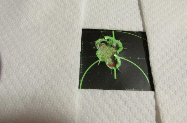

earlier today I was able to test our next generation of 45-70 range loads .... 44 gr of IMR 4198 pushing a 300 gr Nosler/Winchester Combined Technologies Ballistic Silvertip .... the results are the best so far .... felt recoil notifiable but not harsh, I'd rate it as being in the ball park with 20 ga semi auto firing sheet shells .... average muzzle velocity 1745 fps .... per our ballistics program :
0 yds -1.5"
25 yds 0.1"
50 yds 1.0"
75 yds 1.0"
100 yds -0.0"
125 yds -2.1"
150 yds -5.3"
group shown below is from 7 rounds at 25 yards .... rest of target is covered because it contains holes from 44, 357, and 22 caliber rifles as well .... next step will be to load 50 rounds for group testing at 50, 75, and 100 yards .... if they group well with the trajectory shown above, at 100 yards, I believe we will have found our range load
