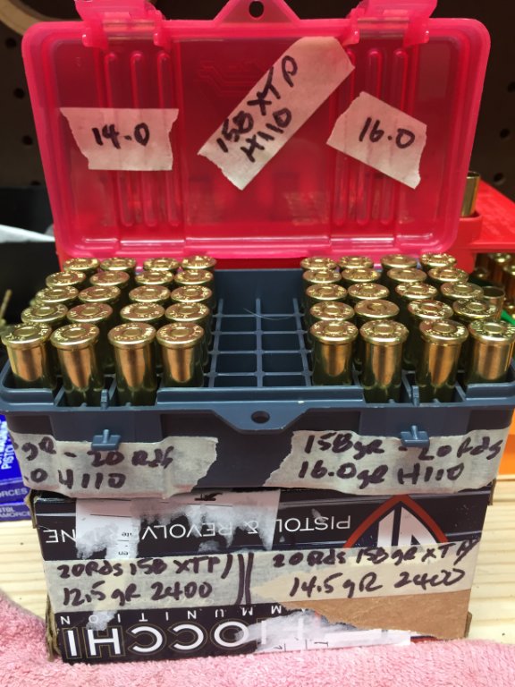

Here's what I'll be shooting. 20 rounds of each variable, so 10 round groups, shot twice. Will likely devise an inverted triangle on a mini-paper plate, just for fun. All 158 gr XTP, 50 yds, bagged, 1.5-4X20 Leo VX Freedom, @ 4X. Pink box-top.
Alliant 2400
12.5 gr
14.5 gr
H110
14.0 (Sorry, Stan, had to round up)
16.0 (Lyman manual has max @ 17.3, as I recall)
Range day will likely be Monday.
EDITED to replace PHOTO with a more acceptable version.
Alliant 2400
12.5 gr
14.5 gr
H110
- 2-9-19 Range trip 45 Uberti 1st Outing 005.JPG (123.63 KiB) Viewed 3688 times

ESquared wrote:Here's what I'll be shooting. 20 rounds of each variable, so 10 round groups, shot twice. Will likely devise an inverted triangle on a mini-paper plate, just for fun. All 158 gr XTP, 50 yds, bagged, 1.5-4X20 Leo VX Freedom, @ 4X. Pink box-top.
Alliant 2400
12.5 gr
14.5 gr
H110
Im really disappointed those aren't displayed on the pink loading room towels.
Re: Your most accurate .357 reloads
ya what is with that? where is your cloth, rag or towel in pink?
BigAl52 wrote:Im really disappointed those aren't displayed on the pink loading room towels.
ESquared wrote:... Pink box-top.
Sorry, a major miss on my part. It was laying right there, I swear! I tried to fudge it a bit with the pink top to the ammo box, but, clearly, no dice!
we cut you no slack. stick with the program
ESquared wrote:Sorry, a major miss on my part. It was laying right there, I swear! I tried to fudge it a bit with the pink top to the ammo box, but, clearly, no dice!
Tough crowd!
Can't wait to see the result of those loads. And you best have the pink towel in there.
You're doing good on load development Evan. Have fun.
Defective photo replaced. See previous page.
ESquared wrote:Defective photo replaced. See previous page.
