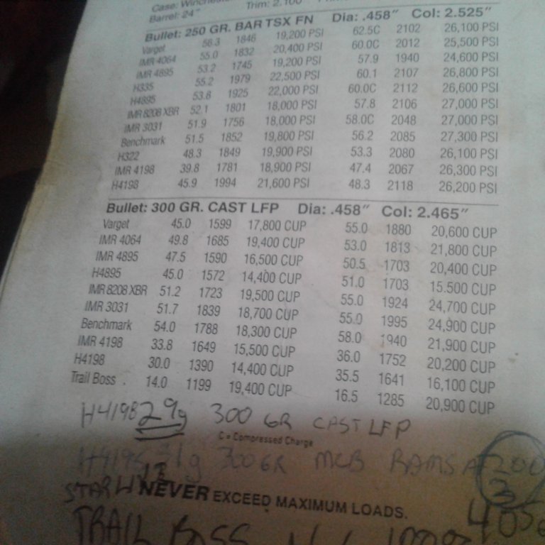

Post by Ojaileveraction » Tue Mar 10, 2020 10:34 pm
What I got.

16gr of universal and a Berrys plated 350gr makes a really nice shootin 45-70 load and its been very accurate for me in the AW-45-70

I've gotten my best longer range 150-200+ yrd accuracy in 350 and 405 grain cast lead bullets.
Not so much with 300 grain. Fun up close 100 yrds little wild past that.

for our 45-70 I load 300 gr Nosler Ballistic Silvertips
===> hunting, strong action load 51.5 gr IMR 4198 .... 2225 FPS .... very accurate, flat shooting .... kicks like a big, angry mule
===> paper punching load 39.0 gr IMR 4198 .... 1454 FPS .... good groups, OK up to 100 yds .... considerably less recoil
===> plan to try 12 gr Unique .... 1151 FPS ... jury still out on groups within 100 yds .... fun to fire
