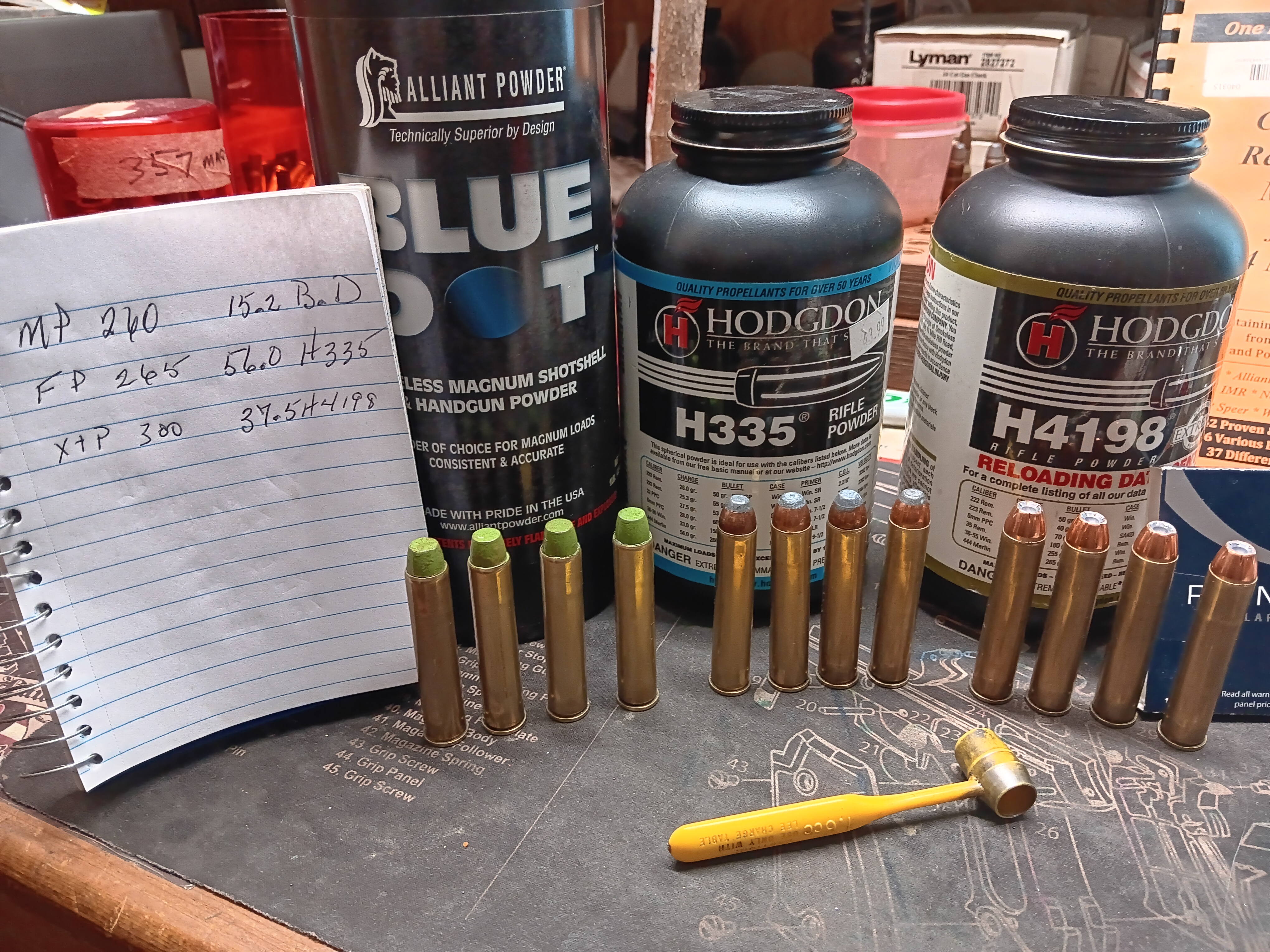

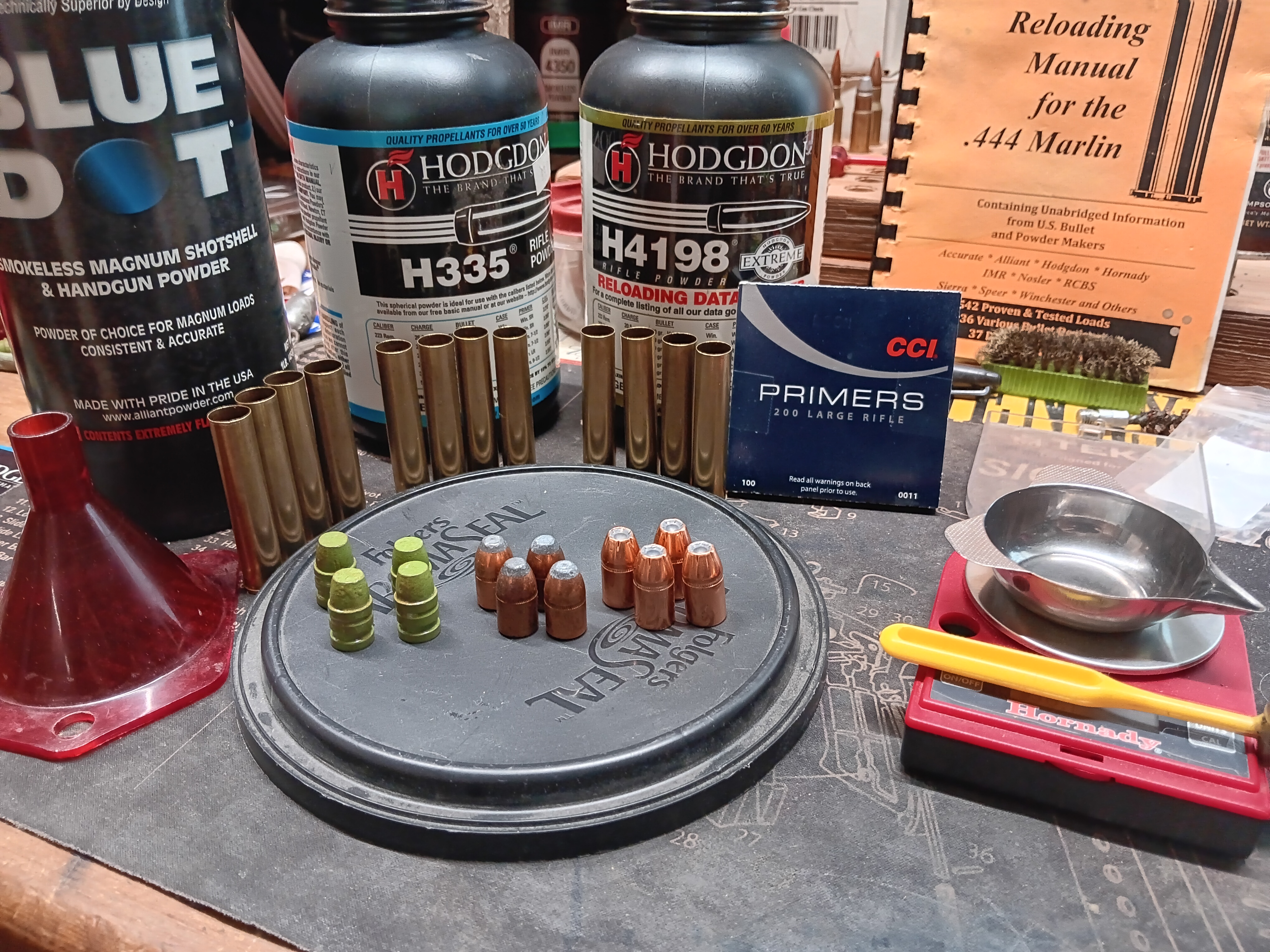

Well, yesterday afternoon I loaded these up to try out at the 160ish yd line, but I never got around to it. Was terrible warm and the eyes weren't acting right.
They've all worked at different distances and just curious at a little more.
I did get out early this AM and gave 'em a go.
I'll post a report.

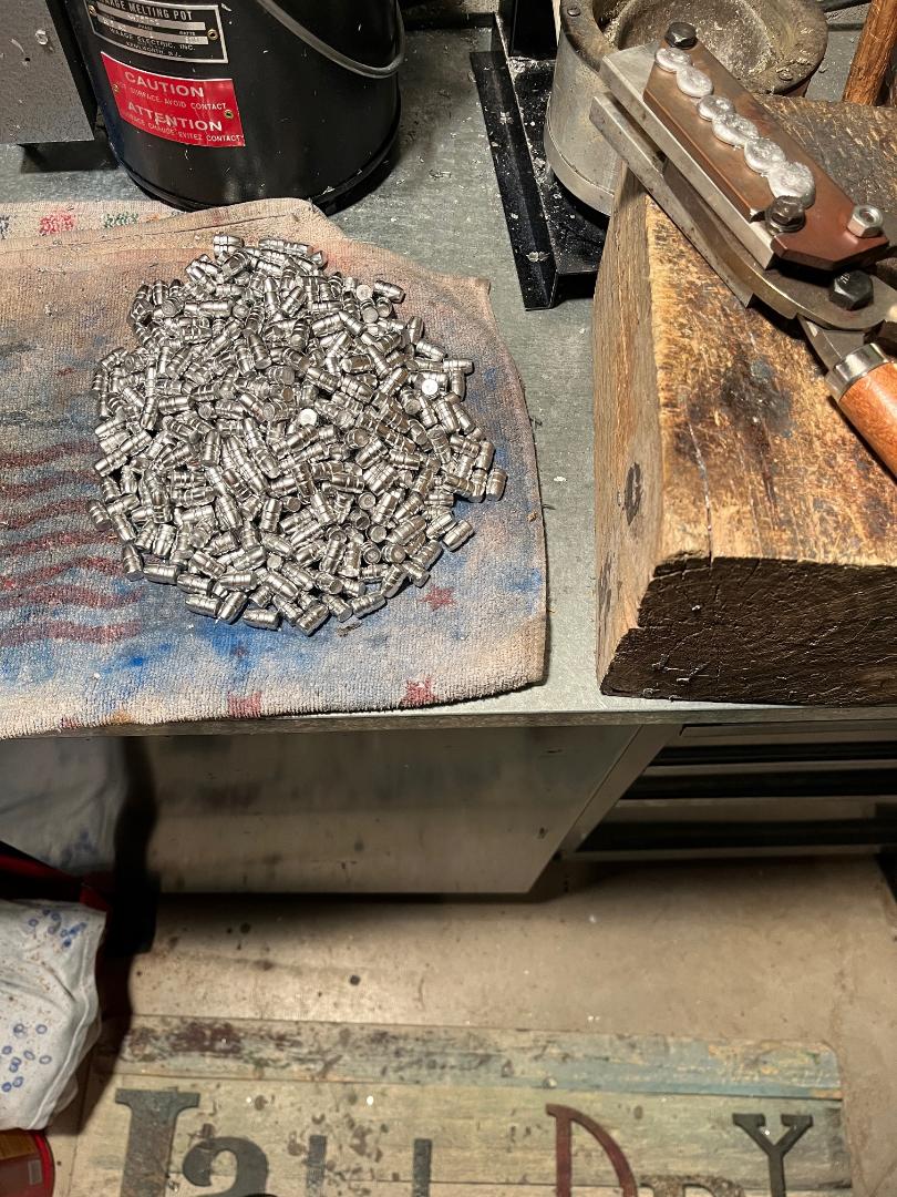

I'm not a big fan of Lee bullet molds but really like the 158 gr. RF bullet. This particular Lee mold runs very well and it was a rainy day so I made a pile of them. I prefer ladle casting but for these I used an RCBS bottom pour pot.They will get powder coated and sized .358". :D

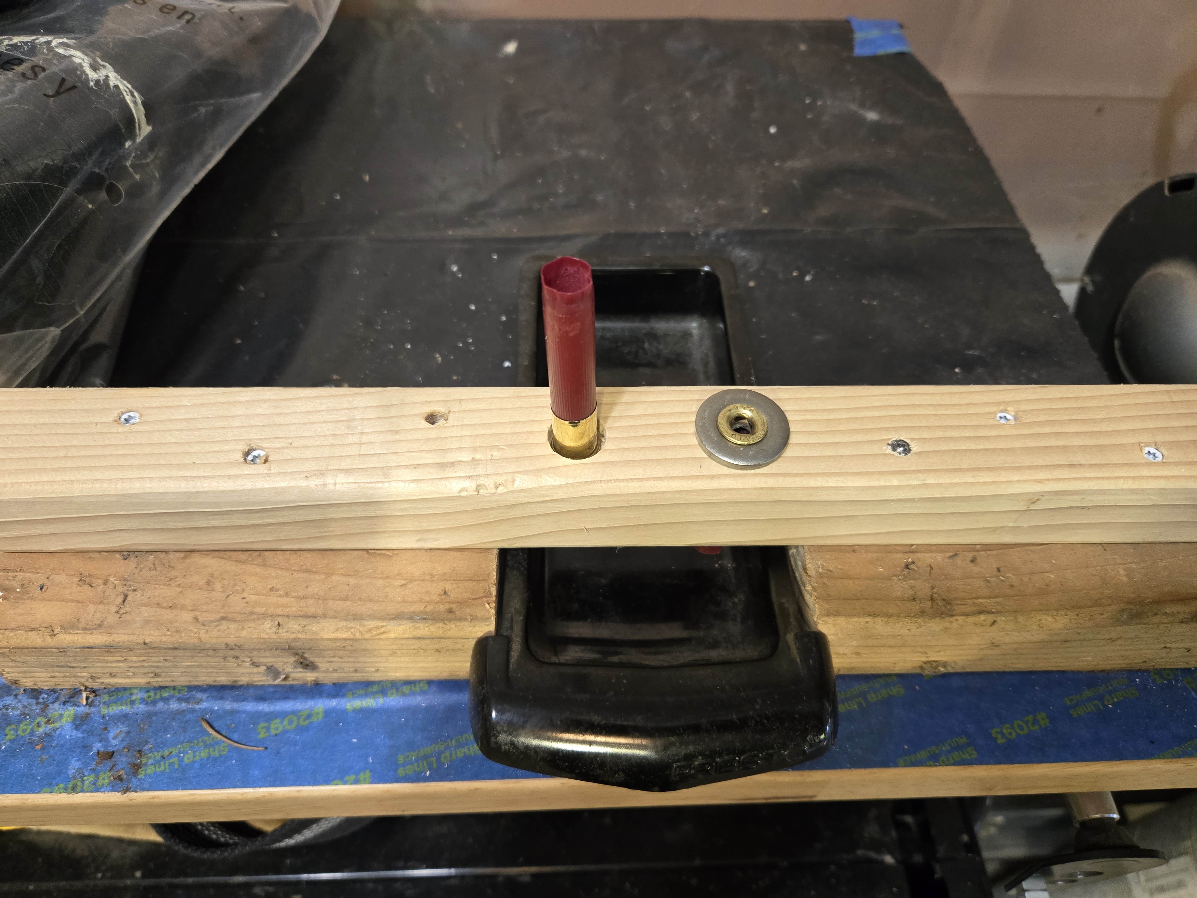

Not today. A few days a go put together a primer/deprimer block for 410 shotshell.
A 2x2 mounted on a pair of 2x4 stubs.
Left side is for punching out spent primers; the right side for installing primers.
The black tray is from an old griddle.
A wooden dowel is used to seat the primers.
