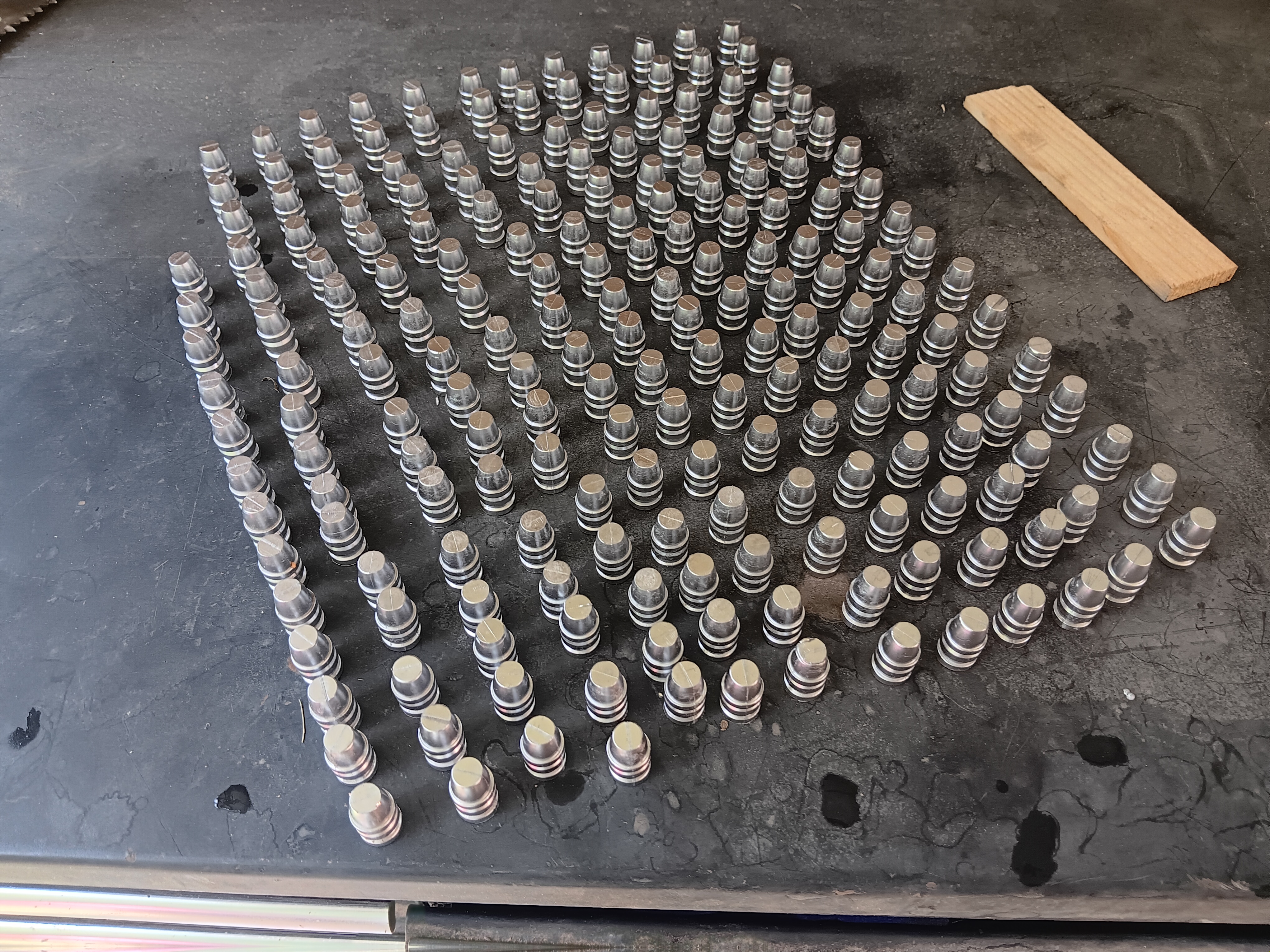

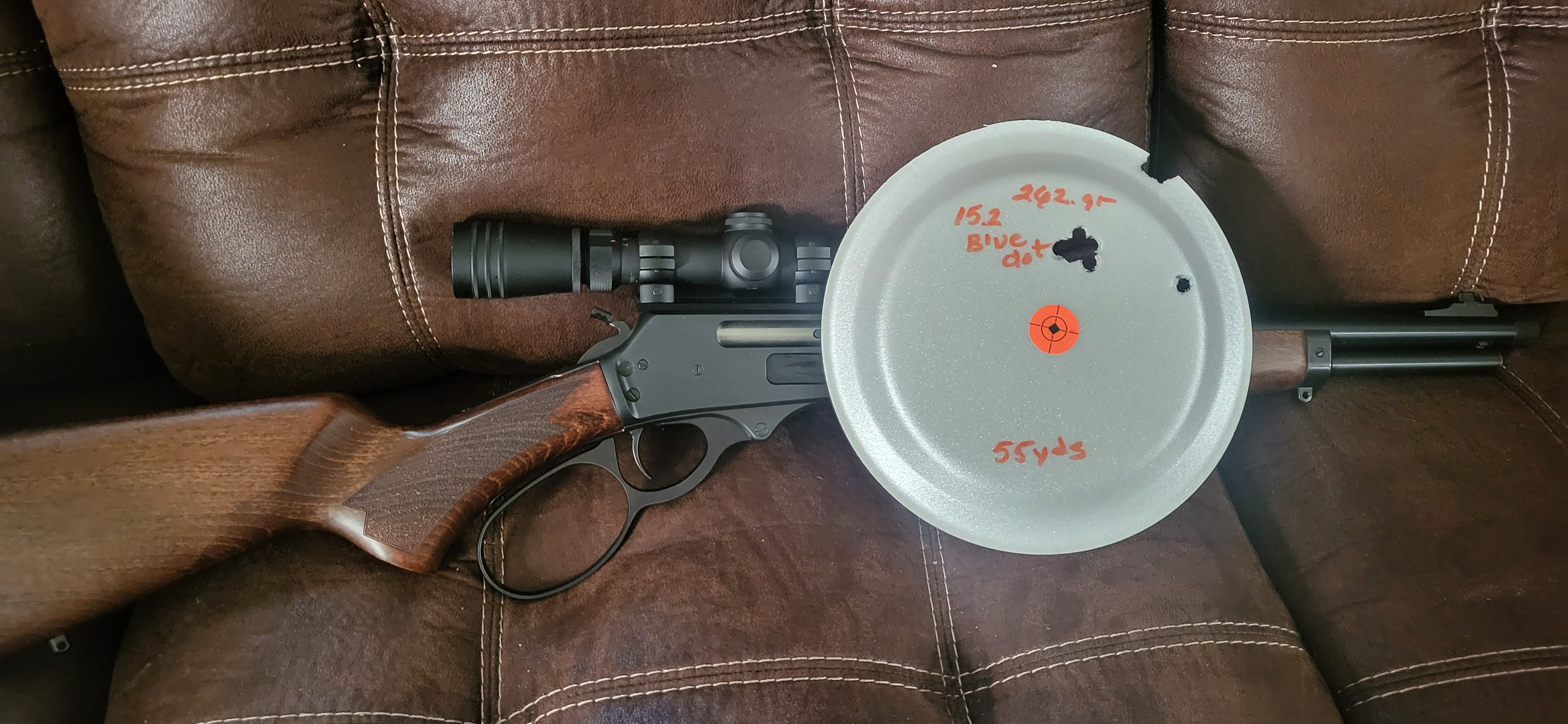

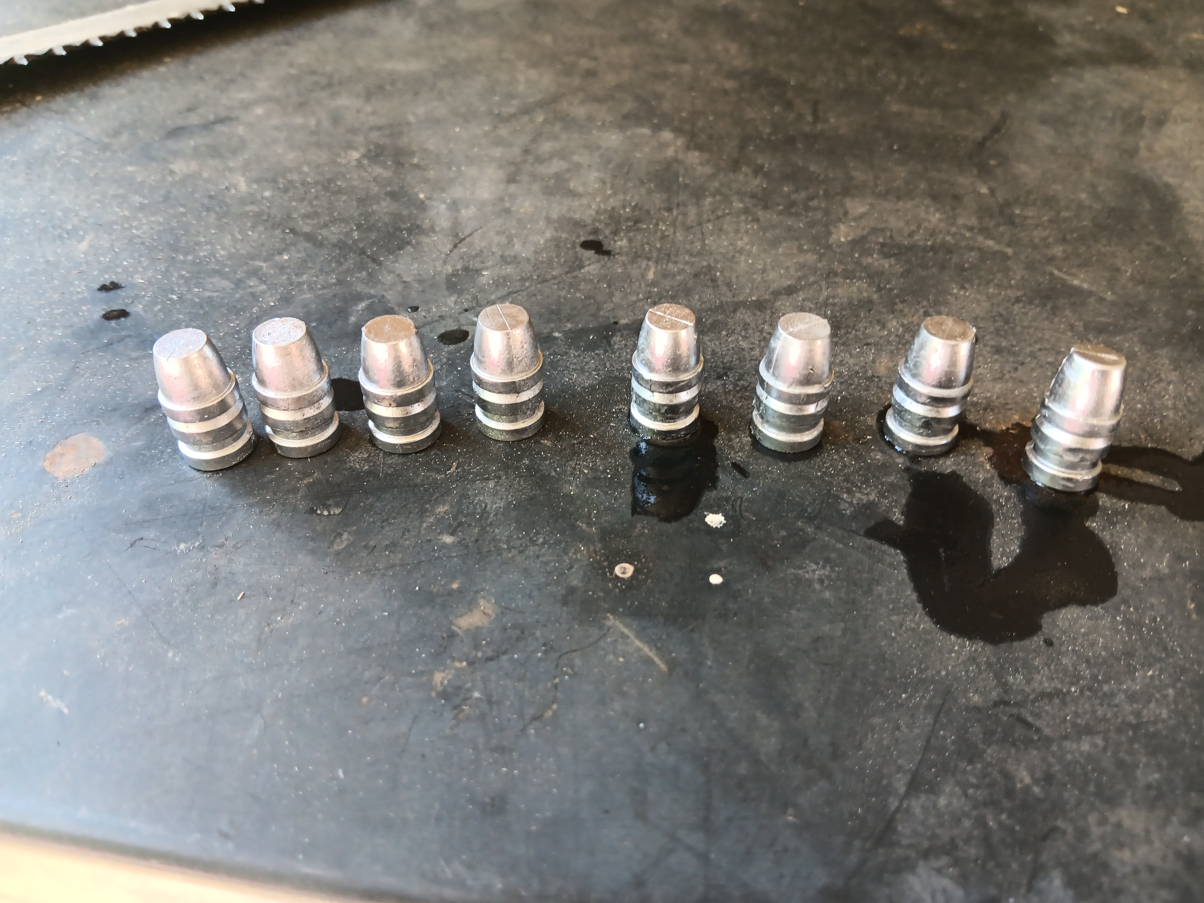

Well, I stumbled across something interesting yesterday and this morning I'm going to stuff a few more to test.
Want to see what it does on the gongs. My own cast, it's a MP Mold, 260gr. .432, mine drop just a tic heavier for the most part.
Was glancing through the one book on the 444 and noticed some data for a cast 250gr. I loaded 4 with some 250's and tried them. Not bad, so I thought maybe something a tad heavier and dug these out that I cast back in the winter. Went with just a few grs over the starting point. Wow! Was I surprised.
This new Trapper has shot 2 different bullets plus this now very well and with a few different powders.
Yesterday's results, the one flyer was the nut on the trigger I felt the slip just as the trigger broke on the forth shot. :( Then the 5th was right back in that sme hole. :D

I've had good luck with reduced loads using Blue Dot and cast bullets in several different calibers. The strange thing is if you run them over a chronograph they often give a bigger velocity spread but yet they were very accurate. Doesn't look like your load needs any fixing at all. ;)

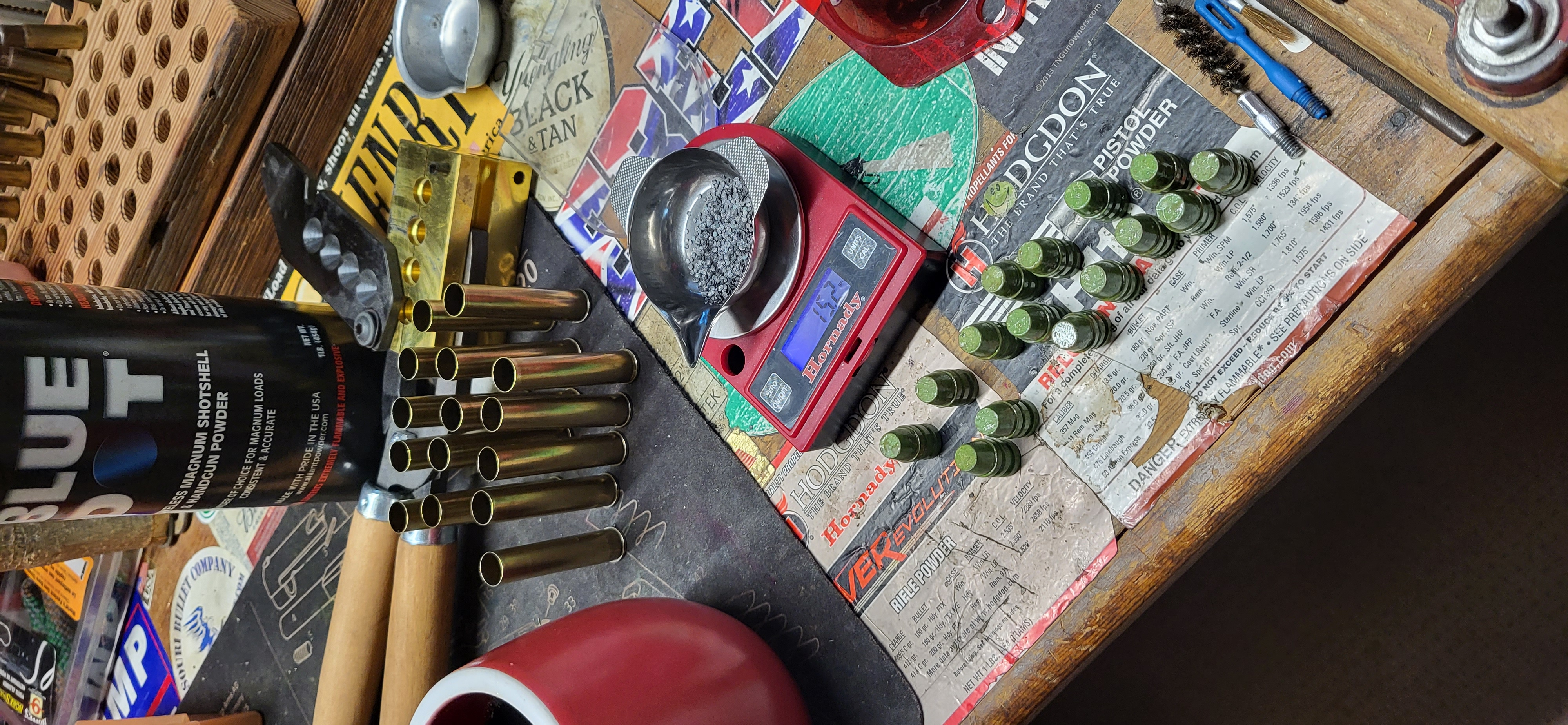

Tweaked the shot shell loader

Saturday, I did do a little casting, outside not at the bench. ;)
260 gr .432 piĺs.
