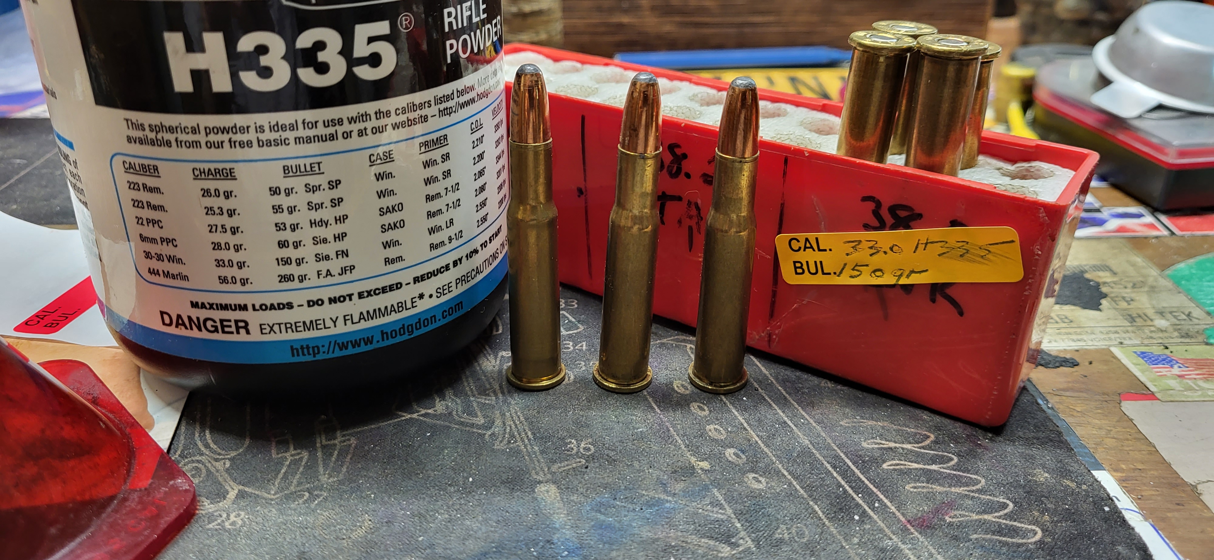

I did a small test batch of 30-30 using a 150gr Speer and some H335. When I got the big batch of 265's the other day I saw on the bottle some data for those. So I looked it up and it was under max so I rolled 5 and got some excellent results. Noticed the 30-30 load, also and it's around 2300 fps so not a max. I found 7 pieces of brass already primed, so I rolled those to see. The one rifle that is scoped will be our tester. It generally shoots 170's better so we'll see.
