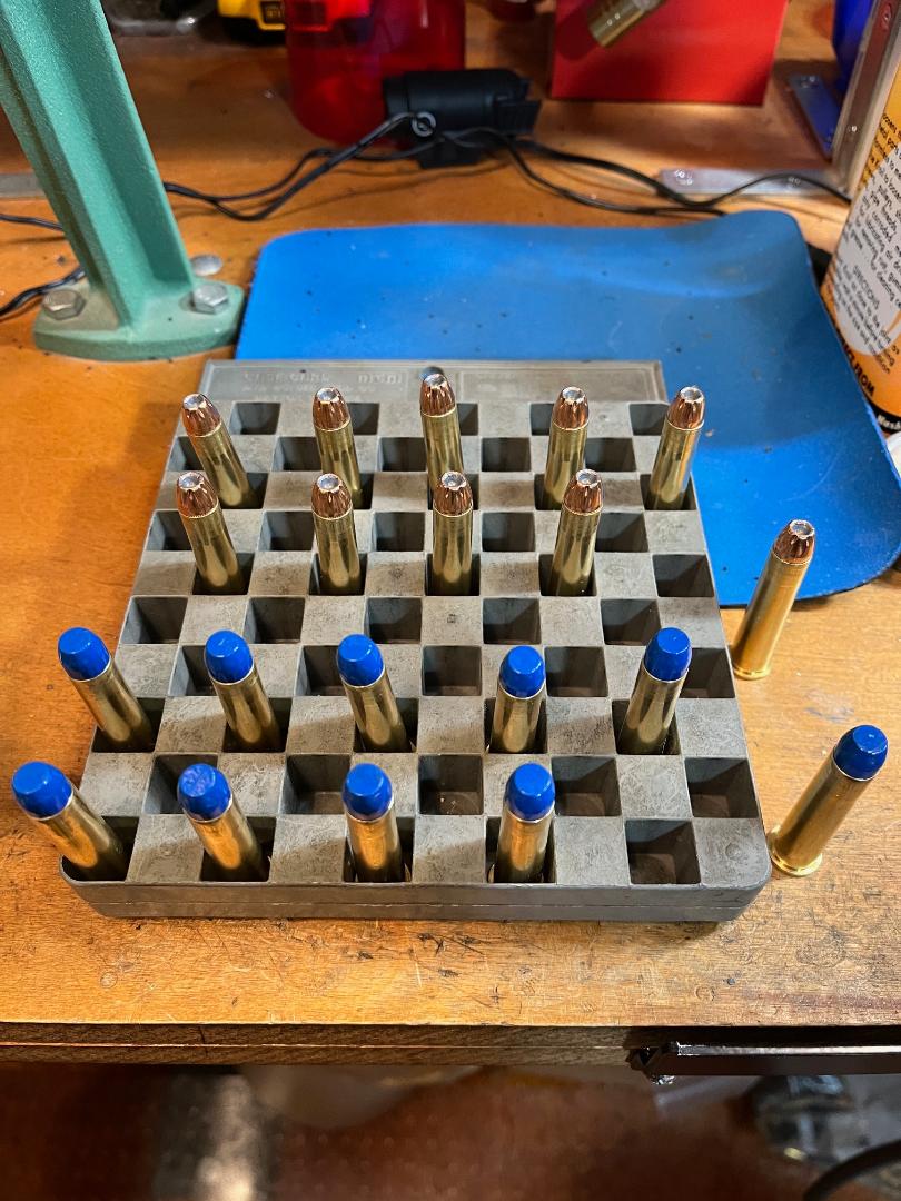

My first .360 loads. I used Starline .30/30 brass. The powder coated cast bullets are light loads of Unique with the Lyman #358665 which are about 162 grains and sized .358". The jacketed are 180 XTP's over #5744 and should about duplicate a .357 Max for velocity. Tomorrow I'll pick up some Hornady 200 gr. round nose and start with CFE BLK powder for some full strength loads. I wanted to use the Speer 180 gr. but can't find them anywhere.

Looks good, will be waiting to hear how it went.
As far as those 180gr. Speer go, I haven't seen any in a while.
Was wanting to play with some in the 35 Rem.

Did you get one of those shooters friends yet for the full power load workout Grandpa? :lol: I know off the bench is going to be ouch time.

At this stage of the game by the time I work up a good flinch the shot is already gone. :lol: :D
