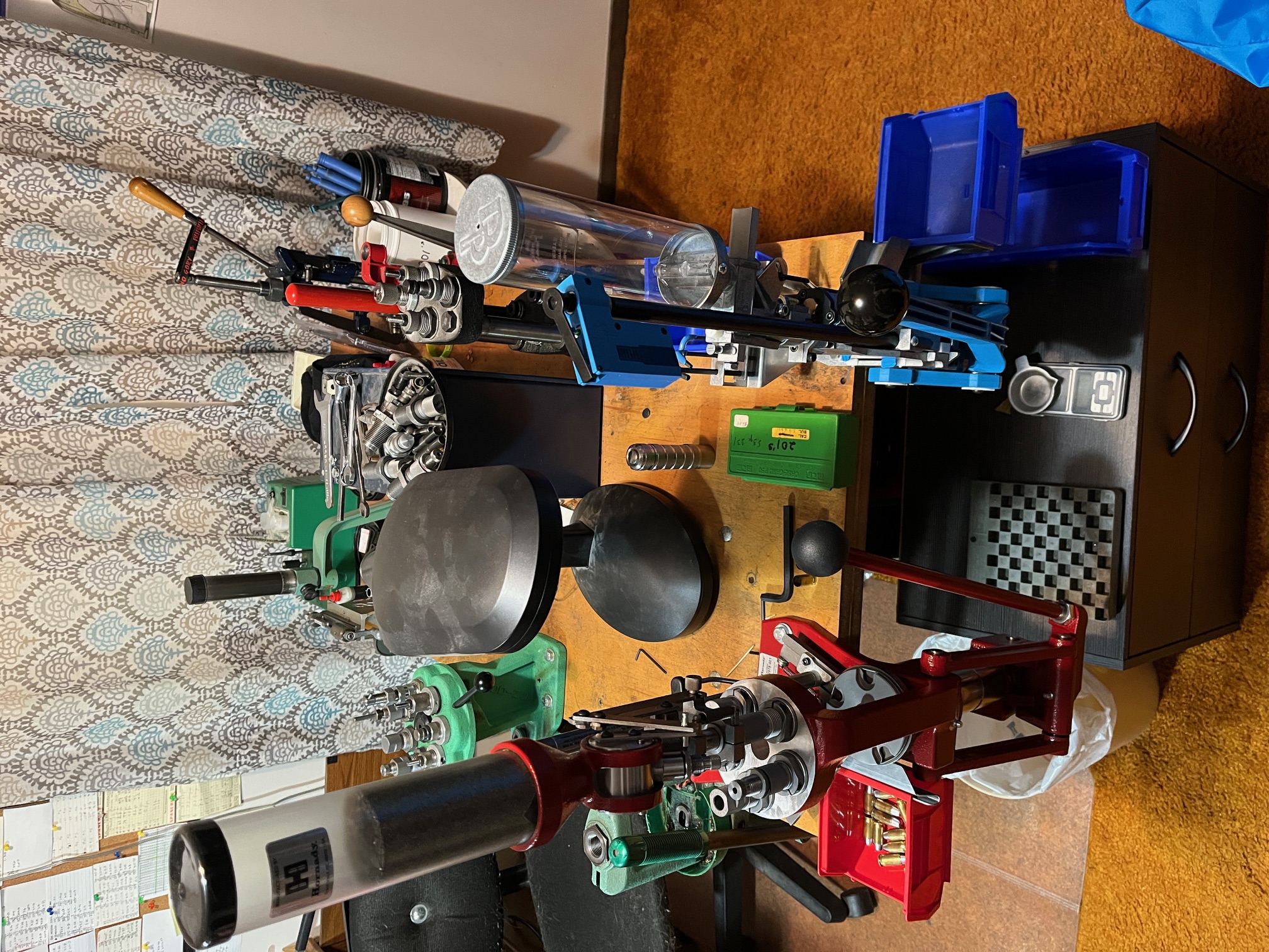

I cranked out a few .45 ACP's on the Hornady AP. It came out of the box badly out of time but after the dreaded reading of instructions :lol: she's running like a watch now. As you can see....my lair is getting a leetle bit crowded. :D
Full table.JPG (1.39 MiB) Viewed 1155 times
