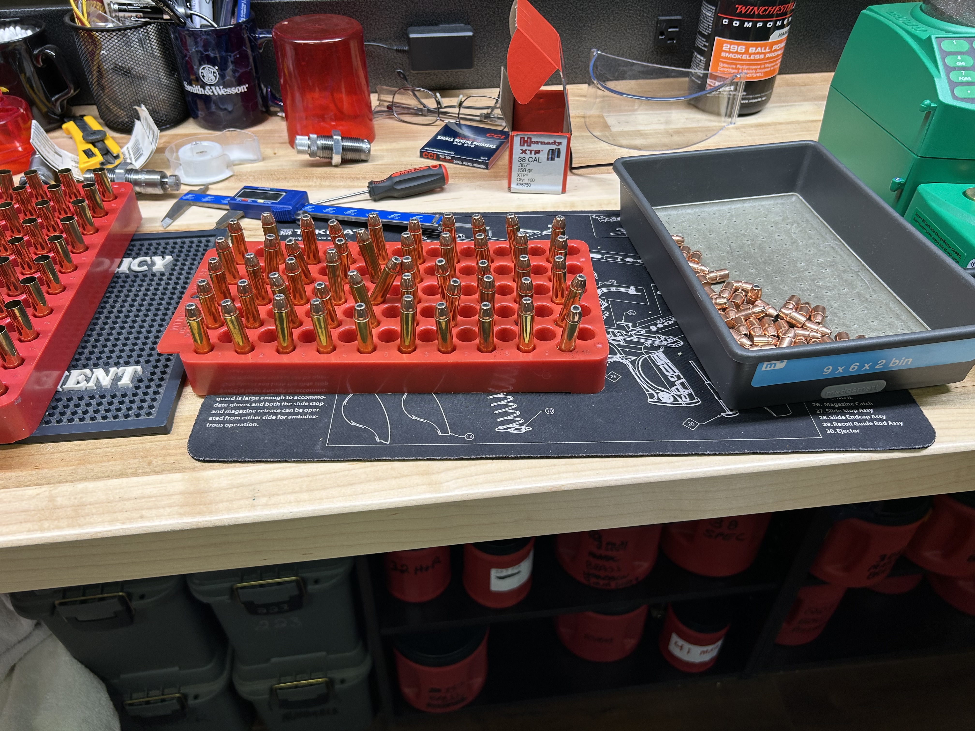

With the lee factory crimp, I would start with 1/4 turn crimp. I'd look at the rim and make sure it was sealed/touching evenly all the way around. Usually 1/4 turn, maybe 1/3rd turn at most.
BUT, the case would have a bulge at the crimp area, as if I was criming it too much. It would not drop into my rcbs case gauge, (cylinder and lyman gauge it was fine)
As soon as I swapped to the redding, that bulge disappeared.
Nickel case redding crimp, Brass case lee. The brass case is seated all the way into the rcbs case gauge.
A look at the nickel case crimp
A look at the brass case, You can see the shiny spot where the brass case seems to have bulged. IIRC this was a gnats hair over 1/4 turn of the lee factory crimp. I needed that much to get it to fully close over the end of the brass. This bullet was pulled, and none of the blue powder coat was broken.
Nickel case in the case gauge.
Brass case after running the round through the Redding seating die set to crimp only.

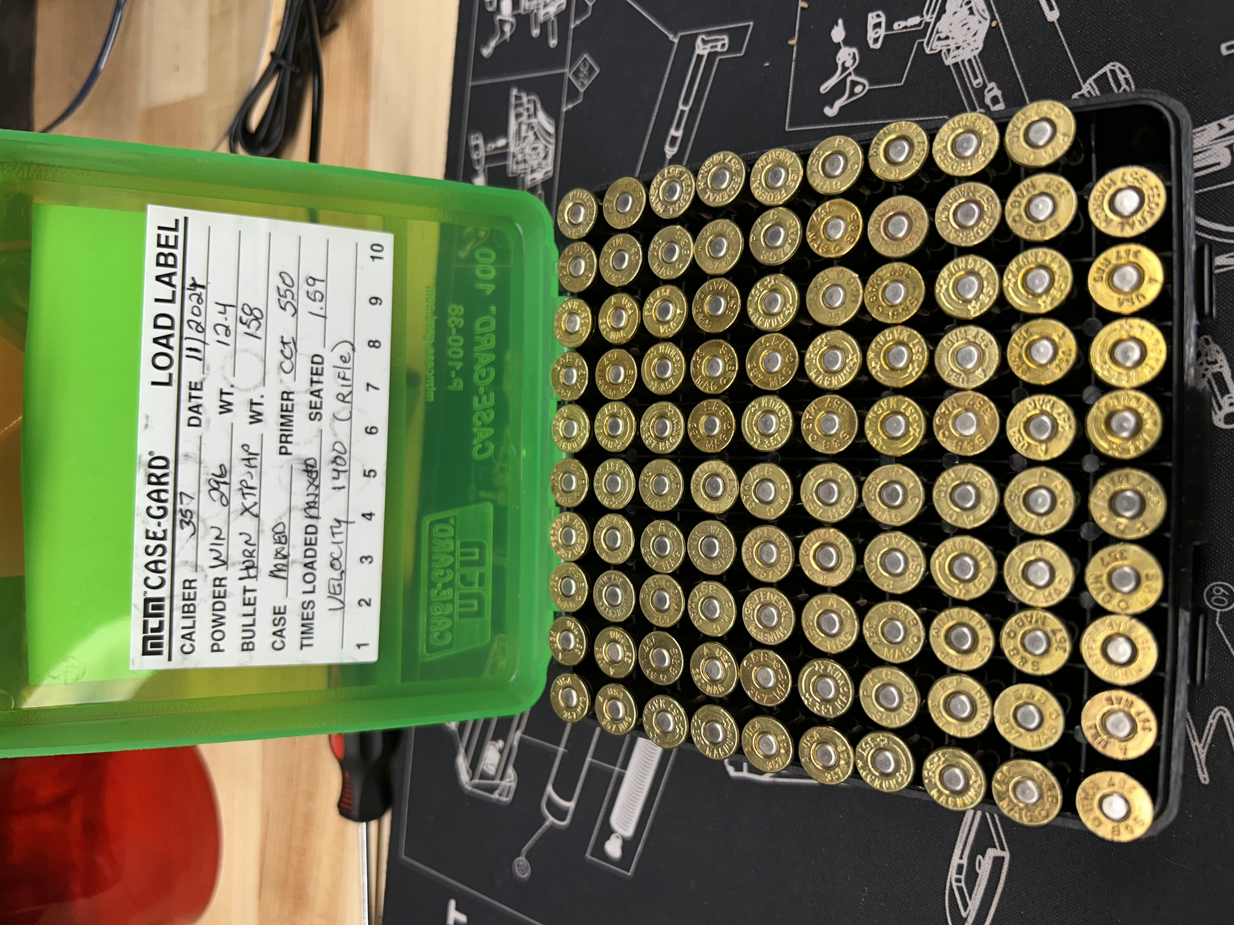

Last week my stepson and I shot up the last of my 357 loads so yesterday I made some more. I loaded 100 (99 really) using the Hornady 158 XTP and Win 296. Why 99 do you ask….. when I was seating the bullet in the very last case I didn’t feel any resistance and that triggered an alarm. Sure enough it was a split case. I pulled the bullet but didn’t bother to load up one more as I didn’t want to run thru all the dies for one cartridge. I’m using my single stage not my turret for this. I plan to load up a couple hundred more so I’ll finish up that last one then.
