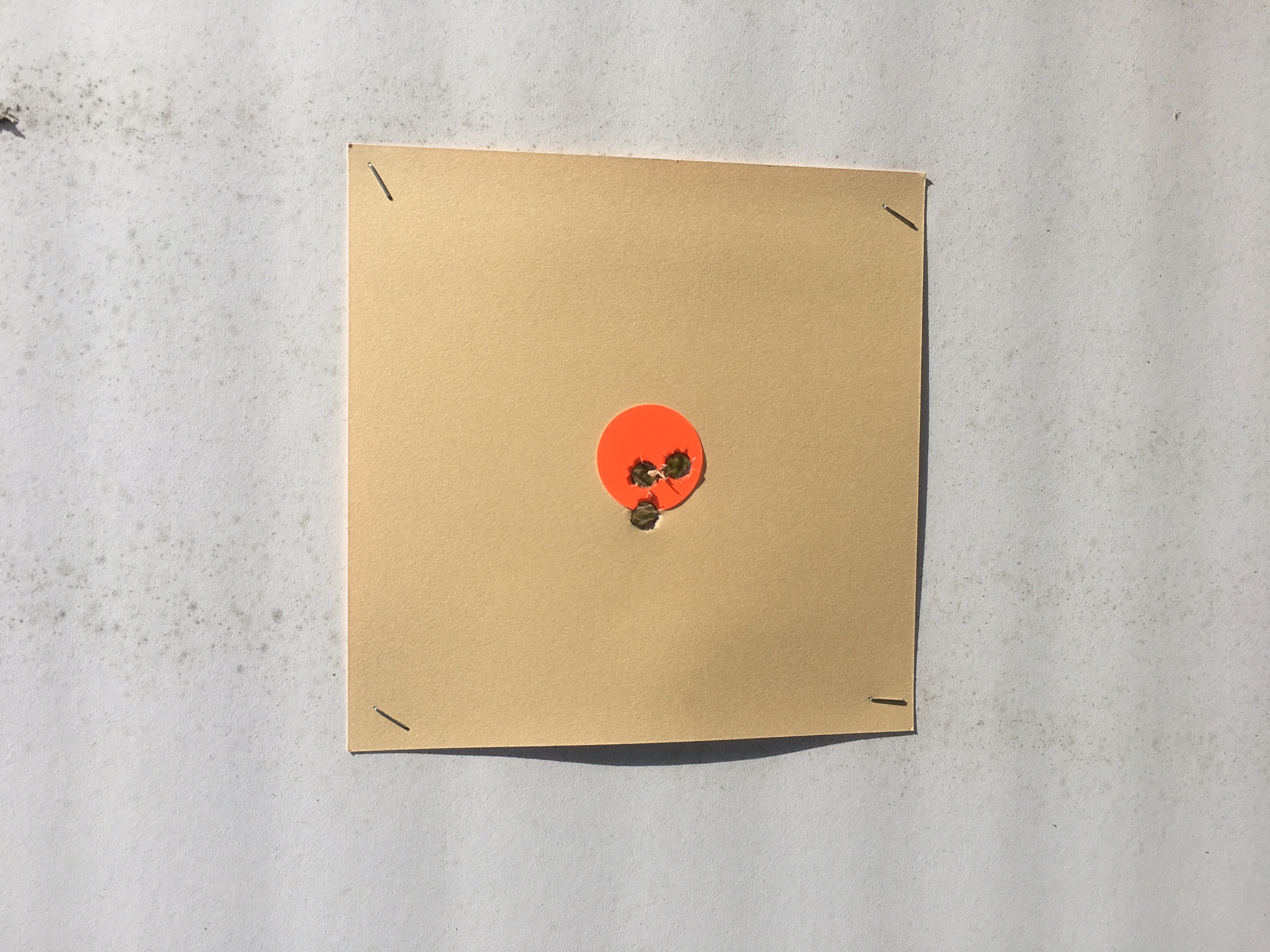

So not really at the loading bench today, that was last night. But I wanted to load up more of the 158XTP-FP bullets to get a good level of confidence in their performance on paper. This has shot well for me in the past using Lil Gun at the load published in Handloader many years ago. It's over current published listings, so I'll not post the charge. When I got everything set up, and I'm using my Square Deal as a single stage, the Lil Gun in the powder hopper was dropping at slightly under what it was last time. I weighed what it was dropping and it was 0.3 grains under what I had it set for last time. No reason why, except perhaps that the hopper wasn't very full, so less head, and a correspondingly decreased charge weight. Anyway, I just decided to go with that and see how it shot.
Today I got out my .357 BBS and these were the first three shots I fired. Distance was 50 yards, and that orange sticker is 1¼" in diameter. Works out to just a hair under ¾". That was good enough that I decided to stop there and leave a winner. I'll get this out a few more times between now and deer season, fire a shot or three, and gain confidence that it's still hitting point of aim for me. Knowing that the rifle shoots like this really adds confidence in those woods shots where you have to pick your lane through trees and branches. That slightly reduced charge turned out to be a happy accident for sure! I loaded 20 rounds, so I've got 17 more to play with between now and deer season.

Nice! I have some of those 158 xtp fp's. That is a great grouping. I loaded 25 of the 180 grn xtp's using the same load i posted above. I'm curious as to how they will do

I have yet to try the 180XTPs, but that'll happen eventually.
My chrono gave me an average of just over 1900fps on these, which I'm pretty happy with. I was going to send a couple down to the 100 yard target, but would have had to move the chronograph screens, so I just quit with those three for that day. I had a few other rifles to get to and different loads for those to test.
If I'm looking at a trend for loading/shooting the XTP bullets, it seems that my rifle likes heavier and longer bullets, so the 180s should satisfy both of those criteria. I'm interested to hear how they work for you.
