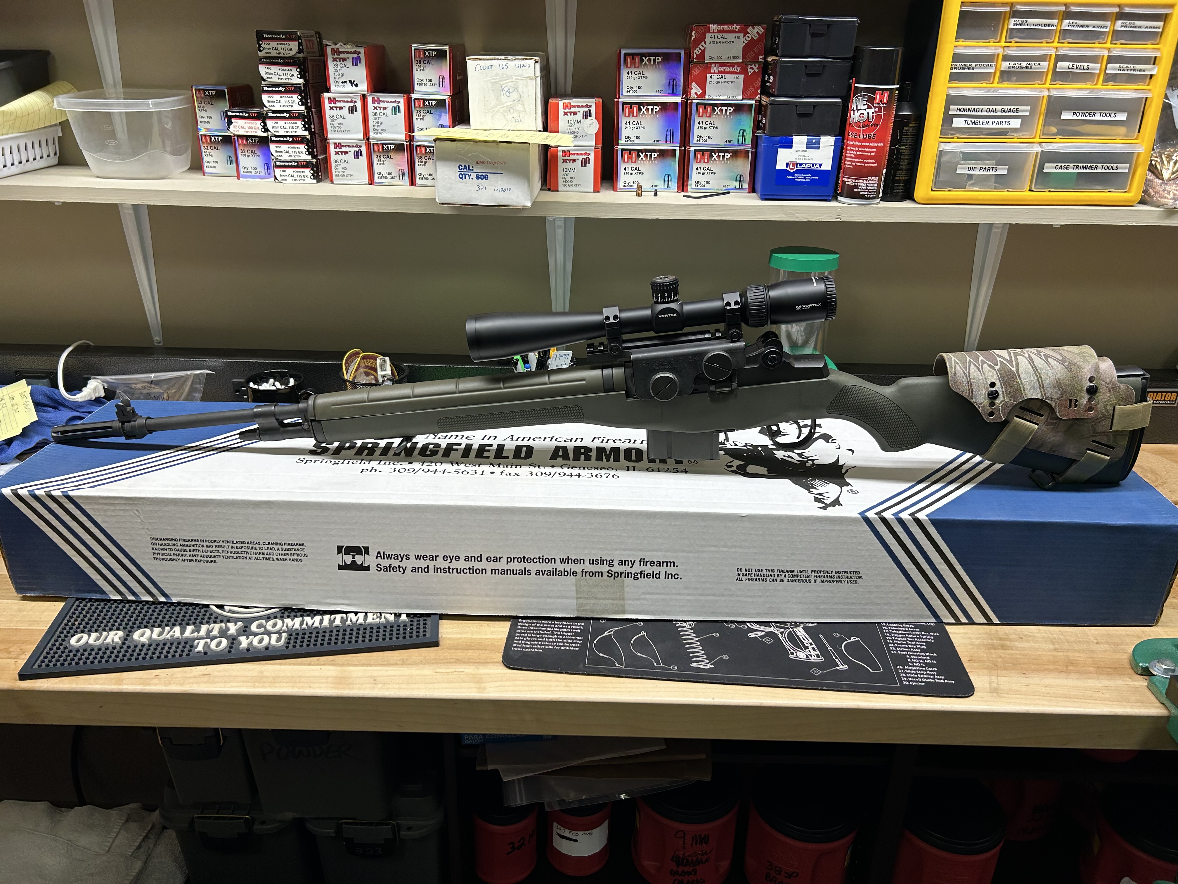

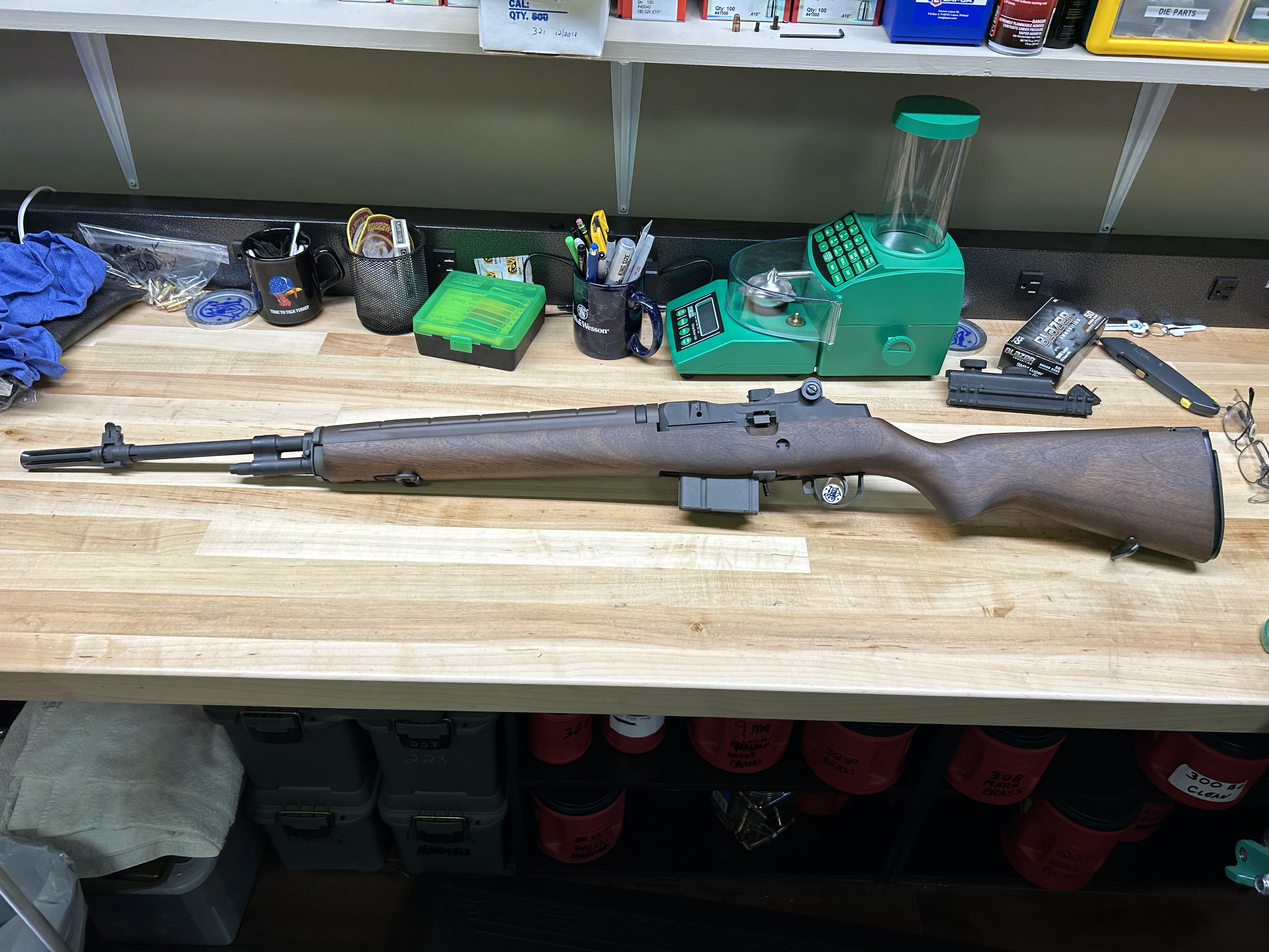

Didn’t reload any ammo but did return my M1-A to its original factory configuration. I have it up for sale and with all the accessories on it I had it priced at a point that wasn’t getting any interest. So this way I am able to lower the price. We’ll see if this helps. Here’s a before and after pic just for shites and giggles.
