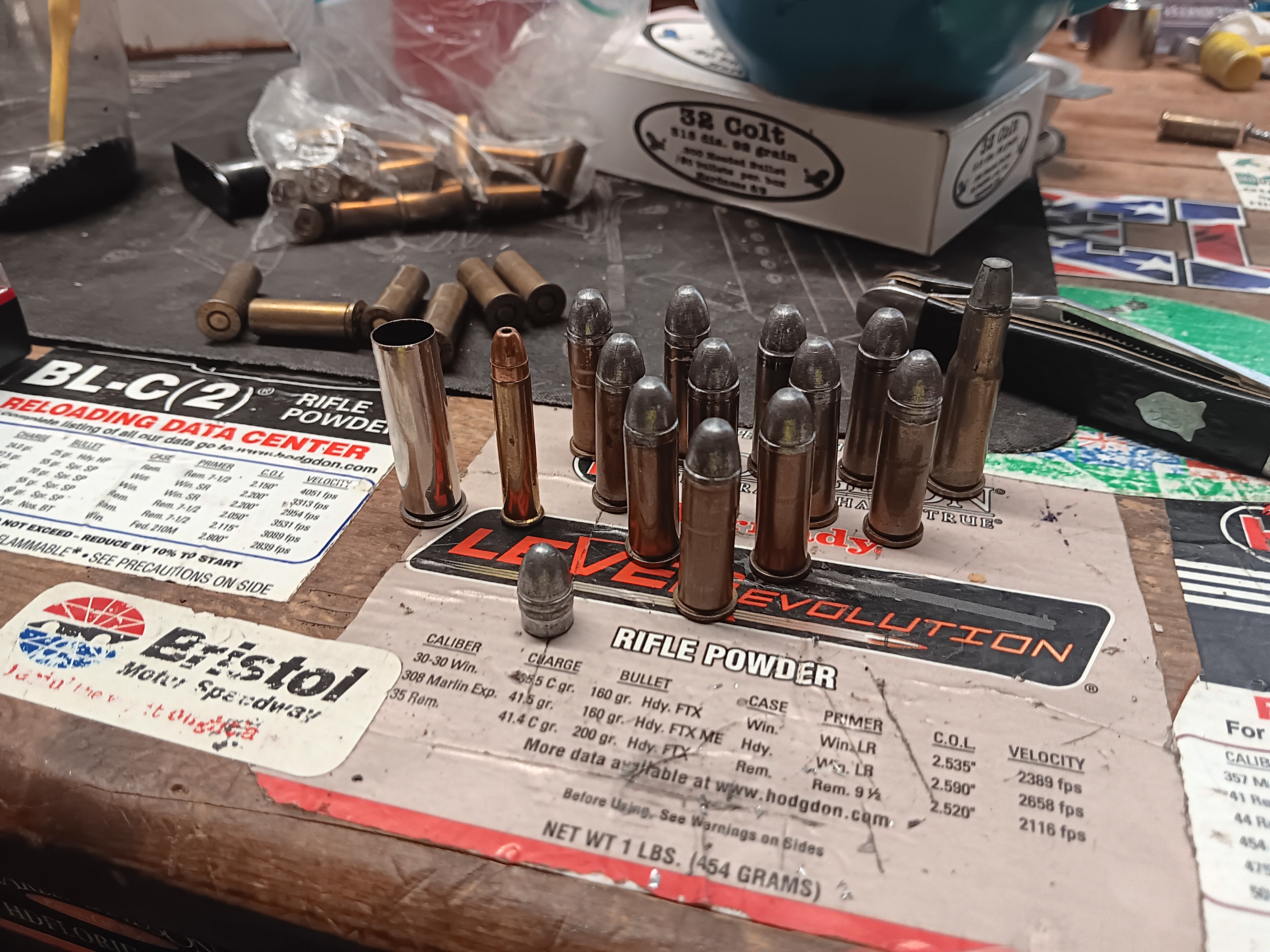

A little something different and suspect something most have seen.
For scale, a loaded 22 mag and an empty 357 mag brass on the left and a 25-20 on the right. 32 colt

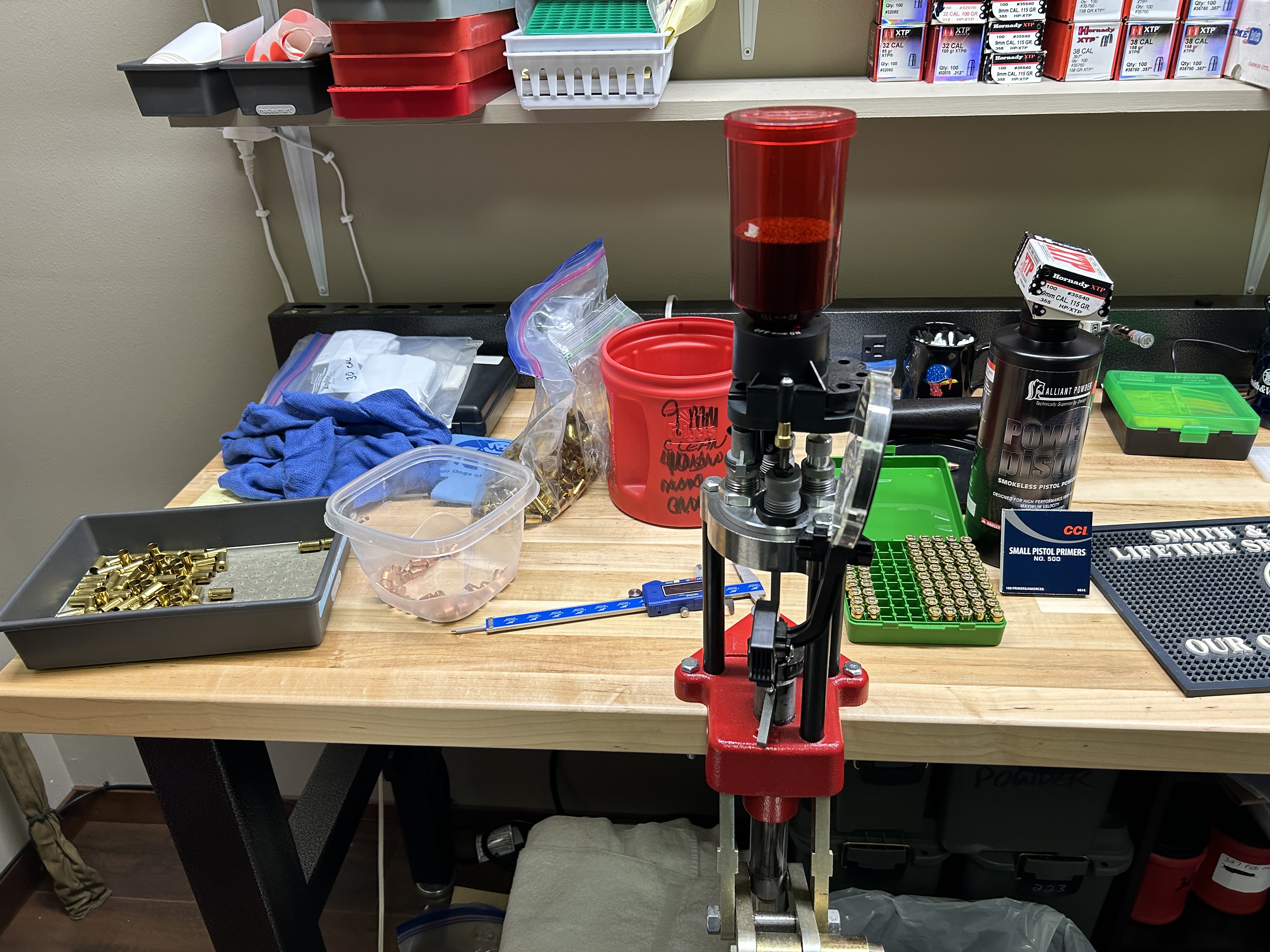

It’s been 3-4 years since I last used my Lee turret press so I decided to re-introduce myself to it. I choose 9mm to load and the last time I loaded 9mm I used my single stage press. So not only did I have to remember how to set up the press I also needed to adjust the dies. Both good challenges to get the old brain matter going. The Lee press loads one cartridge at a time so while slower than a progressive the operator can monitor each step. I am constantly amazed at how accurate the plastic and pot metal auto powder measure is. Durning set up once it settled it threw a constant 6.4 grains of Power Pistol. And while loading 50 cartridges I do a weight check on every 10th and all five checked were exactly 6.4.
For now I just loaded 50 but I’ll do a couple hundred more probably early this week.

Hatch one is what I do all my loading with, but I removed the auto indexing rod and use it as a glorified single stage.
Like the other day, I just went back and forth between the sizing die and the expander/powder despensing die.
I would then inspect each case before priming, found 2 pieces of nickel brass that had slight splits at the mouth that got tossed in the scrap brass bin.
When I'm loading I generally weigh powder on the Hyd electronic scale and set in a tray then load and crimp all at once.
I have a single stage press but I use it with a universal decapping die, or when I cast I put in the correct sizing die.
