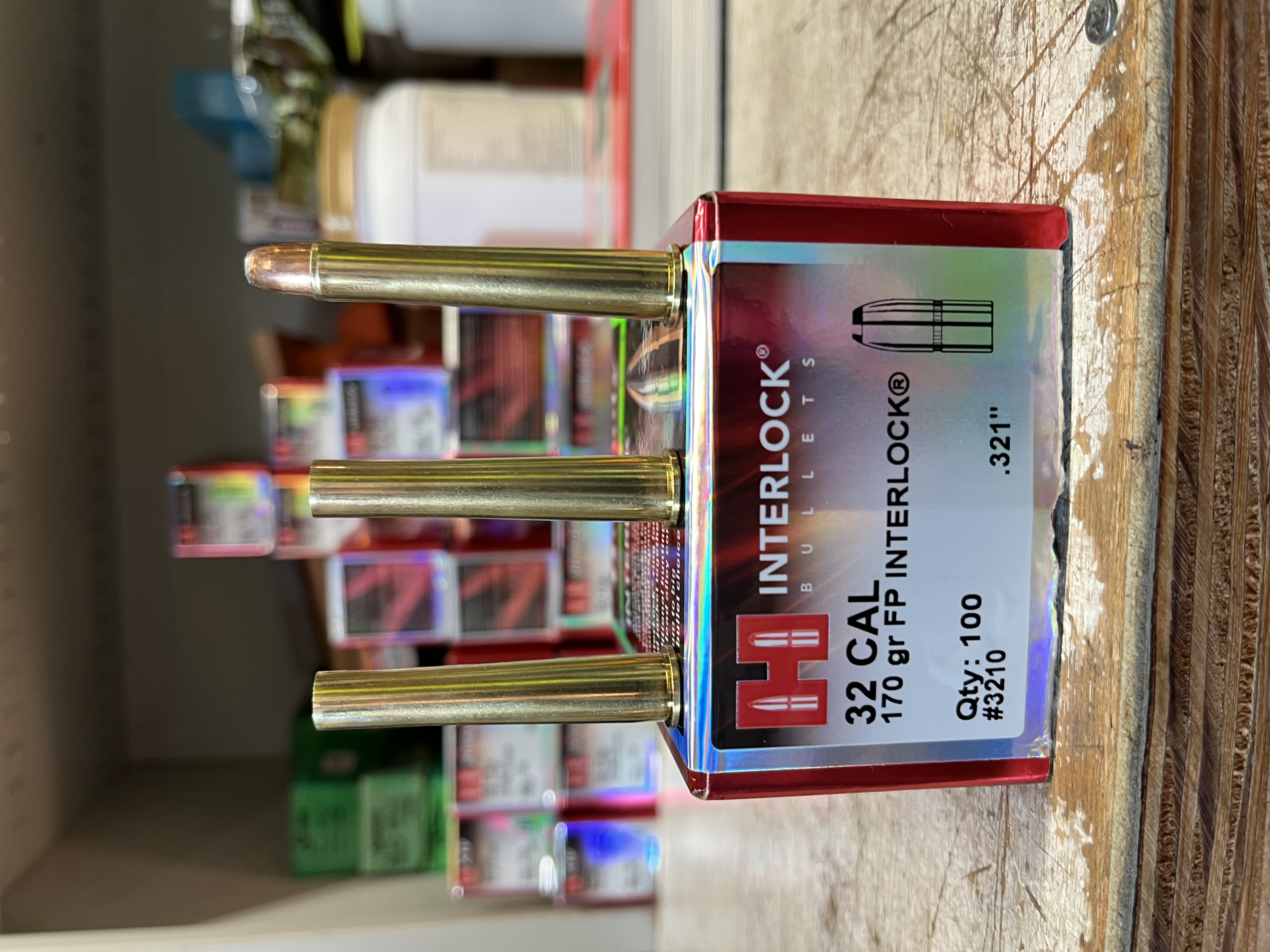

Today I loaded up 7 rounds of .32-40 Winchester ammo, for my Uncle to send through his John Wayne Commerative Model 94 Winchester rifle.
I never could find a single round of factory loaded ammo, so all I have for specs are what I could find online and in my Hodgdon’s manual.
Would have been nice to find some factory stuff to measure and such, and see if they feed okay. I made several dummy rounds of various lengths, including shorter and much longer lengths. None of them would feed & chamber correctly. It’s as if the rifle’s elevator drops down just a tiny bit as you pull the lever back a ways, and the round gets hung up at the “feed ramp” portion of the chamber, right at the bullet’s tip. Moving the lever forward/bolt backwards a tiny bit at that point allows the rear of the case (case flange) to pop up through the widened portion on of the feed rails, and up onto the rail. Then, moving the lever back will allow the bolt to go forward and chamber the round. I’m perplexed. My Uncle said not to worry about it. For now, he can just send a couple of rounds through it “single shot style”, and then take it to a gunsmith to figure it out…..

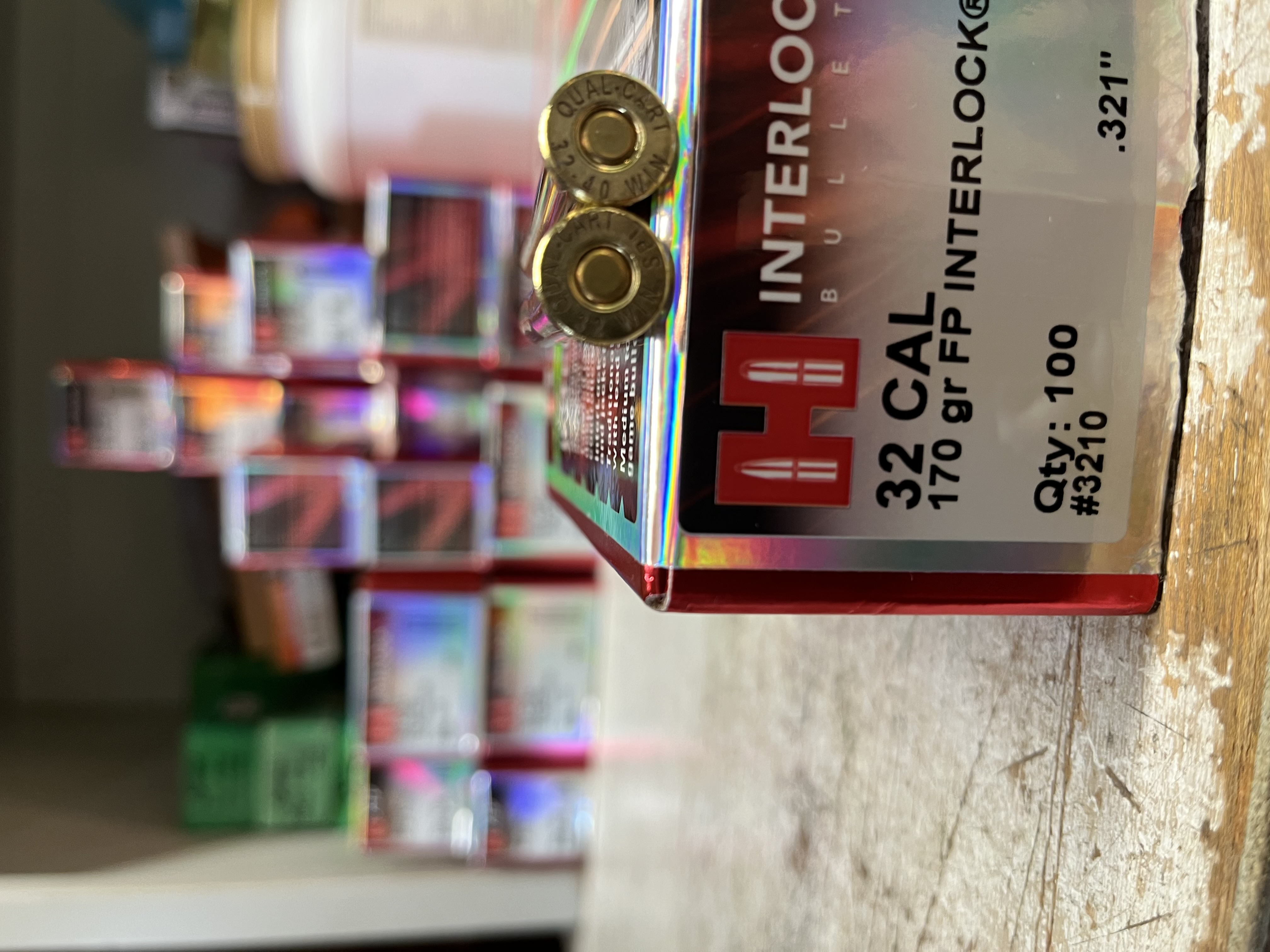

One weird thing about all this is with 2 of the brass cases that I got from Graf’s, made by Quality Cartridge Co.. To me, they measure and look identical the other 18 cases of 20. But these 2 cases are marked “32 WIN SPL”.
Here’s the .32 SPL case on the left, a .32-40 case in the middle, and a loaded .32-40 on the right for comparison.

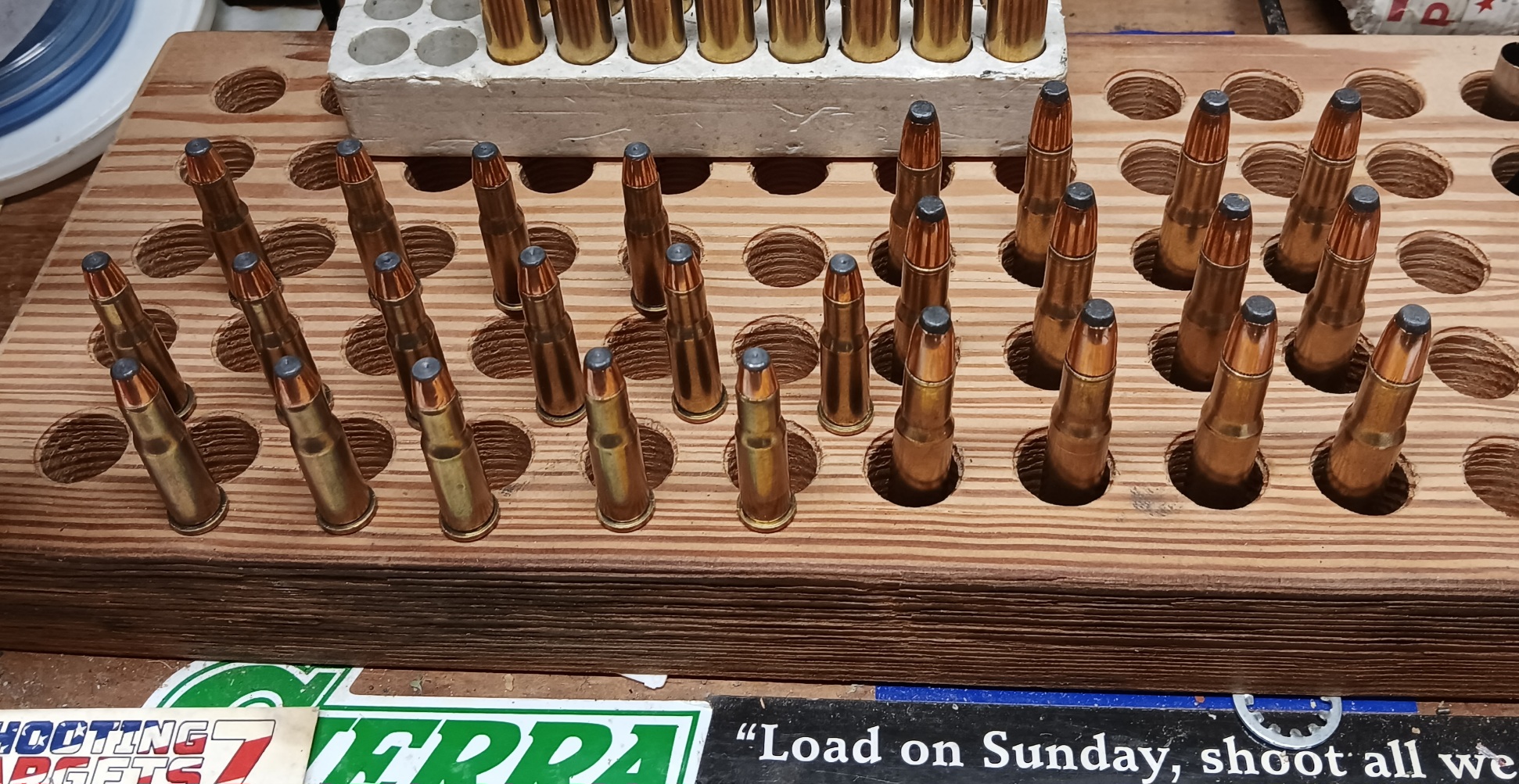

Loaded a dozen 170gr Sierra's over 29.2 grs. of 3031.
Then some test loads for the 25-20, 60 gr sp and some 2400. Three different weights to try.
