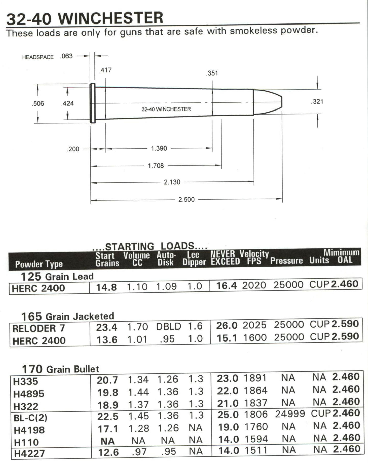

Ordered some reloading components last night from Graf, and today from Mid South Shooters Supply for an Uncle of mine. He has had a John Wayne Commemorative Winchester lever gun, chambered in 32-40. I haven't been able to find any loaded ammo for this gun (neither has my Uncle) in the few "SEARCH" sessions I've tried. So, he wants just a few rounds loaded up to be able to fire. He doesn't care about the "resale factor" of an unfired collectible rifle like this one, as he plans to keep it until it's time to will it his Grandson. It will stay in the family.
I went with new 32-40 brass from Graf rather than attempting to form cases from .30-30 or 38-55. Found some .32 Hornady 170gr. projectiles from Graf. Found a load recipe in my older Hodgdon manual, but if anyone has any info on mild shooting loads for this old carrtridge, it would be much appreciated.

Post by CT_Shooter » Fri Aug 04, 2023 4:50 pm
Mr. Neutron wrote:
Fri Aug 04, 2023 3:35 pm
Here's data from Richard Lee's Modern Reloading First Edition; 1996.
32-40 170 gr. Data
32-40 170 gr. Data
32-40 Modern_Reloading_1st_Edition_by_Richard_Lee_2.jpg (203.69 KiB) Viewed 2353 times

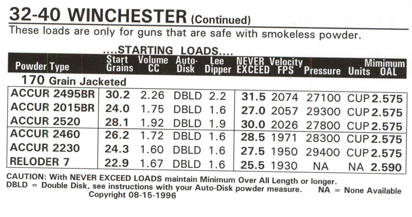

This is from the same source, but for different weights.
32-40 Reloading Data
32-40 Modern_Reloading_1st_Edition_by_Richard_Lee_1.jpg (265.56 KiB) Viewed 2353 times

Post by Mr. Neutron » Fri Aug 04, 2023 5:26 pm
Thank You Very Much for that, CT_Shooter!!
Those are really helpful, and interesting to compare with my Hodgdon manual's charge values.
One thing I really like about the Richard Lee info above is that he differentiates between jacketed and lead bullets. My Hodgdon simply says "170 Grain Bullets", but doesn't say which type. :?
Between what you posted here, and what I have, I think I can find something mild for him (my Uncle) to send downrange with that rifle.
Thanks again!!!
