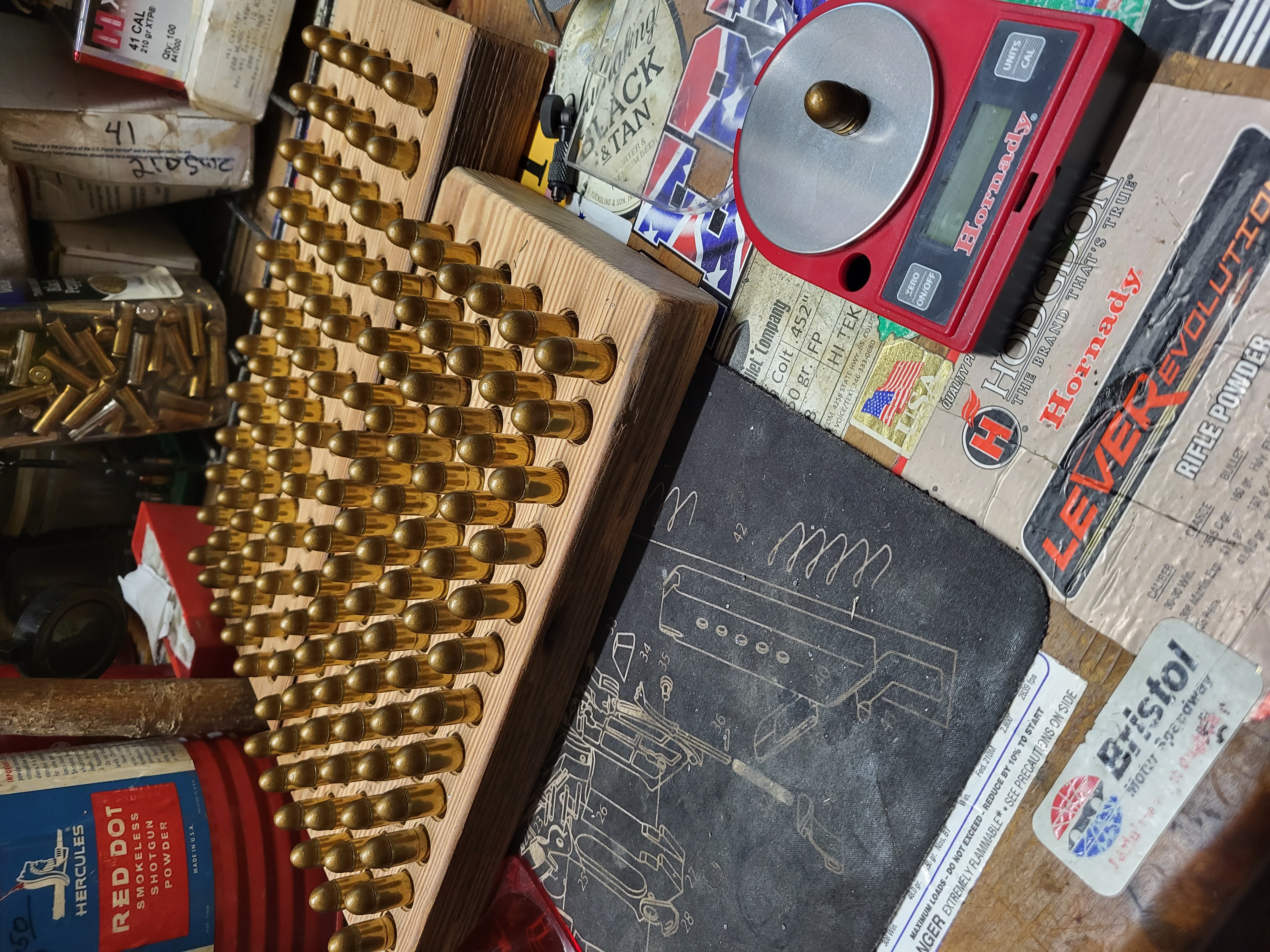

Finished loading a bunch of .38 special with RCBS 148 gr wadcutters sized .358" with Carnauba Blue lube over 3.3 grains of Bullseye. I tried some Fed small pistol match as well as WSP standard and it would take a better shot than me to tell any accuracy difference. I've got a pair of K38's that will group very close to 1" @ 25 yards with that load from a wrist rest or with a steadier old man than me at the controls.
Loading is done with an old CH 4 station press that I leave set up just for .38 special since there are a few other hungry chambers in that caliber to feed.

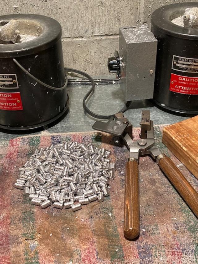

Cold windy and trying to snow today. Perfect basement casting weather!! :D
RCBS 148 gr. WC's

357?
It's been a while since I last casted, but I do need to make some of those heavy 44's of mine.

Yep. Mostly for use in the .38's.

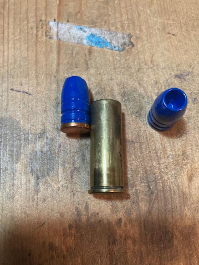

Here's the last .44's I cast. Made them soft with about 16 to 1 lead to tin so thinking they would expand well without fragmenting. Used this bullet in H015 .44 over 2400 powder for deer hunting last November but didn't see anything big enough to test expansion on. Lyman "Devastator" that drops about 260 grains.

I like that, wonder if it would stand up ro some low end 444 velocities?

I never did try it in water jugs. These clocked at 1600 fps so I'm guessing if you kept it under 2000 fps maybe?

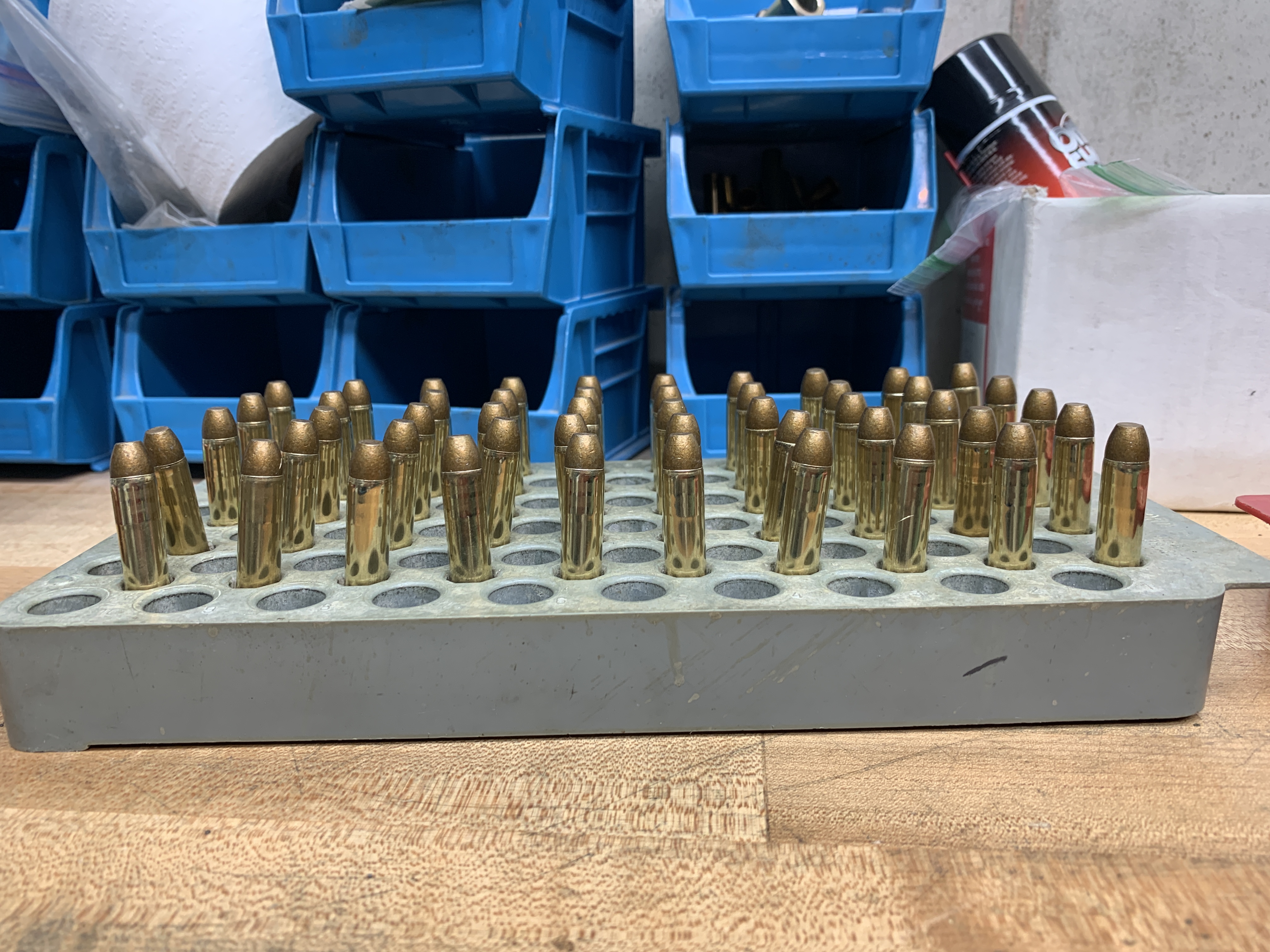

Hand full of 380 cases. Since I'm short on SPPs I'll be trying some primer only tests with SRPs. No powder, no bullets.

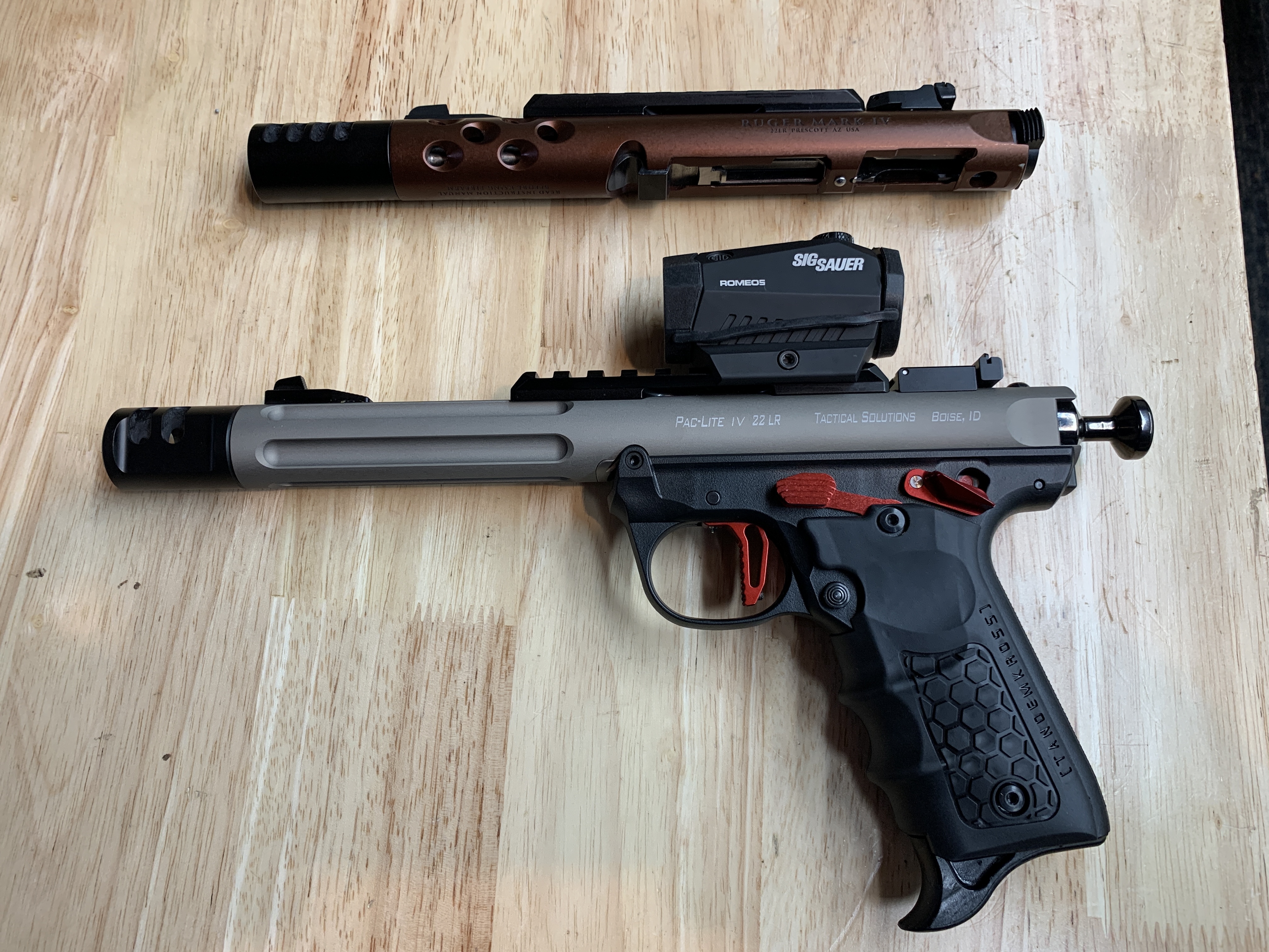

Got some Tandemkross parts yesterday to add to my Ruger 22/45 build. Also updated the magazines with new better springs followers and base pad. It makes the magazines hold one more round.

Let us know how that works Mags. Ive read where guys dont bother buying SPP anymore because the SRP work just fine.As long as the gun hits the primer hard enough to set them off as the SRP has a little tougher face

Nice! If that gun shoots as good as it looks it's a one holer. Is it picky about what ammo you feed it?

5shot its without a doubt the best shooting 22 pistol I have ever owned. Its not picky at all with ammo and I can literally put 10 rounds inside of a dime at 25 yards. We throw clay pigeons on a bank where we shoot and I have no trouble shooting the pieces of the broken clays. My neighbor has one of the lites also and he has done some of the same things I have. But I decided to try one of the Tac Solutions barrels. Glad I did I really like it.

Loaded SRPs into 380 pistol cases. No powder, no bullets, just the primers. Test fired in a Walther PPK/S. Primers, four each CCI #41 Military, CCI #400 and Remington 6.1/2.
The CCI #400 and Remington 6.1/2 all fired fine. Immediate and plenty of bang.
The CCI #41 Military surprised me. I didn't expect them to fire at all. Supposedly the primer face is thicker metal and the primer compound is less sensitive to impact. The first one shot just fine. The 2nd one though took multiple hammer strikes before it would go bang. The 3rd and 4th would not fire at all. So mixed results with this primer type. I won't test this type any further.
Except in the CCI #41 test, testing 4 primers of each type is an indicator but not really definitive. To get to an 80% confidence factor I should test at least 16 primers of each type. Maybe do that someday when primers are more plentiful.
