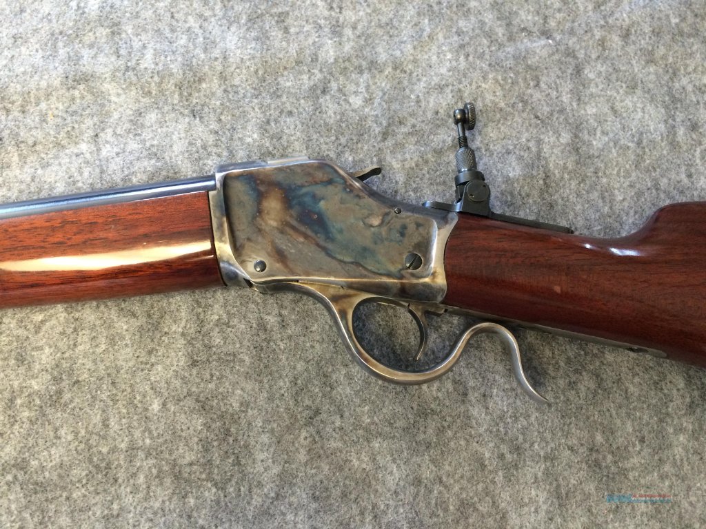

I am excited to get my High Wall and go full Quigley on it at the range. I don't see a 45-70 in my future. Just curious as those Sharps are really nice rifles for sure. If I can plunk a 12" target at 250 yds from 1 knee with a tang sight on my High Wall and a 45 Colt bullet, I'll be a happy cowboy.
