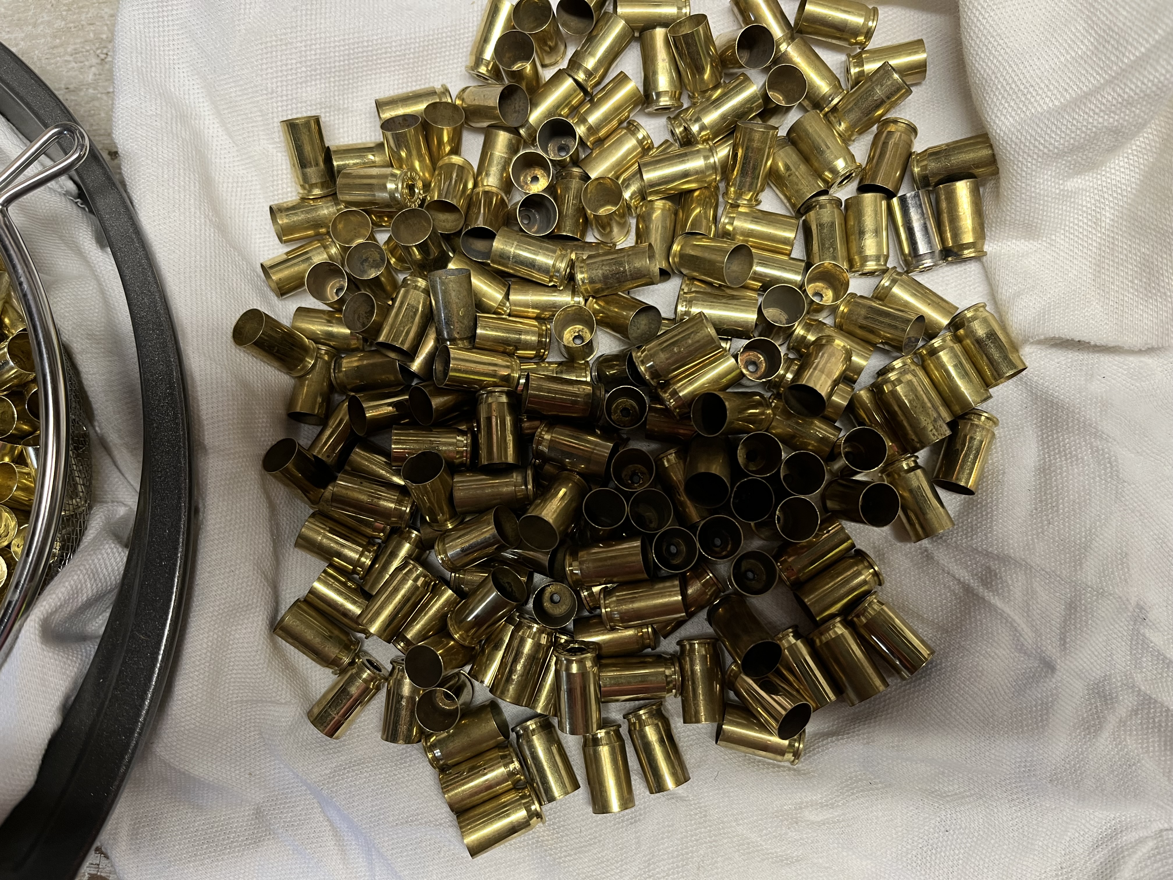

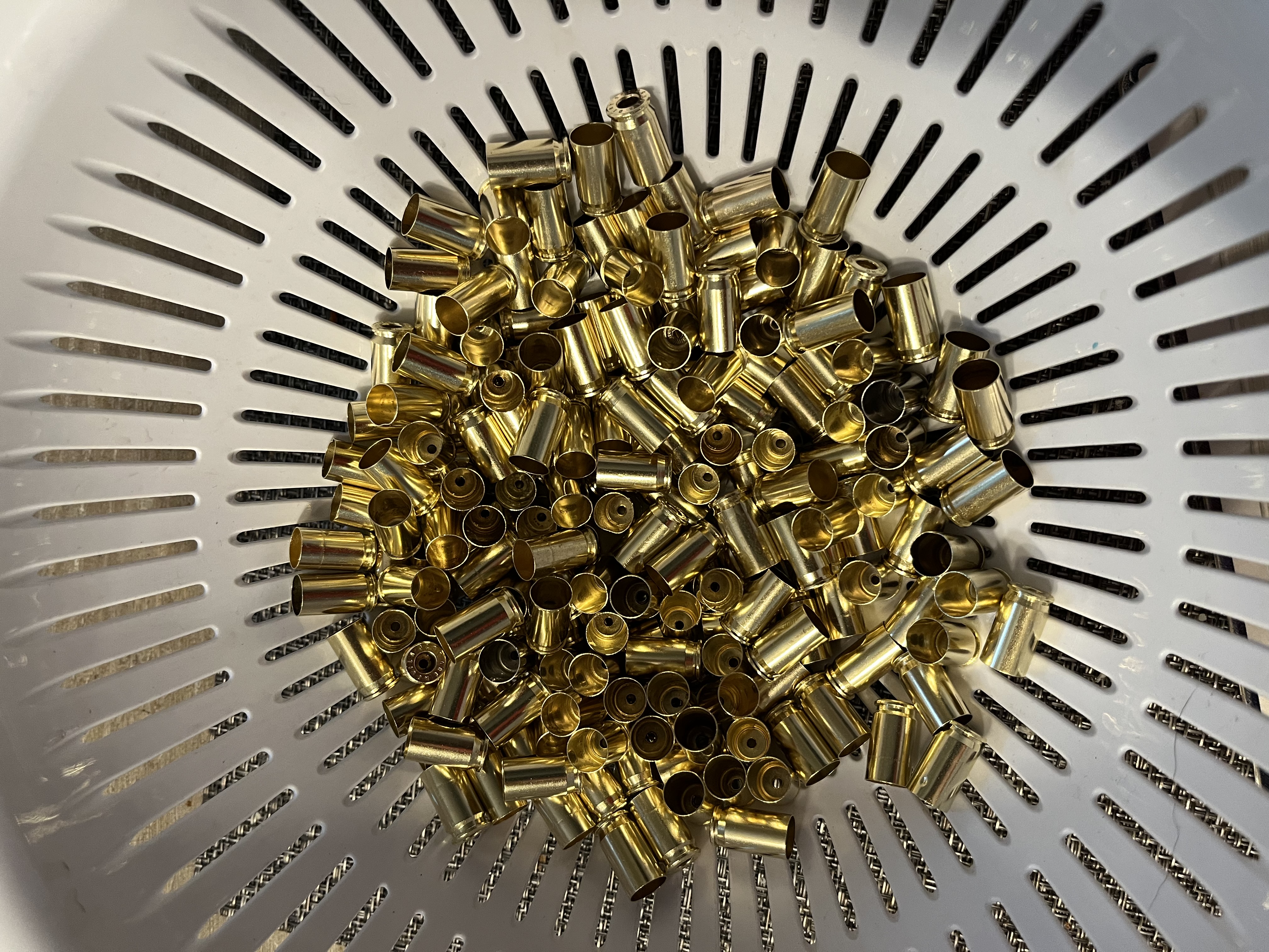

This project wasn't so much "At The Reloading Bench" as it was on the bench in the barn.
I built a wet rotary tumbler. It worked pretty well on it's initial tryout of around 50-75 .380 ACP cases; it definitely has room to to do many more of these or other, bigger cases. Holds around a gallon of water.
I did so few because I wasn't quite sure of my case weight-to-steel pins ratio. I need to find a scale to weigh this stuff, and buy more S/S pin media........
Oooops! :oops: I just noticed ya can't see much of the shiny "after" cases; mostly the "before" vibratory tumbled ones are visible. My bad. Hopefully, you get the idea...... :roll: I'll take another pic........

Looks like you got it mostly figured out. The brass looks good.

It plays now. That is quite the machine. You should have filed for a patent before posting the video.

Tumbler looks fine to my eyes. Innovation at it's finest.

The important thing to me is that it seems to work pretty well so far. That .380 brass came out lookin' like new inside & out. Anxious to try it out with the rifle stuff I reload for.
I do need to figure out a better "routine" or system for separating the pins from the cases. I have a tight mesh screen and screened colander, a 2 gal. bucket with a bunch of holes in the bottom for pins to drop thru (but cases don't) into a bigger 5 gal. bucket, my old deal I bought years ago for my dry tumbling media to drop thru while catching the cases, and stuff. It'll get resolved with more use, I reckon.......
I did discover that my old Machinist's magnetic base makes a good magnet for rounding up stray pins & such, so that helps some.
Like I said earlier, I'm just happy it works. I'll get the frame & base painted, and "refine" it a bit more as I go along....... ;)
