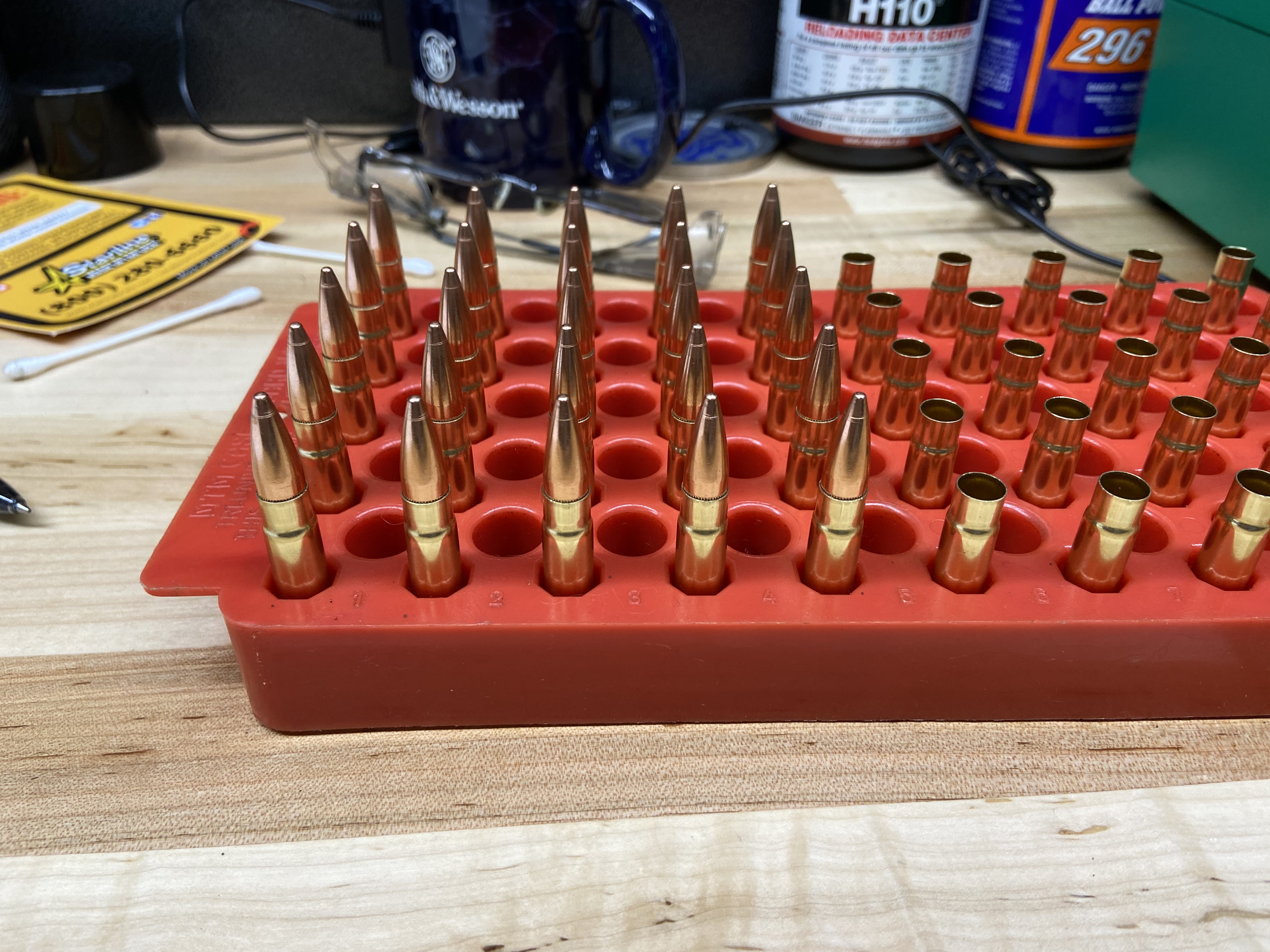

Yesterday I started in on my 300 Blackout project. Never had this caliber before so I’m starting from scratch. I deburred/chamfered and sized 50 pieces of brass and then loaded 25 for a powder test. I loaded five each with 296, H110, AA1680, 2400 and CFE BLK. I used the Hornady 125 gr FMJ and a powder charge in the middle of the range for each powder. I’ll group these and use the powder that worked best and then do a bullet test with the 110, 125 and 155 grain bullets I have on hand. After that I’ll do a charge test with the chosen powder and bullet.
Looks like I have a burr in the seater plug on my brand new Lee dies. I didn’t notice it when loading as I was more focused on the seating depth. I’ll pull the plug before loading any more and check. Funny, when I looked at the picture I took the ringmark on the bullet was the first thing I noticed.
