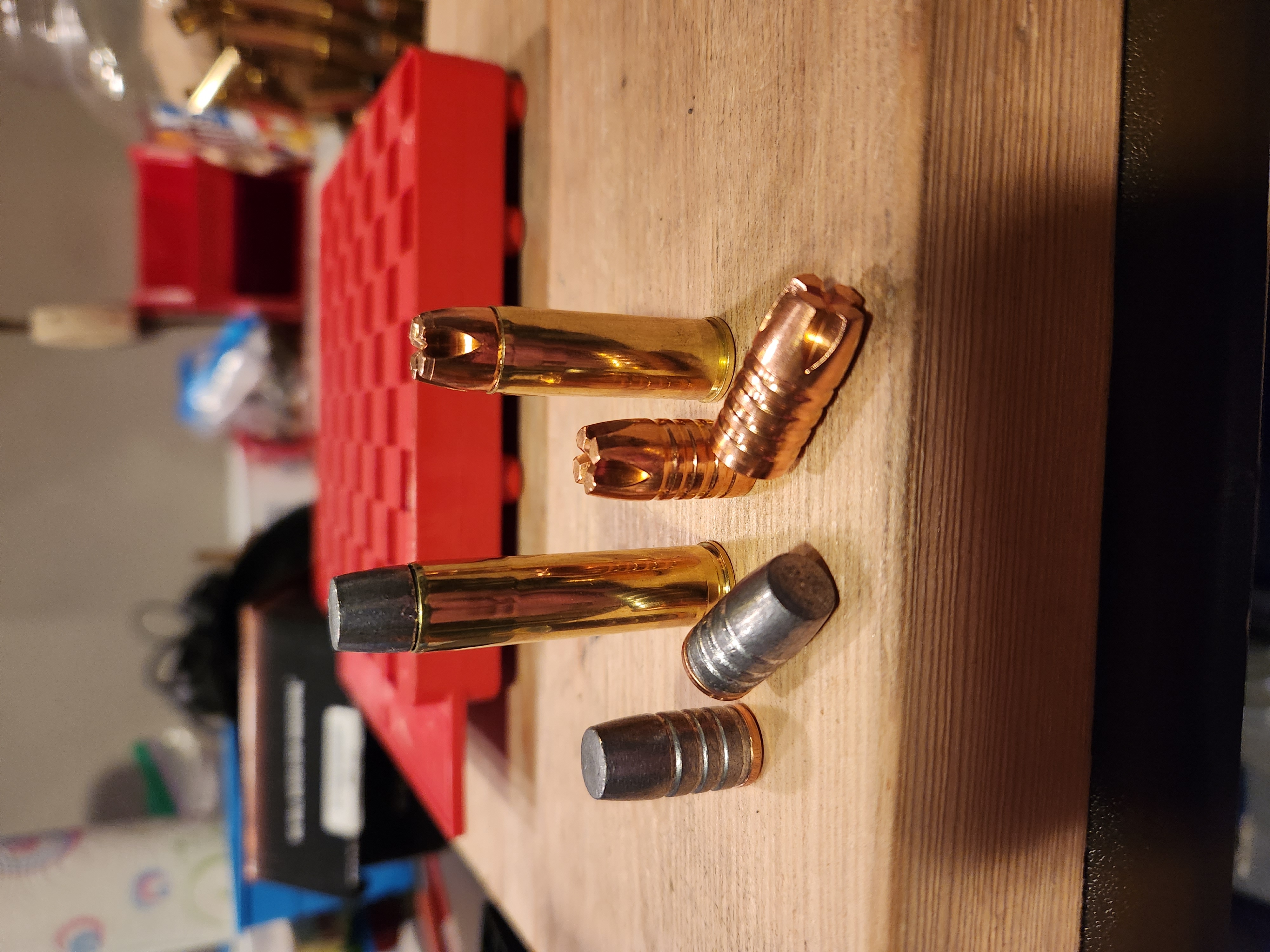

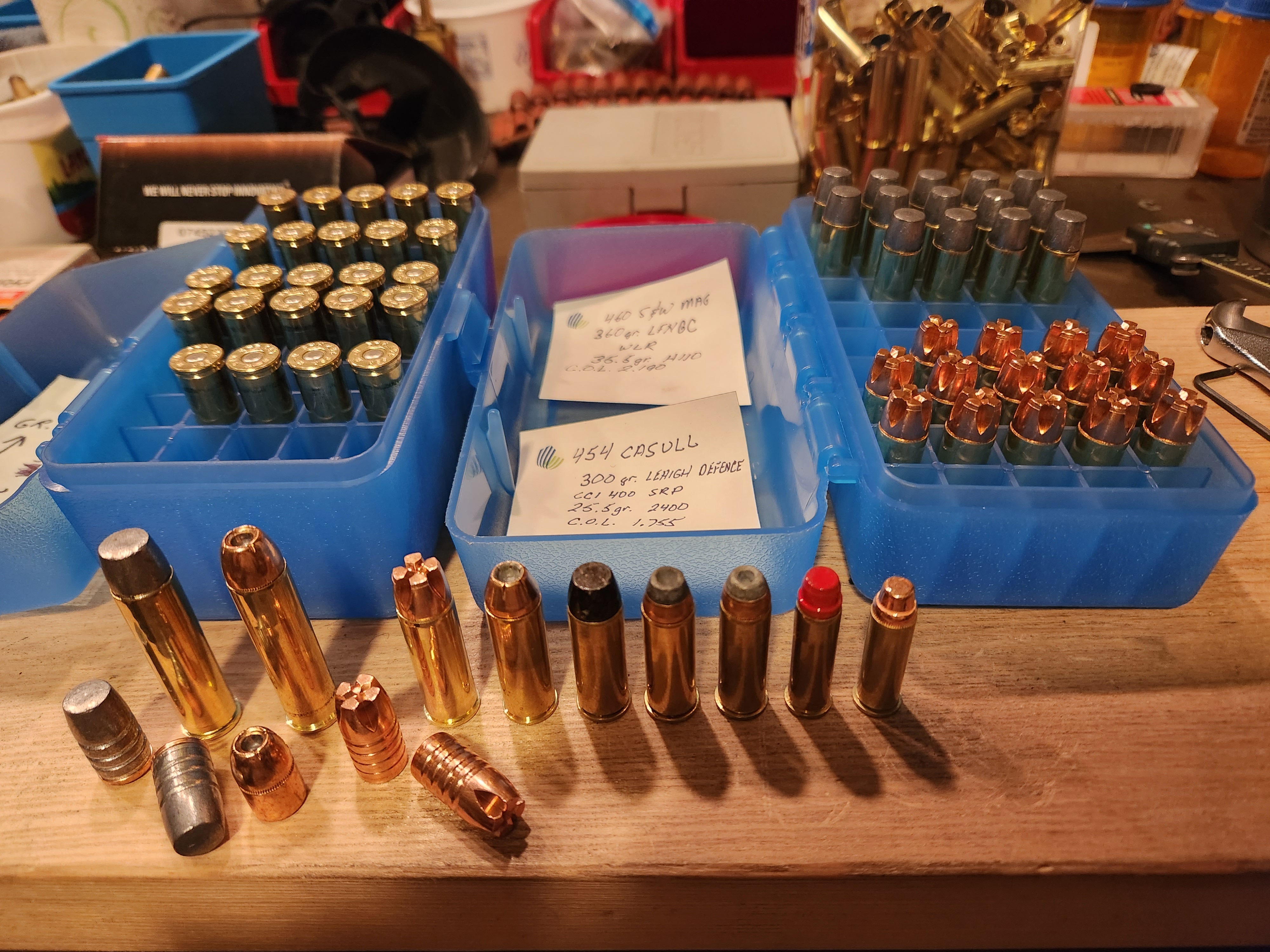

Looks like the game was going to be a blow out and the wife went to bed early so off to the reloading room. Put together a ladder load of 300 grain XTP and 15 360 grain WLNGC in 460 S&W Mag. Then 15 300 grain Lehigh defense penetraters in 454 Casull. Those 30 rounds were loaded middle of the road from the recipe data. Plan on running through these next Saturday, wonder if my wrist will hurt by the end of the day! All will be shot through a S&W 460 with 5" bbl.

Man, those Lehigh's are serious looking. With that profile, wondering on accuracy. Have you tried them before?

Post by dmanwarren » Tue Jan 10, 2023 5:55 pm
Rifletom, first time trying them. Might do a range report when it works to run them through. Oddly enough the 300 grain only has load data in 454 Casull. I was going to load them in 460 but could not find reliable data.

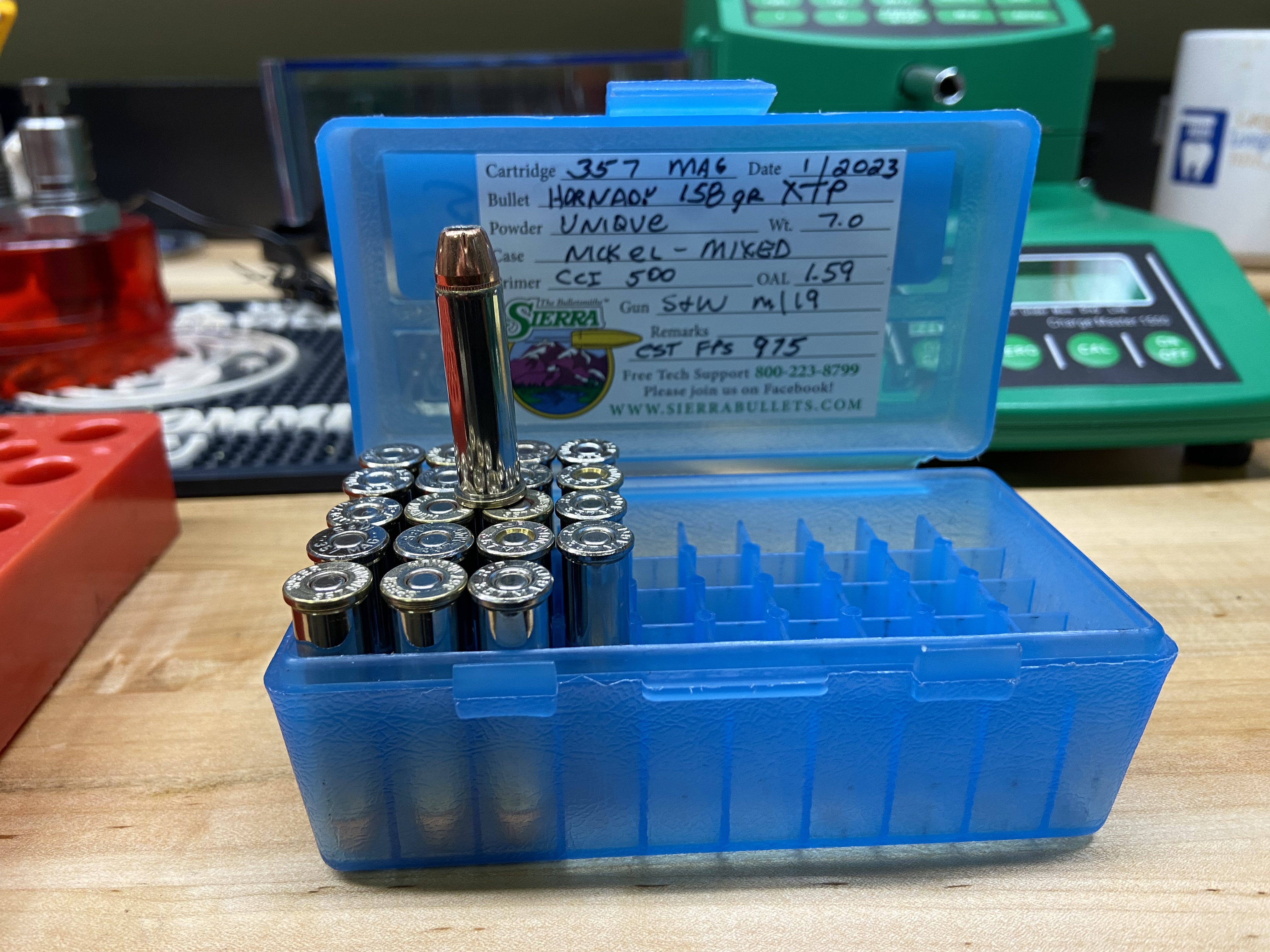

Loaded up 20 .357 cartridges for use in a Smith K frame. I used 7.0 grains of Unique and a Hornady 158 gr XTP. Way too much bullet for what I want and this load would be better served with a plated or coated bullet but the XTP was all I had on hand. Velocity should come in around 950 - 1000 fps. I have a buddy who wants to shoot his new pistol so hopefully we’ll meet up next week and the indoor range. If I like this load I’ll probably pick up some cheaper bullets and load some more up. I used the nickel cases to keep these low velocity rounds separate from my standard loads.

Post by runnin n gunnin » Thu Jan 12, 2023 10:29 am
Hatch, I use the same load (and XTP) for my .357 pistols. I also use the Nickle for my pistols only and brass for my Henry loads to keep them separated. Looks like factory new !
Good to hear, I’m looking forward to unloading the cases next week. I took a look at Berry’s plated bullets and read they can withstand velocities up to 1250 fps so this load should work great with the Berrys. I have loaded up a bunch of Berrys in 38 special cases (still have some) but I’m out of them. I’ve seen them around locally so next time I’m in the LGS that stocks bullets I’ll pick up a box.
