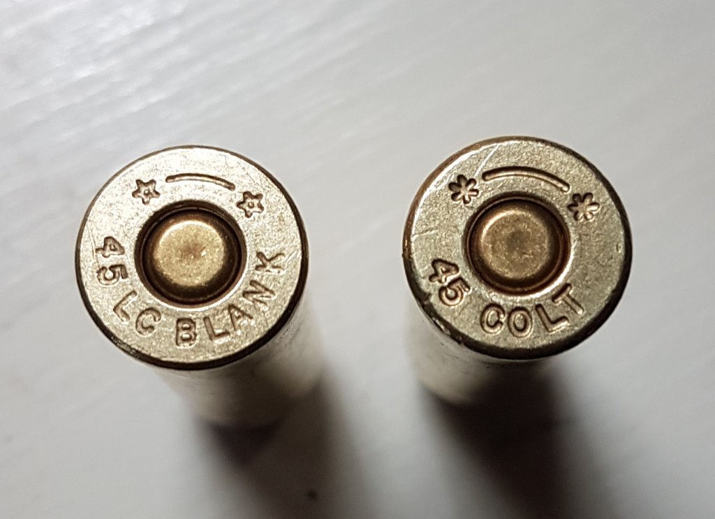

Reloading tonight and saw this. First one I have seen in hundreds of reloads and never noticed on factory rounds. "Blank"?

Do NOT reload this case or cases marked like it.
https://www.starlinebrass.com/brass-cas ... ANK-brass/

Thanks!....it was in a factory round cuz that is where All my brass came from. Weird. Must have shot fine first time around.
This is one reason to inspect each round, which I do.
Primer sounded strange during de-priming...made a distinct Ping sound...

Nice catch CT and RR. I would throw that one away also

Either this case is mis-stamped or it actually is a blank case with the larger flash hole. Either way, unless you're running right on the ragged edge of allowable pressure it'll still be fine. There are a lot of variations between manufacturers that equal this difference yet few people pay any attention to them. As an example, 45acp is loaded with both large and small primers and over as many as 4 different flash hole sizes. And in 5.56 there are differences from every manufacturer and even between examples from the same manufacturer. When running at pressures less than max most will never know any difference. This is why I never push the edge on pressures other than on one of my bench guns. Besides, best accuracy is usually achieved below max anyhow. I do have one bench gun that begs for more but it is a strange duck.RanchRoper wrote: ↑Tue Jul 02, 2019 9:51 pmReloading tonight and saw this. First one I have seen in hundreds of reloads and never noticed on factory rounds. "Blank"?

I would at a minimum contact the Mfg. of the ammo and send them the pic and ensure they know it was from a box of new ammo.it was in a factory round cuz that is where All my brass came from.

Black Hills maybe but not sure.
Ok, I think I figured it out. Very unlikely it came in a box of factory ammo from Black Hills. However, when I bought my 1860 Henry, my dealer gave me a free box of his reloads. He participates in cowboy shootings for entertainment shows, parties, events, etc. They stage fake hold-ups, etc.
They shoot blanks. So the box of 50 he gave me probably had this brass in it. I am on the lookout as I reload to catch any others and I'll mention it to him. He reloads on a big Dillon press and may have just missed one. I read that the issue with the large presses that crank out hundreds of rounds quickly can be difficult to inspect each round. Or maybe he has had no issue with loading live rounds with this brass and didn't think anything of it.
Whatever; I am not making live rounds with it. Thanks for the info CT.
