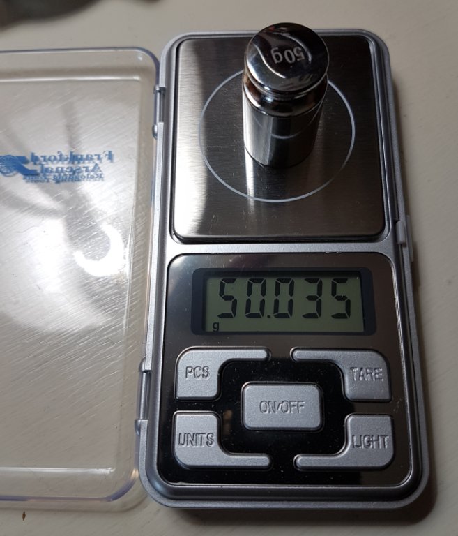

Post by RanchRoper » Tue Jun 11, 2019 8:58 pm
Anybody else have issue? Scale won't weigh correct. This weight is 50 g.
New batteries. Varies from .020 to .035
Worked fine until today.

Post by JEBar » Tue Jun 11, 2019 9:09 pm
does it have a way to calibrate it ?
Re: RanchRoper's Reloading Ruminations
Post by RanchRoper » Tue Jun 11, 2019 9:14 pm
Not sure...it has instructions somewhere, just have to read it. Might go back to Lee scale if this is not reliable. Not a fan of electronic stuff anyway.
Post by RanchRoper » Tue Jun 11, 2019 9:20 pm
ok....just have to calibrate it. Bear with me guys, if it doesn't have a mane & tail, it's greek to me.

Post by Ojaileveraction » Tue Jun 11, 2019 10:43 pm
Make sure there's no powder in the works.
Would happened with my Hornady digital scale
Post by BigAl52 » Tue Jun 11, 2019 10:51 pm
There has to be a weight to calibrate it. Its not off that much

Post by clovishound » Thu Jun 13, 2019 12:42 pm
With the units in the G setting push and hold the units button until CAL displays. Release the unit button. push the unit button once more. You should then get a blinking 50.000 display. Place the weight on the scale and it will do the rest, giving you a pass indicator and then goes to weight readout.
Sounds more complicated than it is. You should check the accuracy with the check weight every session, and recalibrate as necessary. It takes very little time to recalibrate this unit.
