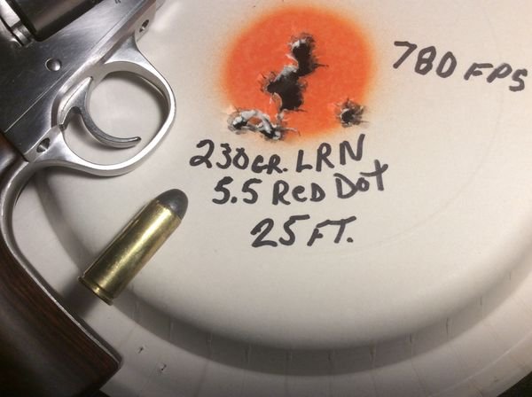

Think you will like it! Here is a .45 Colt load using Speer 230 gr. LRN I was testing for my Remington 1858 when using conversion cylinder.
The test revolver was my Ruger BH Bisley and makes a nice mess out of a paper plate from 8 yds.

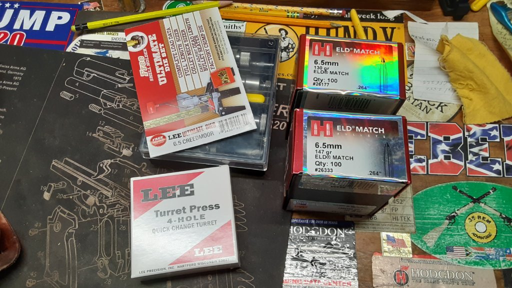

Getting ready for a new project. 😉
Man these are some Long boolits 😅
Got brass ordered.

Nice, new turret plate, new dies, 6.5C, looking forward to the load.
Post by BigAl52 » Thu Jan 13, 2022 8:39 pm
Uh oh must be a new gun to go with that ammo

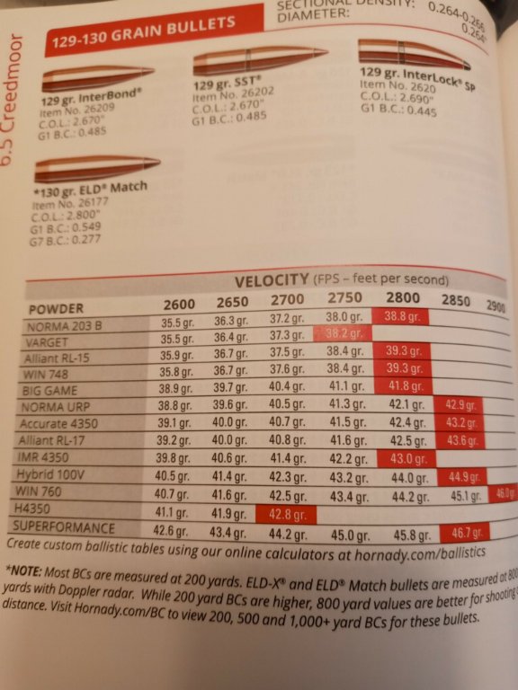

Tom, my first time in this rodeo...
Seems either of the 4350's are good, but I don't have enough to amount to anything.
A local guy, hmm, 35 miles one way, had some A 4350, and the new Hodgdon manual has data for it.
So I may skip down there tomorrow and grab one.
H 4895, and Win 748 are a couple I have on hand to try.
Varget, which I've never used.

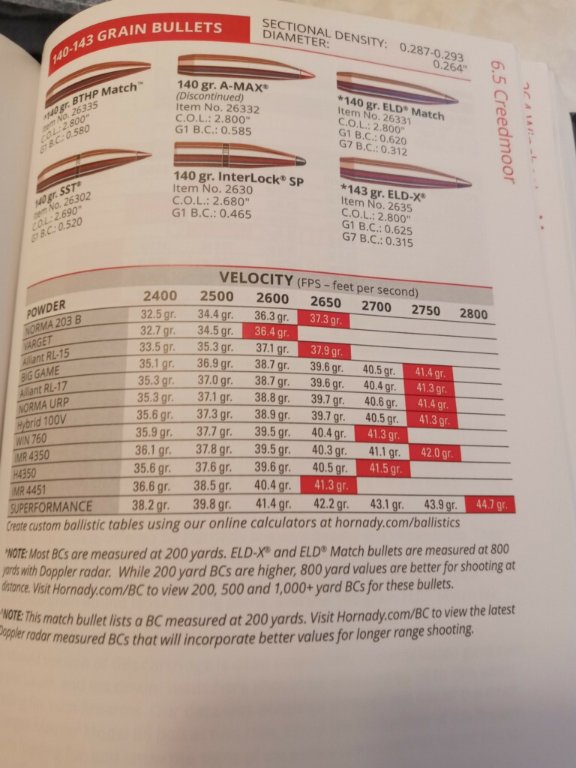

Startin to collect a good assortment of these Hornady bullets guess it's time to buy one of their manuals. :o ;)
A buddy of mine in St. Louis sent me this earlier.

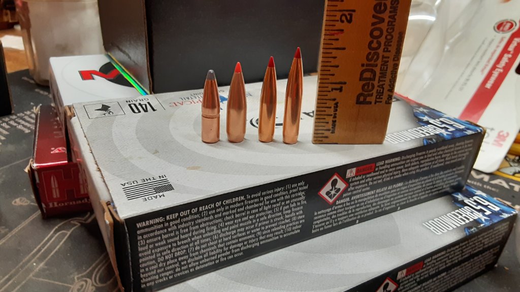

But I'll say these Creedmoor bullets are the longest thing I've ever seen. 😉🤣
Check 'em out from the left,
130gr .277
155 gr .308
130 gr .264 & Lord have mercy the
147 gr .264

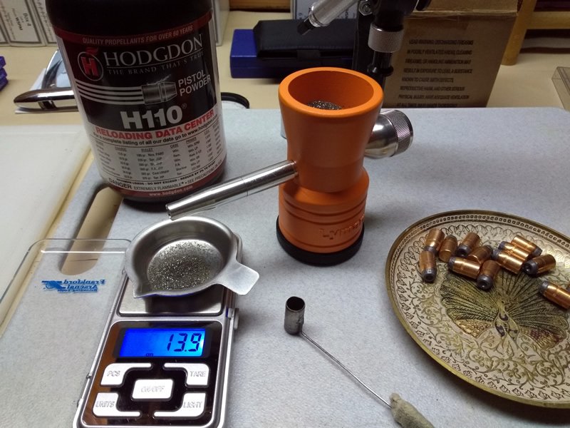

I haven't been shooting since early November, so I really don't need to reload. I still have several hundred rounds of 357s waiting their turn at the range. But like many of us, I enjoy reloading, so this morning I put up another fifty rounds.
Years ago, I settled on 13.9 grains of H110 under 158gr Zero JSP/JHPs for use in my handguns and rifle. At the time, I made a dipper (a modified 9mm case with a straightened paper clip handle) that scoops that amount much of the time. Occasionally, it's a tad more or less, but I always weigh each charge; so then I either trickle a bit more or remove a bit to get to 13.9 grains.
I have a Lee Single Stage Press. After charging the case, I visually confirm it before topping it with a bullet. Once all fifty are charged, I seat the bullets, then crimp and box them. Each round gets inspected after each step. It's simple and slow, but consistent.
Fortunately, my inventory of components is pretty good. I still have 1000 primed .357 cases on my bench and another 3K WSPM primers in the cabinet.
I really want to shoot again.
