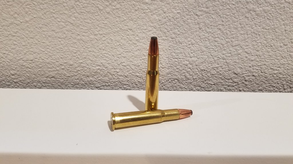

Post by Mags » Mon Aug 19, 2019 12:24 pm
Ya their 150 gr picture doesn't look like a .30-30. This is a picture of the 150s that I have. Sorta looks like your spire point but lopped off.

Mistered
Re: For you 30-30 Owners/Reloaders
Post by Mistered » Mon Aug 19, 2019 12:29 pm
Some newer, commercial FP 30-30 ammo has considerably smaller diameter flat points than ammo of the past in an attempt to make it as 'pointed' as possible yet still maintain safety from primer detonation.
Post by Mags » Mon Aug 19, 2019 1:31 pm
They also shoot better in my Henry than the traditional shaped .30-30. I also don't get the inner mag tube case rim hung up with these for some reason. I think the shape of the bullet maybe, but can't conceive of a reason why that would eliminate hang up.

Mistered
Post by Mistered » Mon Aug 19, 2019 2:21 pm
Possibly because of new brass, smooth rims and maybe slightly more rounded edges and possibly a bit smaller rim diameter.
