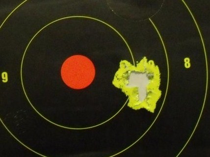

The best group I have ever shot with my marlin was 140gr FTX and Ar2205, 5 shots went a touch over .5 at 100y on centers.
Proved to be a total fluke and the FTX a waste of time as far as Im concerned in 357. I love them in my 30/30 but the 140gr in 357 eat a heap of powder space to get a length to function. Result was I could only get the enough powder in to match 158gr velocities, the BC on them is actually worse than the 158gr and accuracy ended up averaging around 2" @ 100y.

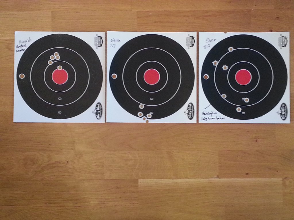

Although I currently do not own a Henry, I'm helping a friend dial in some reloads for his newly acquired Big Boy. I'm a believer of using suggested loads as a starting point from one of the many hand books. And currently find myself using the Modern Reloading 2nd edition by Richard Lee the most. But I follow up every different load thru a chronograph. We went with a 158 JHP from Everglades. First load was conservative using 13.9 gr of H110, CCI 550 primers, mixed brass with an OAL of 1.580. Average velocity of 10 rounds was 1425. Next load was a jump to 16 gr with an average of 1700. I also ran 7 rounds of a Federal 158 FMJ for a good base line at 1750. Both loads seem to be comparable concerning accuracy, but the hotter load was more fun! Downside was, we went thru a pound of powder in around 400 rounds. I also ran both loads thru my SW 686, 6" barrel with a velocity of 1200 and 1500. Will probably be working on a 38 special load using a 158 gr plated bullet at around 1100 for general plinking to have a cheaper round to play with. Really like the Henry and need to add one to my collection

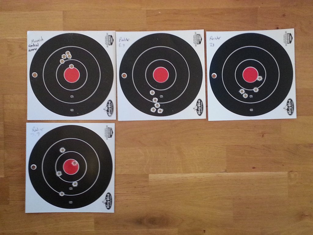

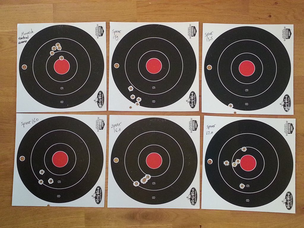

I've found that less than max load IMR 4227 and less than max load of Unique work well for various 158gr loads. I got a larger pattern when I approached min or max loads. Desperately want to try H110 or 296 but no magnum primers are available locally. I can't try 2400 with standard primers because that powder is not available locally. I am not able to buy bulk powder or primers with hazmat and shipping fees to make that worthwhile. Someday I'll stumble on a place that carries the right combo of powder/primer. Attached is an experiment of trying to find a load that could match Monarch 158gr at 50 yds. The upper left target is the Monarch control group. You can see that the spread changes as you change powder amount. I am not approaching the Monarch velocity (POI) yet.
- Speer 4217-IMR 4227.jpg (168.94 KiB) Viewed 3877 times
- Ranier-Unique.jpg (135.31 KiB) Viewed 3877 times
- Generic JSP-Unique.jpg (136.34 KiB) Viewed 3877 times
