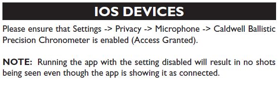

Did you see this in the User Manual?
IOS Devices.JPG (32.24 KiB) Viewed 3295 times
Yeah, I saw that in the manual, and in a couple of other videos on the Caldwell app where folks had varying degrees of success connecting a phone to the chrono. I even called a Caldwell Tech Support guy and talked to him about this. He was nice, but his "solution" didn't work for me. I did indeed have the microphone turned on for the Caldwell app.

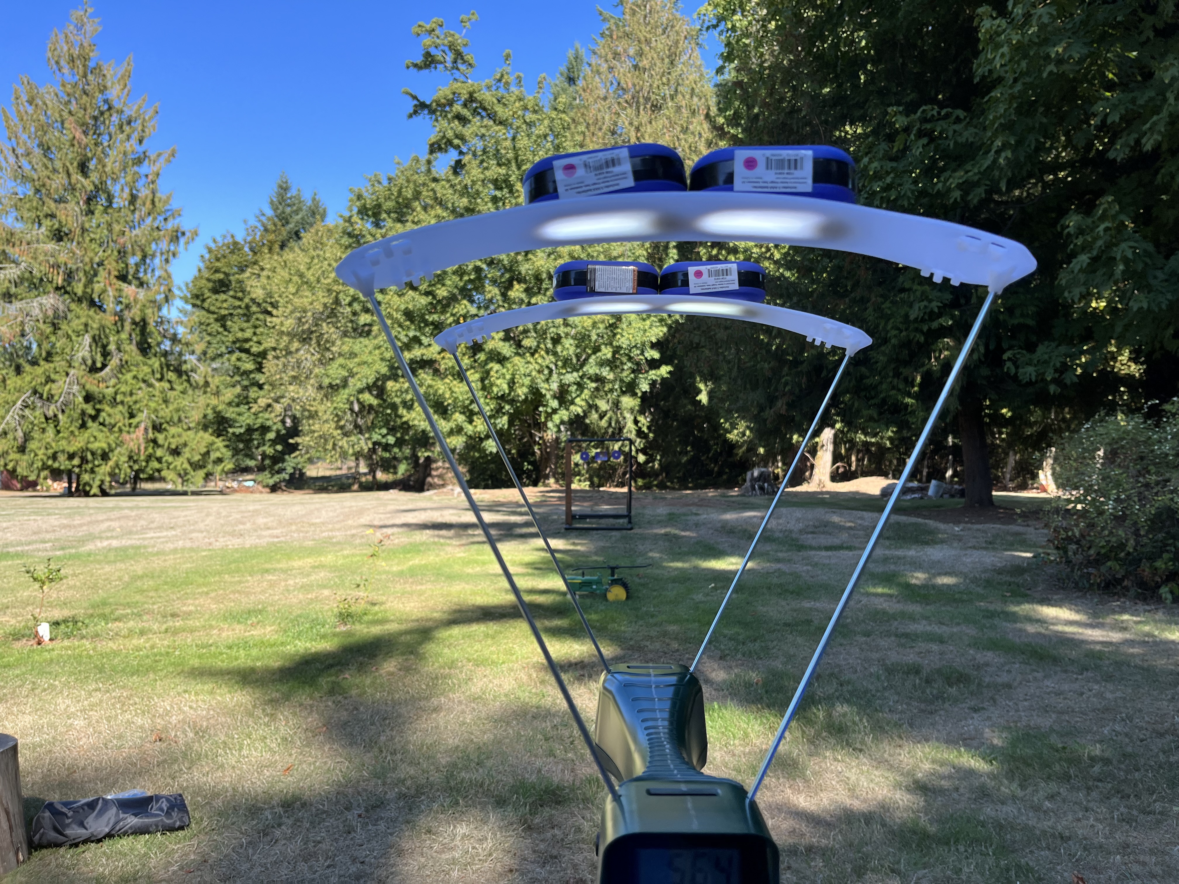

Played around with the Caldwell in the shade today. The barn and trees do a great job of blocking the early morning light (10:30-ish), and preventing the chrono from being able to read BBs from the Umarex lever rifle. It either won’t read anything at all, or it gets error codes. It would do the same thing with arrows, rimfire, and center fire rounds as well, if I could shoot them at home.
I’ve seen a few videos with low light or indoor shooting situations where some clever folks came up with cheap solutions, like this guy shooting Nerf guns indoors.
https://youtu.be/oaJXJi2lgOE?si=pb8GO0eND9qJWeUp
Most of these folks are trying to beat the issue of using this chrono under fluorescent lights, which the Caldwell instructions say is “No Bueno”.
Turns out their solutions kinda work outdoors in dark shade. I used a couple of cheap Harbor Freight LED flashlights just sitting on the sun shields with a little success. I should mention that Caldwell includes a lighted sun shield kit with their “Premium” level kit, and will sell that setup separately. So they know there is a bit of an issue there. But their kit’s a bit pricey. There are less expensive solutions.
It didn’t totally eliminate all error codes, but was probably in the 80% effective range, I’d guess. Some of the errors may have been induced as the sun traveled and it got into some “sunlight and tree limb” moments. Again, this is mentioned in Caldwell’s instructions as not working out too well. My cheap setup might’ve worked even better if I’d taped the lights to the underside of the sun shields as others have done.
After the sun moved a bit more, around noon, the chrono worked just fine with the natural light.

The photos in the link kinda confirm what I was attempting to do with my HF flashlights, also. I wanted to try to rig up an LED strip on each sun shield like he did, as I'v seen others do in various youtube vids. I have seen a vid where a guy double sided taped similar LED puck lights underneath the sun shields, then uses a remote to turn them on/off. What I like about the LED strips is that there is less underhang beneath the shields. Probably would help keep them from being accidentally shot. But first I wanted something cheap and easily reversible to try out, just to see if I was even on the right trail. :)
