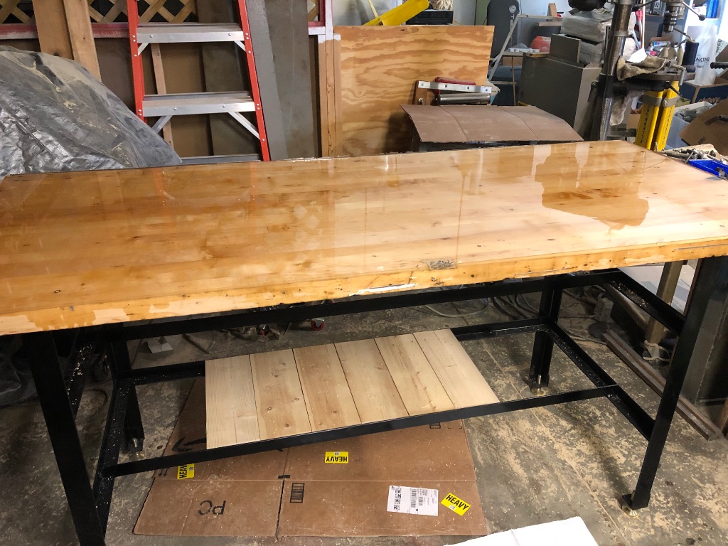

Taking a vacation and got back to the bench. Decided to use what was the bottom of the butcher block for the top and I wasn't as careful sanding this surface so I am having to spend a lot of time getting an acceptable finish. I have decided this has got to be maple it is soooo hard but the surface is smooth as glass after 100 grit paper. This will take a long time but I will get it done eventually.
Posts: 2542
Re: My reloading bench project
Post by Ernie » Sun Jun 12, 2022 11:08 am

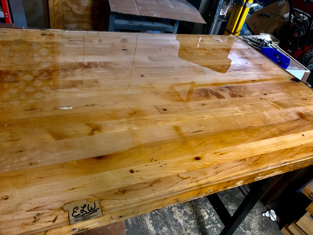

I got the frame painted, re-installed the leveler/swivels, finished sanding the butcher block top and installed that. Then leveled the bench placed a dam around the edges, and applied a seal coat of Top Boat epoxy. After 3 hours I poured on around a gallon of the epoxy, spread it and used a torch to get rid of the air bubbles. The epoxy worked out well it is about 1/8 thick. Now that I have removed the dam I am going to sand down the top edges to a radius, sand the outside edges and coat with some polyurethane. After the abuse it received from welding etc I think it looks pretty good. Was pleased to save it. Getting close.
PS, I had to fill a section with epoxy filler and decided to place my initials on it for they heck of it.

That looks fantastic

You know Ernie, I'm afraid I would move the bench to the kitchen, its way to pretty for my load bench !

Looks good Ernie. Id almost not want to drill holes in it.

I had to use the pour on finish to level the top because it was not completely flat due to age and abuse so I figured I might as well make it look good. I took the time to sand it down and let the wood grain show off a bit.

Good job on the finish. It really looks nice. Be sure to show us when it's all rigged up. Don't scratch it! :D

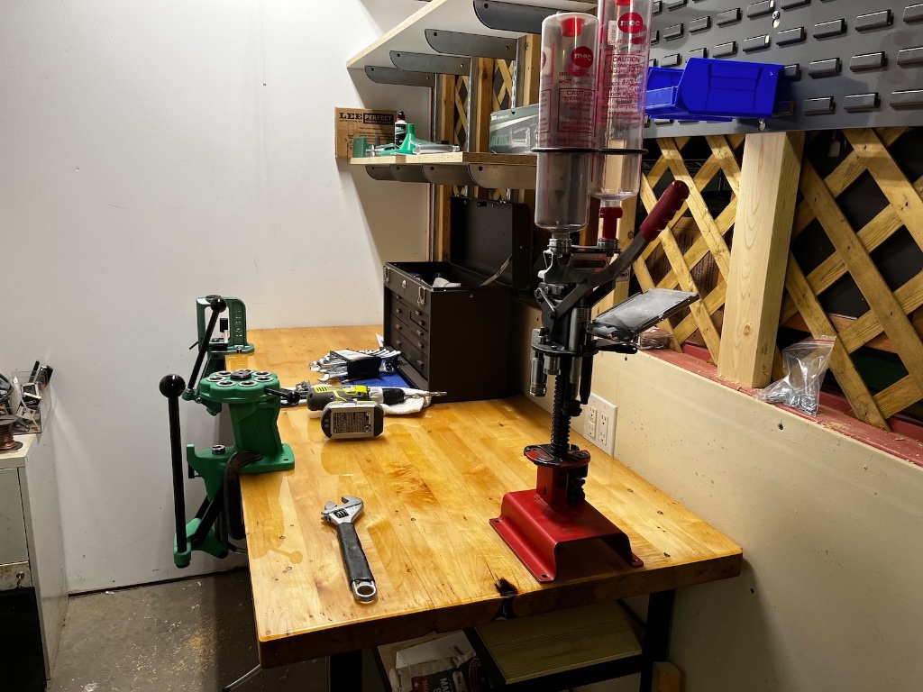

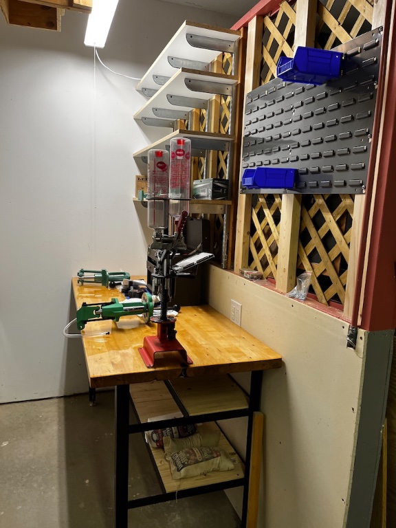

Mounted the Rock Chucker, Redding T7. and MEC Size Master 12 gauge presses. First photo shows shelves, hanging bin hardware and where I was going to mount presses and second photo is where I actually mounted the RC and T7. The MEC is mounted about 4 inches left of where it is shown.
Have more stuff to take out tomorrow and put in tentative place.
