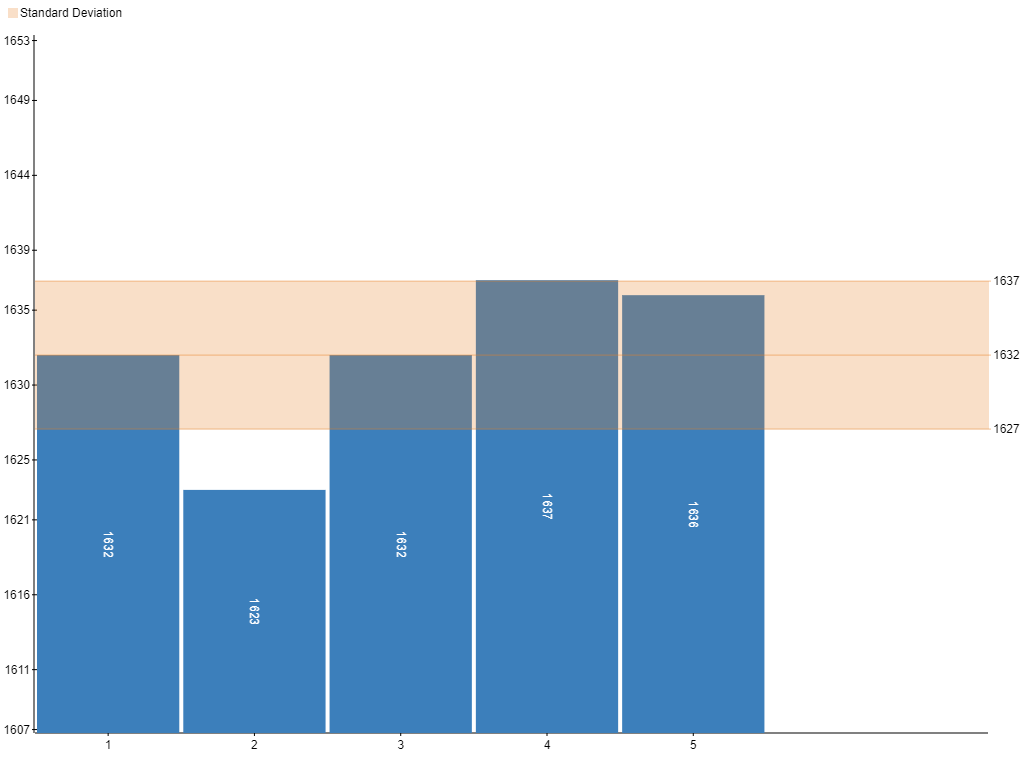

Below is the Chrono data. Muzzle velocity ran between 1,627 and 1,637 and averaged at 1,632 FPS average power factor of 663 with the H332 and the Missouri Bullets.

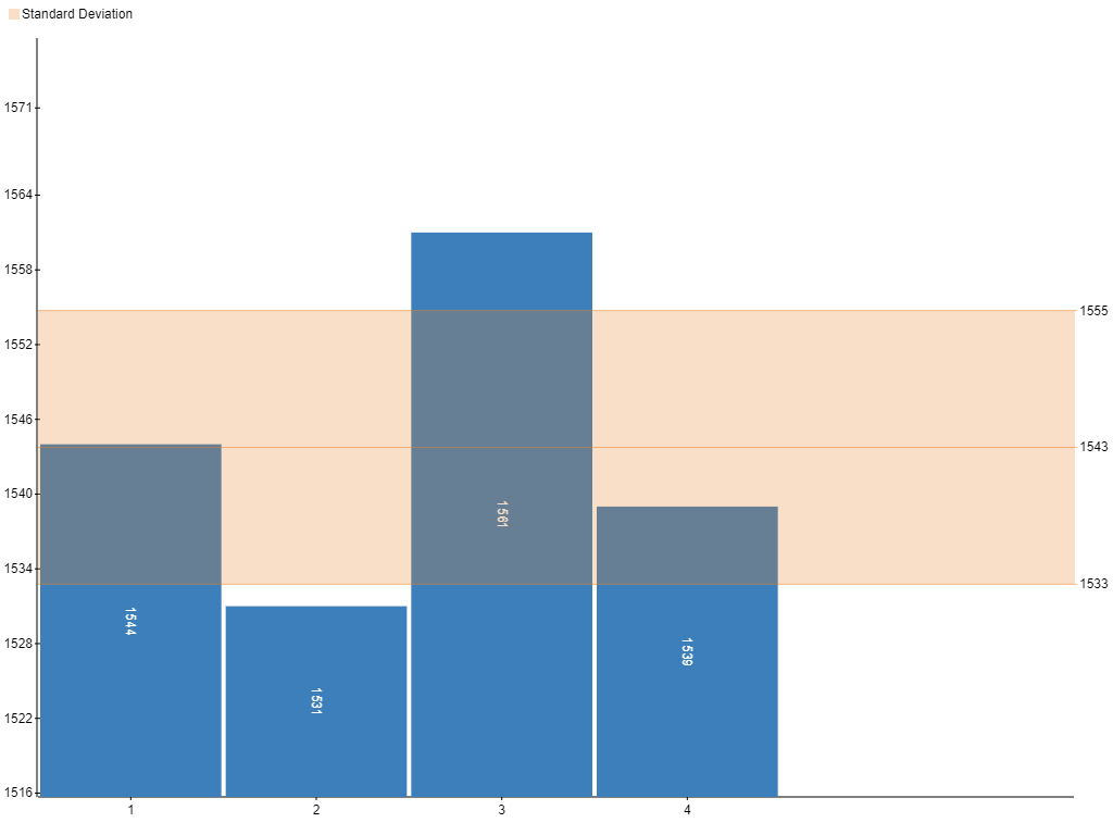

Below is the Chrono data for the 4198 with Missouri Bullet. Muzzle velocity ran between 1,533 and 1,555 with an average velocity of 1,539 FPS with an average power factor of 615.

Thanks rng, looks like you're getting nice tight groups with this bullet/powder combo
gotta feed the barrel what it likes

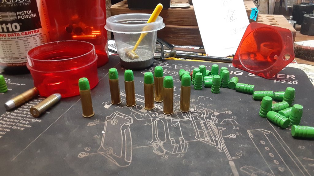

Just finished with some heavy 41's for a little deer hunting action.
Some 276+ gr WFN over 17.5 grs. of H110.

Well it's red or green, I did them in red first time. Then I did a bunch of 44's in red, so I decided to go green on the 41's this go around. 210's and these whoppers. A 270 gr mold this last batch ran from 275 to 280.
