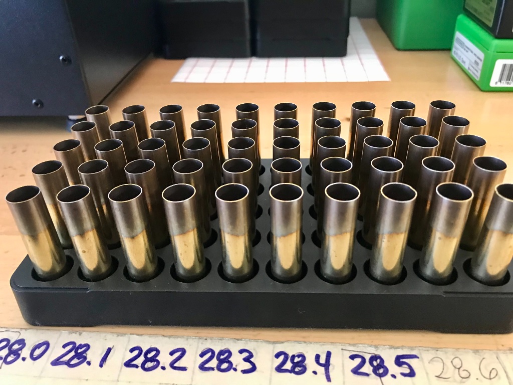

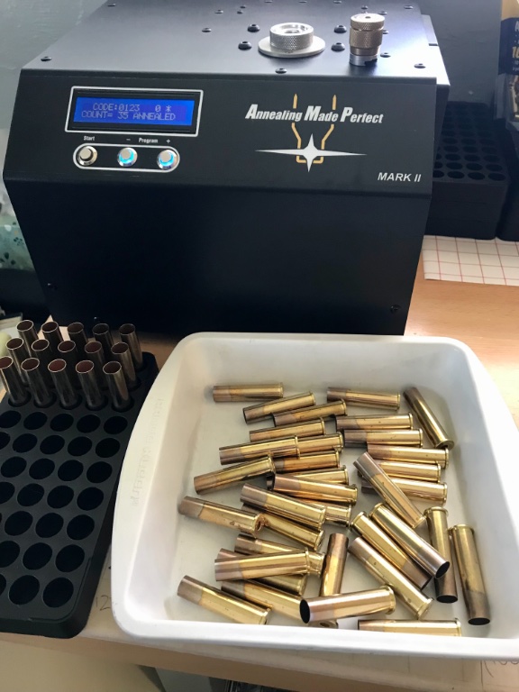

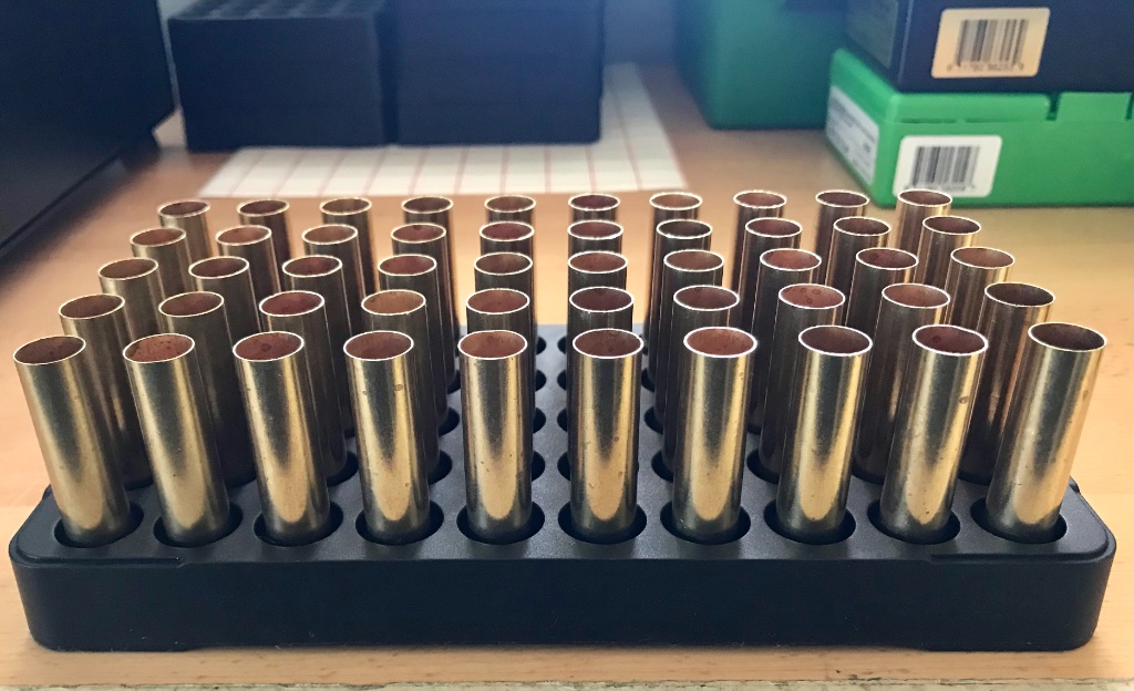

Getting my Starline brass ready, still waiting on projectiles
First time handloading for .45-70 Gov
The only government I trust is .45-70

Those cases are looking good!

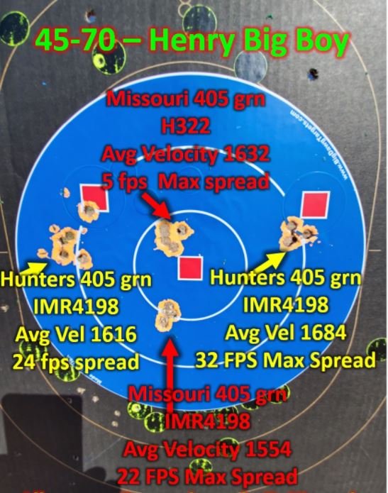

Hey quest, don't worry about tying up the thread, this is what its for.
Below are some results of my loads for my 45-70. All were 5 round groups shooting at 50 yards, iron sights, bench rest position shooting 405 grain bullets.
Between Hunters and Missouri Bullets, I favor MB hands down (you will find a lot of the members use MB). You can see that I had tighter groups with the MB than Hunters.
I load either IMR4198 or H332 with pretty equal results and to this point really don't prefer one over the other, which gives me some nice flexibility for available powder. (I dropped 36.5 grains of IMR4198 and 43.5 of H322 for both bullet types)
So load em up and let us know what the results are !
