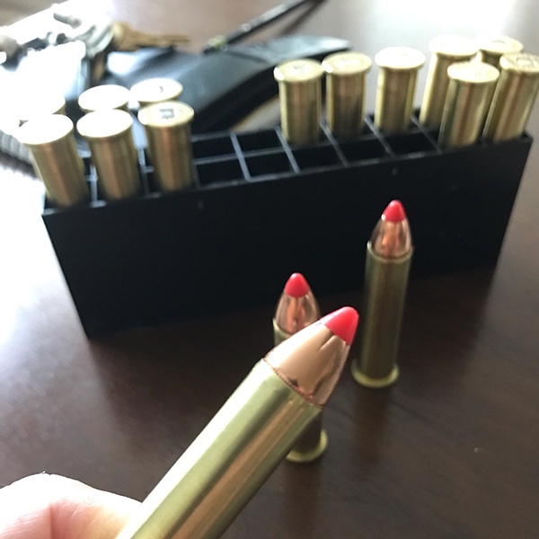

The RCBS cowboy dies work great on the Hornady shorties!
shorties IMR 4895 IMR 4198.jpeg (140.2 KiB) Viewed 1304 times
RCBS roll crimp.jpeg (102.11 KiB) Viewed 1304 times
I'm taking these guys to the range today...
black ringed primers are IMR 4895 (1400 fps I think) and the others are IMR 4180 (1800 fps)
There was just enough room for that length
