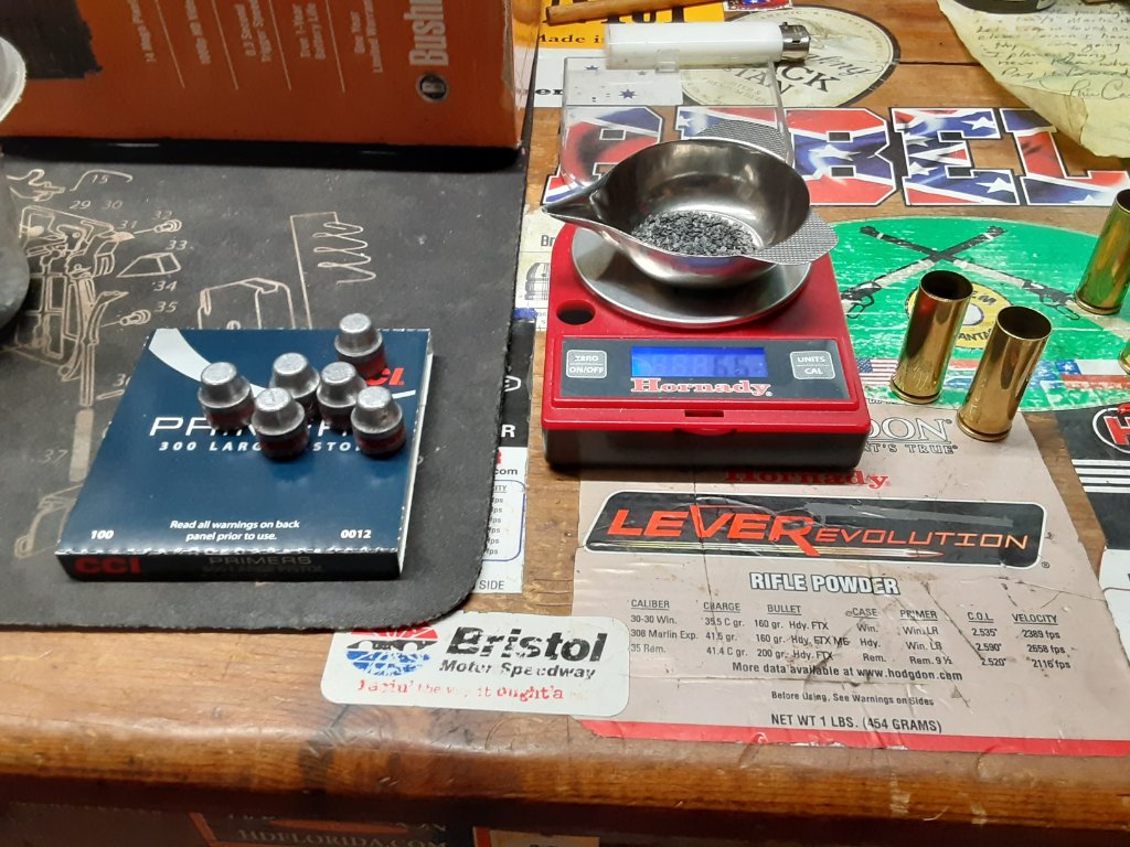

Post by Vaquero » Fri Jul 16, 2021 7:40 am
Got another 165 pieces of 45 colt brass sized and primed last night.
May load some tonight and need to load some 38-55's, got a notification that my sight should be here Monday.

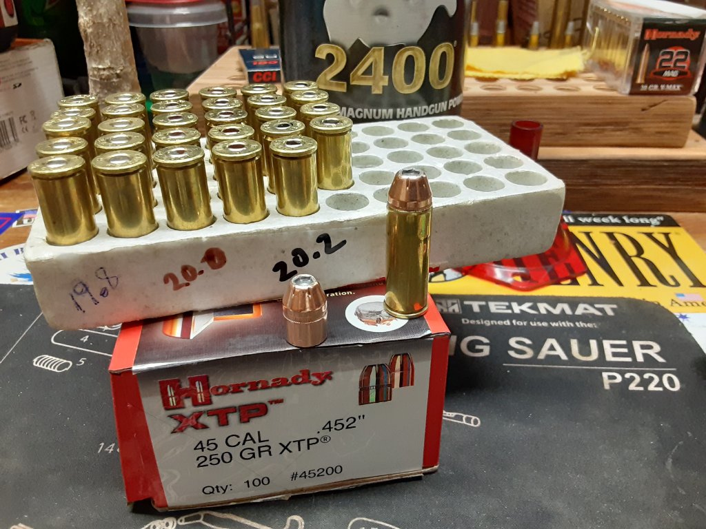

Hey Al, putting these to a test later.
Got a good friend just south of St. Louis picked up a Henry CCH in 45 colt and said these preformed well in it.
Checked data, between 19.7 and 20.2, with a very max. of 20.8 with extreme caution.
Going to see if the Cowboy or Rossi like either.

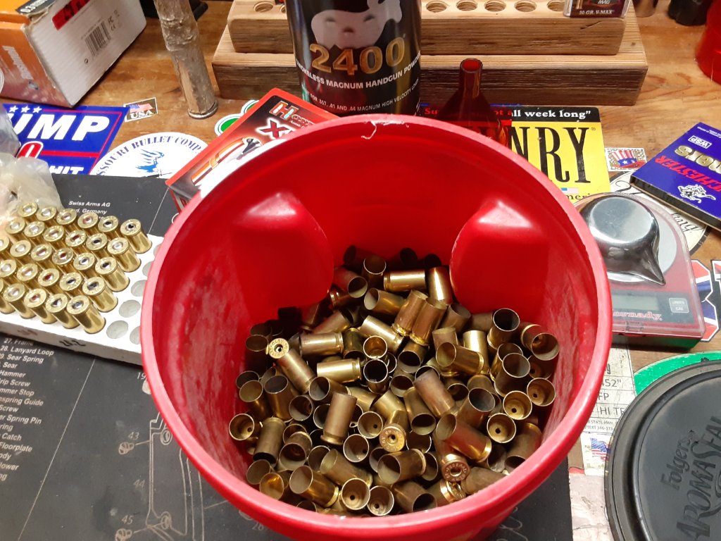

Post by Vaquero » Sat Jul 17, 2021 1:58 pm
Ifn I counted correctly, 212.
