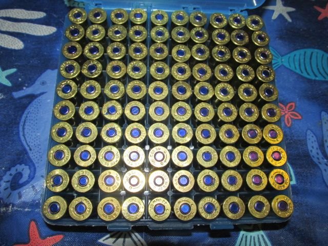

completed our first 102 round batch of 44 Special ammo for use in our Bond Roughneck derringer .... 101 rounds shown below .... couldn't stand it, had to touch one off as a test .... happy to say it passed the test in that when I pulled the trigger, it went boom, and didn't cause the slightest discomfort to my arthritic right hand .. :D .. the loads consisted with a mix of 240 gr Nosler JHP and JSP bullets pushed by 4 gr of Bullseye ignited by CCI Large Pistol Magnum Primers

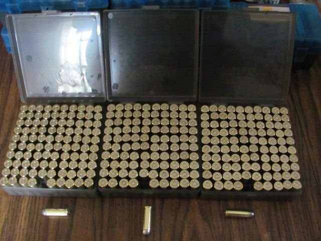

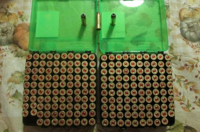

just put the finishing touch on our 44 Specials .... we now put together 3 different 44 caliber loads .... to ensure easy recognition we color code the primers .... we leave the primers of our 44 Mag, full power hunting loads silver (picture 1) .... Red is the color we paint the primers of our 44 Mag target loads fired from our Ruger Redhawks (picture 2) .... Blue signifies the 44 Special loads fired in our Bond derringer (picture 3)
191030 002 Redhawk Loads 002.jpg (82.69 KiB) Viewed 1471 times
210608 002 Blue for Bond 001.jpg (114.64 KiB) Viewed 1471 times
