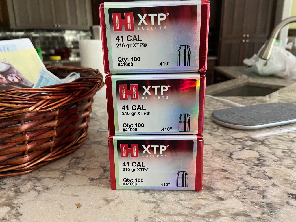

A local guy put these three boxes of 41 XTP’s up for sale at $37 a box and I managed to grab them before anybody else did. Not the best price out there but it seems like that’s what I paid last time I bought some at a store. I have another two boxes pending a trade with a guy who lives about three hours away. Fortunately he has a daughter who lives in Spokane that he will be visiting and we plan to meet up when he does so. (He’s busy planting now so this will have to wait).

Nice score Hatch.👍

Still waiting for that 41 mag range report with 2400 and those bullets

You and me both brother. :roll: :lol: And it’s going to have to wait even longer as we’re leaving for Montana Sunday. Maybe when we get back. :D
