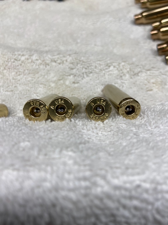

Do you find that pins can get stuck in the flash holes?
I've had it happen on 9mm & 40 S&W. Dont recall any on rifle brass.
Yesterday I tumbled about 70 cases, mostly 300 Sav but some 357 and five .223. Out of these I found one 223 and three 357 cases with pins in the flash holes. None in any of the 300. I don’t think that if I ever miss one that I will set off a primer when seating it since after cleaning I still have to size. My sizing dies still have the de-cappers in place so even tho I de-cap with a Lee Universal De-cap die prior to cleaning the sizing step would remove the pins. (I hope) :D

Hatch, the experience I've had with stuck pins, is they are usually stuck pretty tight. While you may push them out recapping, the decap pin may just move to the side.
Another scenario to consider, although the primer probably won't detonate, the little pins may damage the anvil.
Can't guarantee any of that, but I wouldn't risk it myself.
My stuck pins, I remove with needle nose pliers, or sometimes drive them out. BTW, all flash holes aren't the same size.

That’s what I do also. Sometimes I have to use a small drift to press the pins above the primer pocket far enough to grab them with the needle nose. I don’t know if I ever had a pin in place when seating a primer but I haven’t had a miss-fire from a mangled anvil. I switched from the dry media vibrator type cleaner to the wet tumbled pin type about two years ago. More work and a bit of a pain rinsing and drying but the results are well worth the effort.
