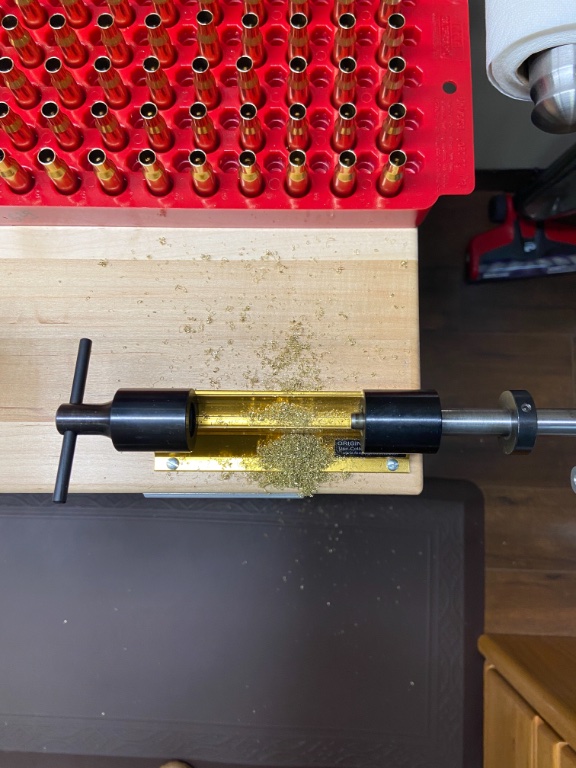

Continuing with my 7.62x51 loading project I made an interesting observation today. As I will be shooting this ammo in my M1A which is known to be sensitive to reloads I’m taking my time and being very carful. This is my first venture into loading for the M1A.
I’m using commercial brass which was factory loaded to military specs. I have Lake City brass which was from both Federal and Winchester 7.62 ammo and some brass from CBC (Brazilian manufacture) 7.62 ammo. All this brass is once fired as factory ammo only. Just to keep in my cautious process I checked the length of the brass and found it all to be .010 to .015 over the trim-to spec. In fact, the .015 is .005 over the length recommended for trimming. So I trimmed it to 2.005 as called out in both the Hornady and Sierra manuals. I trimmed 158 cases and I am flabbergasted at the amount of shavings I ended up. :o :shock: :D Sure glad I checked, in my reading it was noted that case length is critical in these rifles.

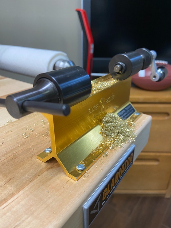

Post by runnin n gunnin » Thu Nov 19, 2020 4:59 pm
Hatchdog, is that and LE Wilson trimmer? If so its a whole lot prettier than mine !
Also, love the gladiator line of tool chests and cabinets.

Post by BigAl52 » Thu Nov 19, 2020 6:42 pm
Nope thats a forster trimmer. I love mine but hate that job. I put the drill adapter on mine Hatch makes that job a little easier.
runnin n gunnin
Posts: 796
Location: Arizona
Post by runnin n gunnin » Thu Nov 19, 2020 7:28 pm
Yup I did the same with the Wilson. Tedious, but it works great and is accurate.
Yours is still prettier than mine !
Posts: 7135
Post by Hatchdog » Fri Nov 20, 2020 10:36 am
Nope, as Al said it’s a Forester trimmer. I’ve never used a Wilson but I like the separate shell holder per caliber they use. The Forester is set with two set screws and can be a bit time consuming to get set up. Once set up it moves along pretty quickly.
Al, I’m going to look into the drill adapter you mentioned. Last night I thought I was getting a blister on my thumb from running the crank handle. Thanks for the suggestion.
That Gladiator bench is fantastic. My reloading room is in the basement and my stairs have a 90 degree turn. I purchased the bench from Sears and it came un-assembled and packed in a large cardboard box that I was able to take down the stairs on a hand truck. Assembled it in my room which worked out perfectly. I ordered the optional back piece which comes with seven outlets and keeps items from rolling off the back of the bench.

Post by BigAl52 » Fri Nov 20, 2020 10:45 am
https://www.forsterproducts.com/product ... -trimmers/ Here you go Hatch. I use a Makita drill on mine. Light weight with a lithium battery works great no sore fingers
